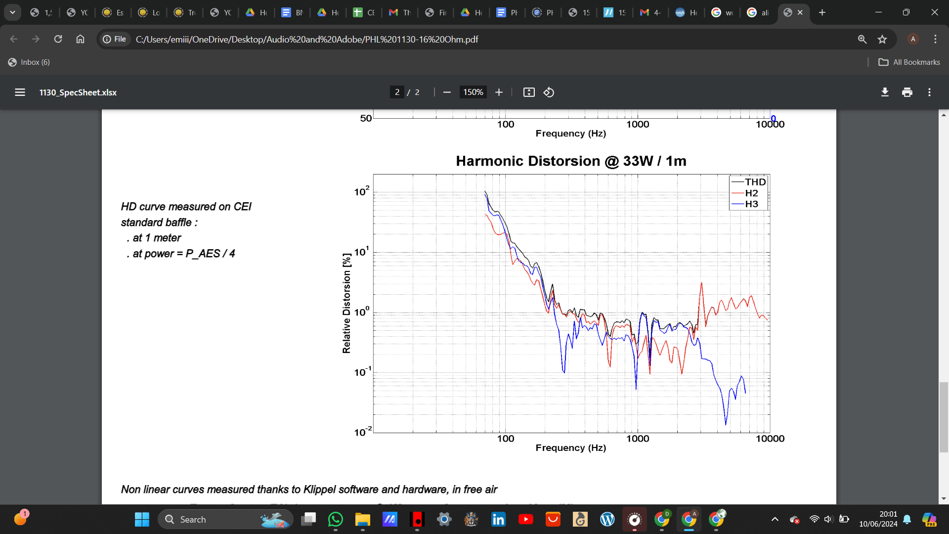

Look at the 3rd harmonic (blue) it never exceeds 1% with 33 watts... That = a pair of my arrays holding 120dB (!!) at 1 meter with 0.21 mm cone travel and only 25% of their AES continuous power rating.
Of course I have checked the usual recommendations like Faital 15PR400, not convinced it would make me happy forever...

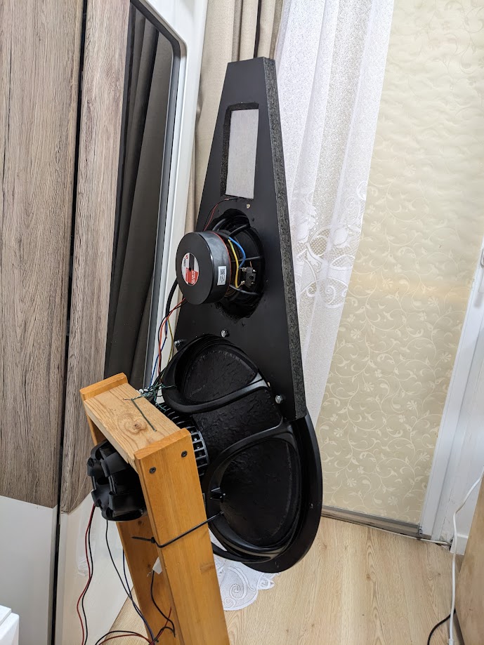

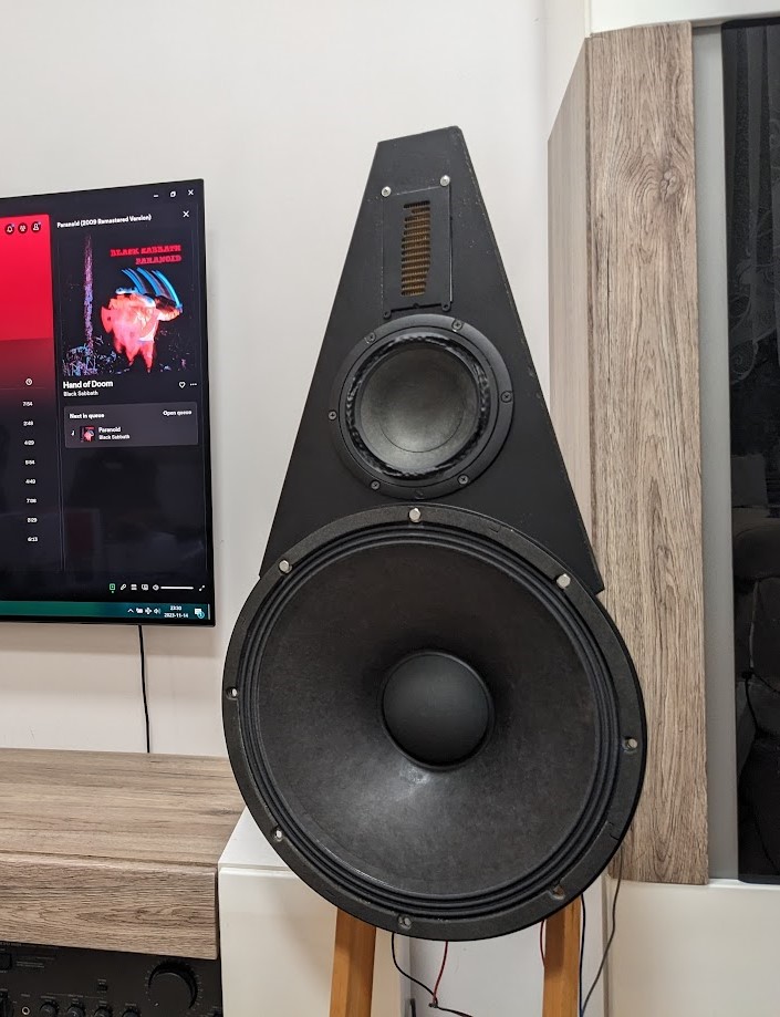

Hi.
Congratulations on choosing new speakers, optimized with 21st century CAD technology.
I'm keeping my ears happy with 15ntlw3500 totally differently than You plan to, but I can tell, that they move nicely air. I've made crude testboard half-baffle with only upper part for ptt6.5 and amt25d powered by Hypex Fusion 253.
They work like should not, moving air and not creating Room pressure difference, while playing bass mostly on-axis.
I have spotted 3 revisions of them, prior two having bit more glue at the coil-membrane connection and a just a bit slower impulse response (like nanoseconds visible on REW).
A year ago I have played them in 2-way up to 2kHz with Mundorf amt25d only, also were quite ok but the 1000-3000Hz range suffered from poor directivity control of Dipole naked AMT and 15". Mid-term solution today is to incorporate mid driver purifi ptt6.5, in my wet dreams mids run from radian lm10n (i'm on a hunt for good price, even used).

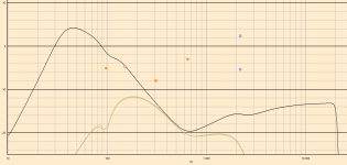

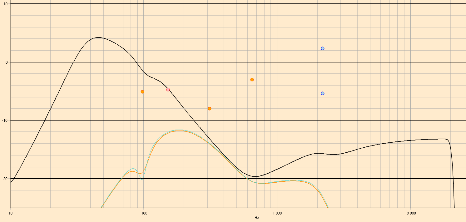

they simulate quite well in VituixCAD, You can even play with 2nd order at 100hz, followed with later 24db lowpass close to 1khz. Wonderful for my 2380a horns (i'm open to suggestion what CD to match with it)
Zero baffle is having this special very addicting bass, and for no extra money you get unknown to other loudspeakres feature - bass around the house is almost -10dB to the listening room and -20dB to what you have on axis. The only problem is when You want to have 30hz @80dB- i think it's not possible with them completely naked (or maybe i need 6 of them). I do have hypex mid channel set -9dB, which is later shelved also for 16dB starting @200hz. I think (not possible to be measured) i can achieve 40hz @80dB using almost all 250W of hypexes.
Only downside i can think of with those 18sound is linear xmax - according to sims they go above it below 40hz with 110dB (producer doesn't report Xdamage, but i haven't yet achieved with anything 110dB in my flat because i'm polite to neighbors).
In my plans soon after moving to new house next month i'd like to create new threads here. The plan is to create 3 or 4 types of solutions with them (I have 6 of these 15")
next project in line is HUUUGE box of 450 liter- new livingroom infinite baffle jawdropper camouflaged as tv wall.
after that i'll do sealed, bass reflex and always wanted to try some horn.
after exploring stnadard boxes i will keep myself busy with daisy chaining Hypexes to create DBA, w371 clones and other uncommon stuff.
now. let's try attaching images...

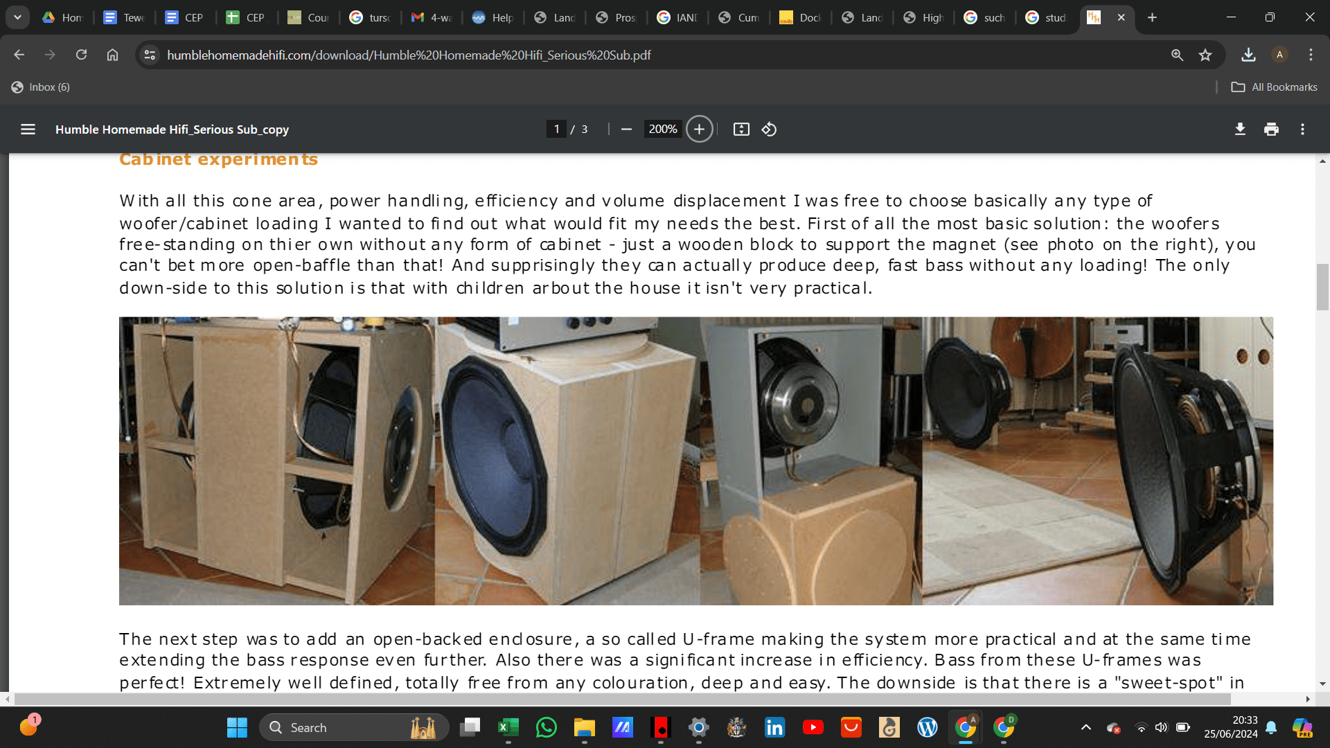

The zero baffle produces lovely bass.Zero baffle is having this special very addicting bass, and for no extra money you get unknown to other loudspeakres feature - bass around the house is almost -10dB to the listening room and -20dB to what you have on axis.
I saw this zero baffle in 2008 https://www.humblehomemadehifi.com/download/Humble Homemade Hifi_Serious Sub.pdf they use a pair 21 inch Precision Devices drivers, I couldn't afford them but bought a pair of 18 inch instead... Really great. He compares them No Baffle, H baffle, U baffle sealed and ported.... Very interesting article. I trust his advice as he is very good bass player as well as speaker designer.

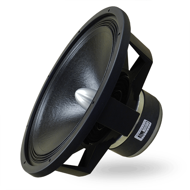

What about Acoustic Elegance TD18H+?
3 inch voicecoil and phaseplug gives as god off axis repsonse as many 15 inch
Extereme low inductance
Fs29 Hz
MMS 165 g but strong «motor»
From the website:
…..their ultra low inductance means they can play cleanly up into the midrange region like no other drivers. You will not find an 18″ driver that can compete with the midbass accuracy of the TD18H+.
https://aespeakers.com/shop/td/td18h/
