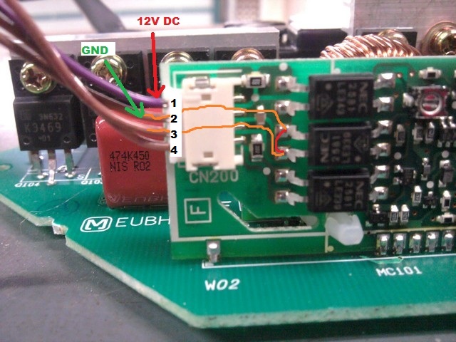

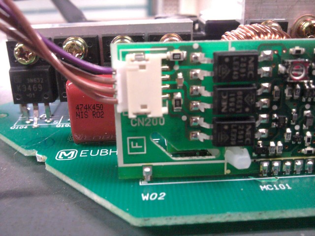

my 3M projector lamp is blown ...price is expensive... need help to byeballast.
i strip down whole projector to reach optocoupler...
there is four wire goes to main board
purple + 3 brown ( picture attached for your review )
based on your experience, want to pick up your memory ...can you suggest among of four wire which two suppose to shorted ???

hi,
i powered the PJ, disconnect from ballast side, and tried to measure the voltage (coming from main board) the purple (1) has 12V DC next (2) is ground.... what you suggested that is (2,3)
if i trace the opto legs it shows me wire number ( 2,3) if i short both
it might allow me to remove ballast complete from PJ...

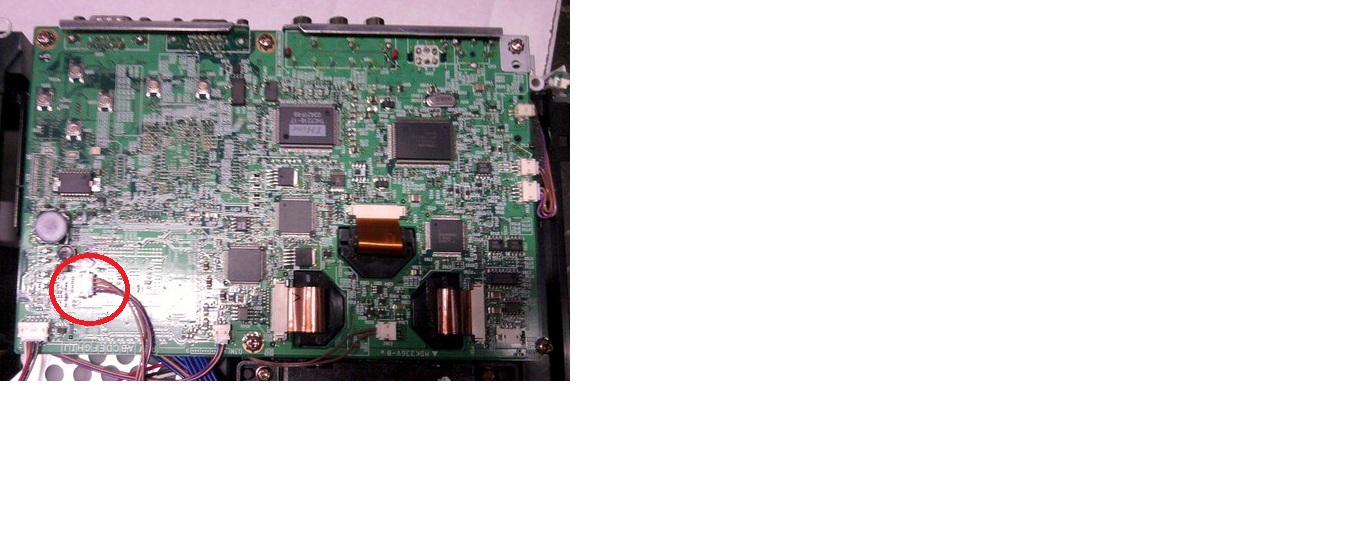

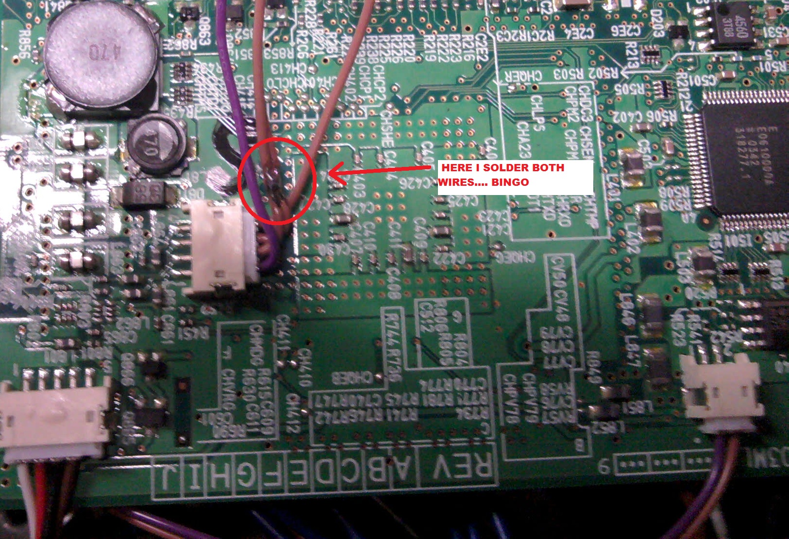

Thanks a lot to this forum specially !! bizylle42 !!
i short both wire on Mainboard side and remove completely ballast from PJ
now i have a little room for helogen or xenon psu....
thanks again !! bizylle42
i post the picture of moded mainboard ...for reference it might useful for anyone has same type OR same model
