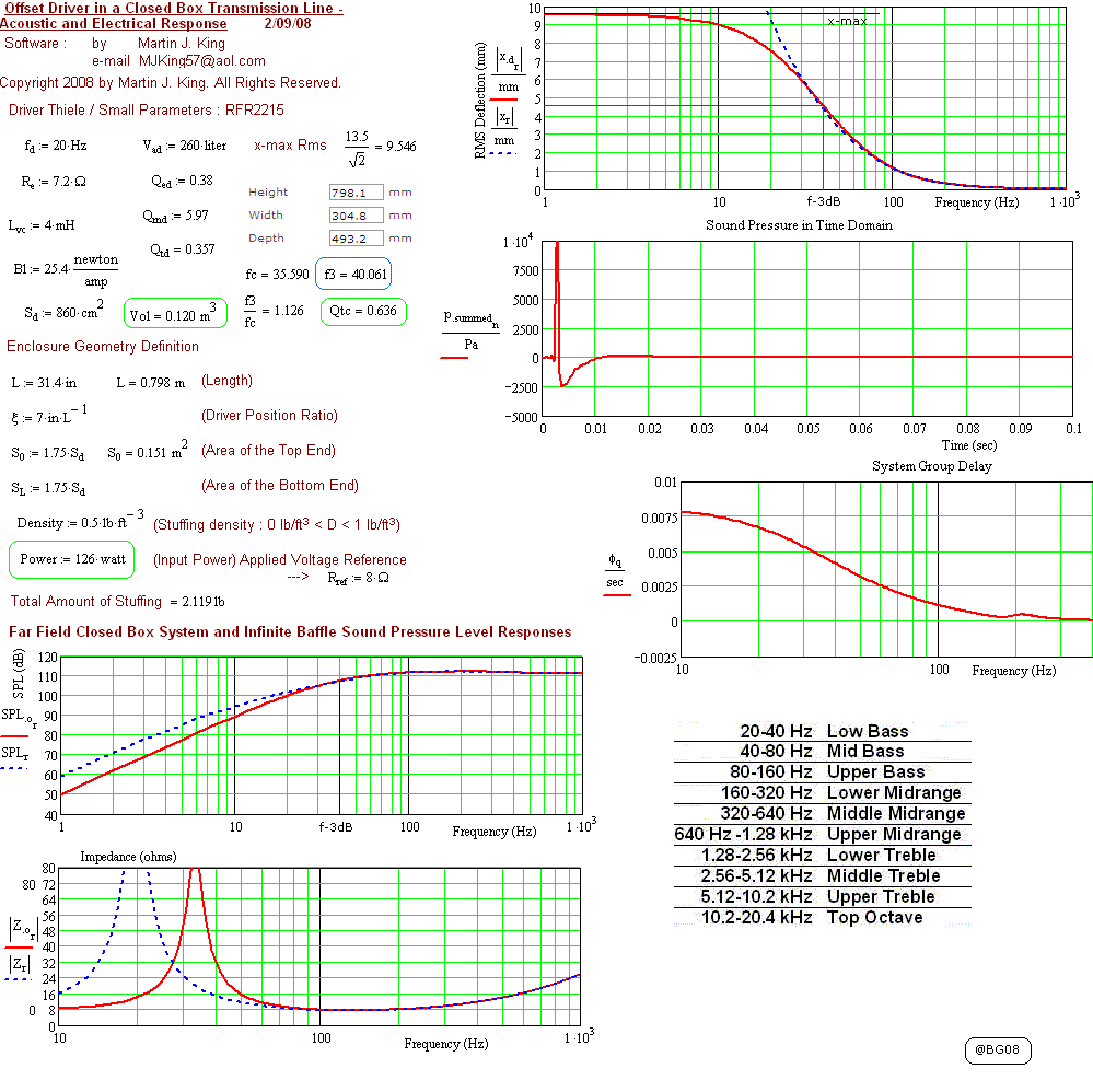

...i have no program suitable for simulating how much i can feed them before they reaches xmax...

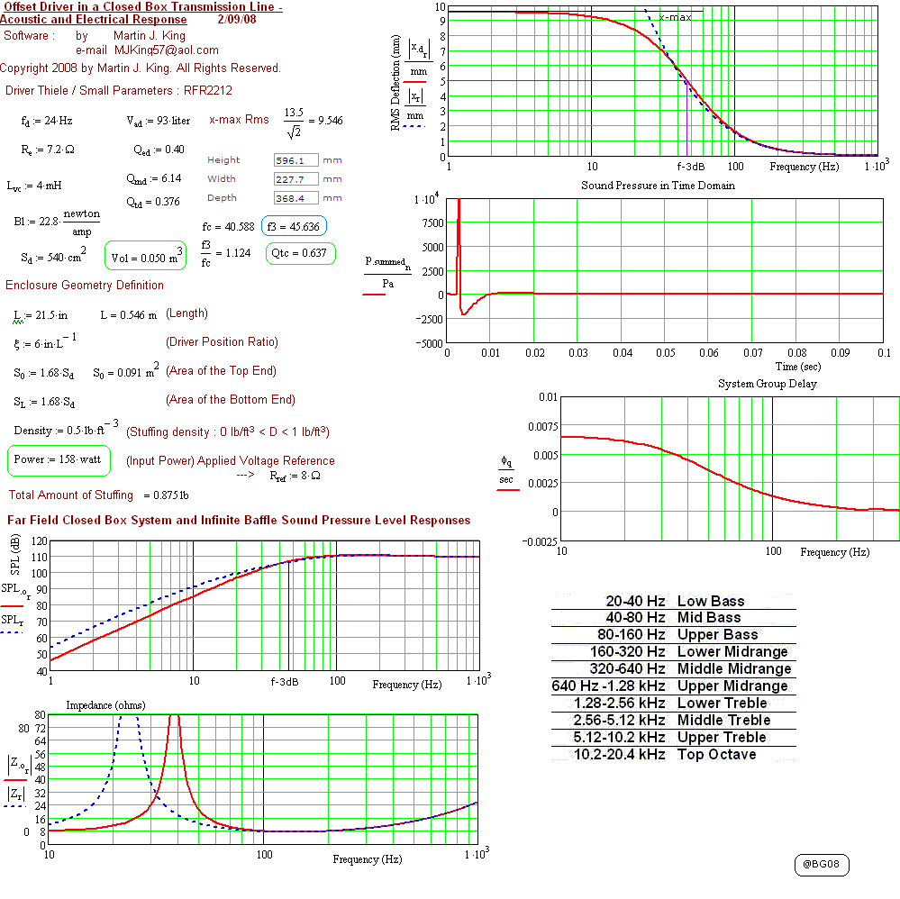

As expected, the 12 and 15” Rockford car drivers performs very similar when compared (See the plots 1(2)-2(2).) in the suggested boxes: 50L respective 120L, only covering the Mid-Bass octave (40-80 Hz) down to 40 Hz at most.
The Low-Bass octave (20-40Hz) would probably be possible in a car compartment and for this reason you ‘could’ call these drivers subs but not in a room where the Sub-Octave (10-20 Hz) would be 12 –24 dB down.
… without audible distortion…
When arbitrary drivers with typical no distortion data or Dumax report given, operating at x-max and beyond, audible noise/artefacts is often heard at much lower input powers than given advertised ‘highlighted’.
Power compression resulting from non-linearity is heard long before reaching x-max and not to forget the accompany driver distortion.
In case when unknown or car drivers stating exaggerate power capabilities are thrown in here to this forum, I chose to use a derated x-max*, that allows x-max to be reached at 1 Hz as a prerequisite, thus the input powers are also de-rated accordingly.
The 12” driver is then good for 158W Rms and the 15” 126W at max and the headroom power requirements for suitable amplifiers can be relaxed to more reasonable numbers.
*About 50% down from f-3dB counted for the 12” driver and the 15” too.
Somebody agree?

bjorno said:
Somebody agree?
Unless their quality has slipped in recent years, Rockford-Fosgate drivers are quite good and don't start compressing until above ~half power, so with a little room gain both these drivers should have no trouble in Vb = Vas cabs tuned down in the teens without exceeding Xmax or audibly compressing on 'only' 530 W, though if tuned to Fs or below a TQWT would be preferable due to the long vents required.
That said, there's still a lot of junk in car audio, so when in doubt it's indeed wise to use a conservative power and excursion rating for a HIFI or HT app with 1/4 power a good rule-of-thumb.

These drivers arent actually "recent" they are from 97-98 and are also refered to as the Punch Power DVC series.
They where the top models before RF released the Power HX2.
And even if i know that power ratings from caraudio manufacturers are seldom accurate, i do actually belive RF made some pretty rugged drivers when they came upp with these.
With a 4" voicecoil, 116 OZ magnet and a vent in the polepiece large enough to fit a beer can.
they should be able to handle some abuse.
The 12" have been used in my home for quite some time now, powered by 2x120Wrms each (one stereo amp per woofer) in 35L sealed boxes, and to me it seems like the amps are the limiting factor sofar (2 Technics SE-A900SM2).
One of the 15" drivers was used in my car for some years in a 71L sealed box, powered with a 500Wrms mono block (RF Power 500M) and also in this case i didnt find the limit of the driver
Ps the drivers seems to be able to handle some serious excursion in free air without making mechanical noise, like breathing or flapping
