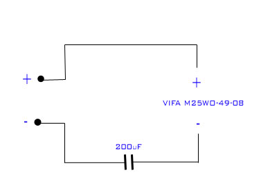

so is the modified diagram i posted correct,

Alex_B said:so is the modified diagram i posted correct,
Yes.
Have you considered a sharper filter-the 12dB/octave? Not that it is absolutely necessary.
By the way, what is the internal volume of the C17's you are crossing into? Vented or Seaed? It would help in determining the values of the resistor and cap in that little filter we are setting up before your receiver.
By the way, I never have used one of these pre-receiver crossover networks. I do anticipate using it in the future, but just figured I would let you know I'm not that experienced at this thing yet. I have designed filters using op-amps and transistors that I have used, though.
Anyway, if you used a program, do you know the F3 of the C17 enclosure?

so can i use the 2rca - 1 rca to mix L+R into mono? without any nasties? we seemed to miss that part

Alex_B said:so can i use the 2rca - 1 rca to mix L+R into mono? without any nasties? we seemed to miss that part
You should be able to get away with that.
If you find you are getting crosstalk between channels a resistor in series with the hot before you sum them is the cure, What value, i don't know off the top.

In my guitar tech days I made up a little summing box, that was connected with a 100n cap to block DC followed by a 100k resistor on each input, then the inputs were just connected together. This had a little signal drop with long guitar cables, so in a later model I just added a basic op amp buffer copied straight from a magazine and that worked great.
Alex_B said:ut i have included the L+R mix, should there be any resistors caps, between the input and start of the filter part? to stop "crosstalk" ? maybe?
you could marry pinkmouses circuit with yours just to be careful.
