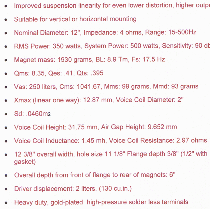

To clarify one point : the specs given are for an Eminence driver
to match a driver provided by ML, presumably ML sourcing spares.
The driver provided by ML ? was this also an Eminence ?
Are you sure that it is the driver fitted to your speakers ?
You can check whether it has double voice coil connections.
If it hasn't its likely "the driver provided by ML".

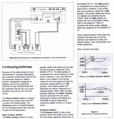

sreten, thanks for helping out so much, below is a copy from the ML manual about the switches.
Cheers George

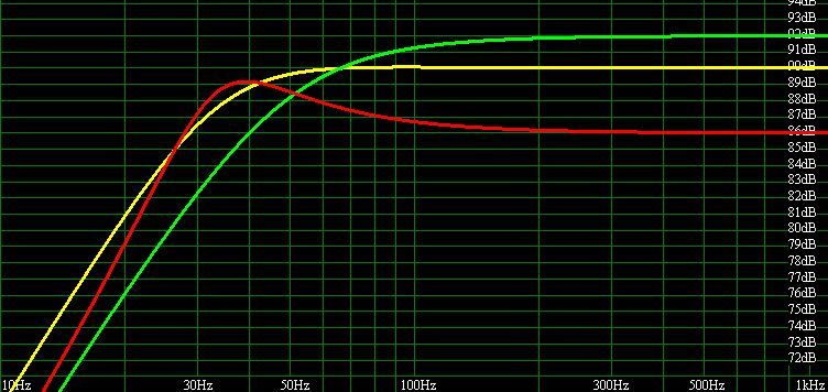

ignoring the c/o approximated below is what the laws of physics
say the switch does, levels around 50Hz will remain unchanged.
I'll check the effects of the new drivers Re and Le this evening.
🙂/sreten.

seems I set Fs for the Eminence incorrectly in the previous
Sim, someone should have wrapped my knuckles for this.
So green = eminence, yellow = SV12, red = SV12 + switch.
I'll model with crossover later but it looks like
the 90dB sensitivity will be fine in practise.
🙂/sreten.

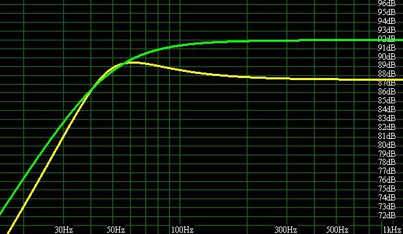

I thought I had a trial version of a tool that would
analyse this but alas it does not give sensible results.
Back to my trusty circuit simulator.
It indicates the bass driver is rolled before it hits nominal sensitivity.
That is the Eminence never gets over 87/88dB.
It indicates the AC12 rolloff will be slightly shallower due to
the extra Re and Le, and it never gets over 87/88dB as well.
So ML have not done the "impossible" and made a 92dB panel.
It seems that it all balances out quite well and you will end up
with substantially deeper bass although somewhat less damped.
