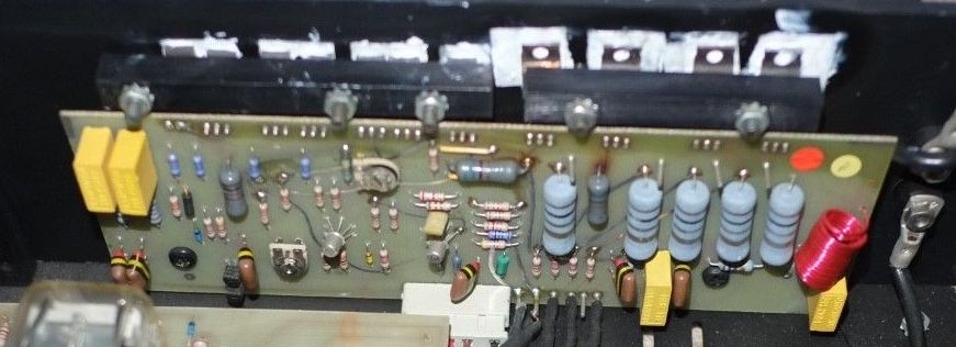

Hi Tony,
Ok just so I’ve got it, connect the DMM across both ends of those resistors?
So not using the a,b,c,d points on the photo?
Thanks for your time
Joe
Joe

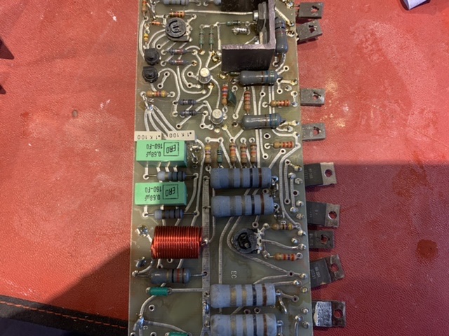

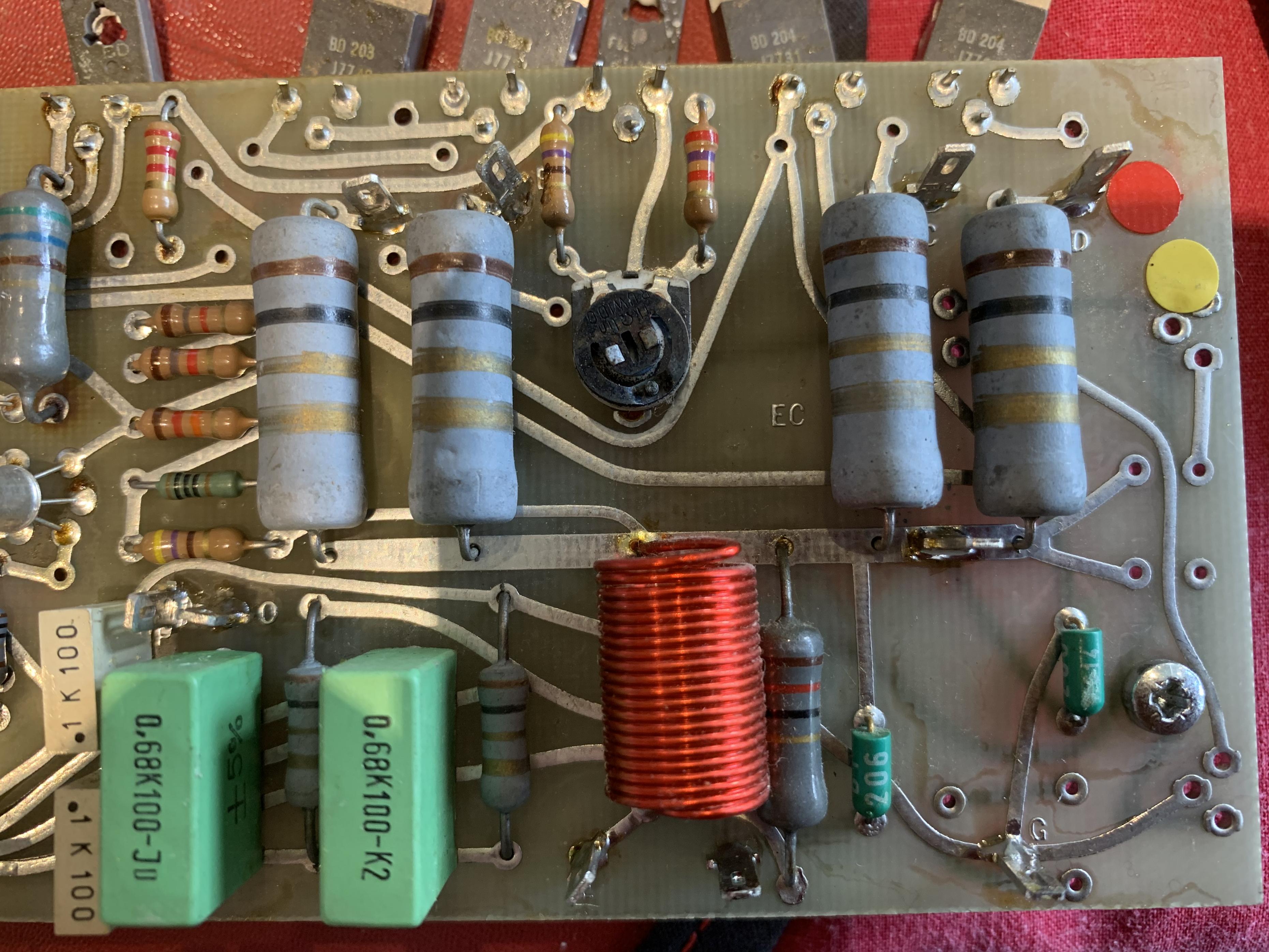

Hi Tony
Thanks for the reply,
I’ll get on that tomorrow and get back to you with the results as I’ve 1/2 the garage out in the drive at the moment 😊
Just to check the transitory along the top here’s my boards which are different to any published schematic.
Are they the same layout as yours?
Thanks again
Joe
Thanks again
Joe
