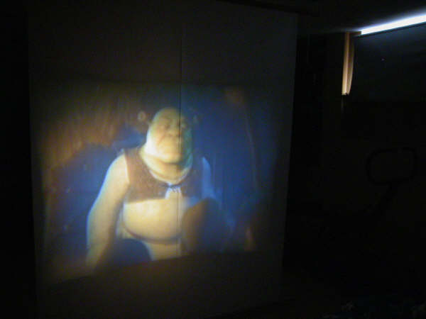

100" tv
HI,
not given up on the 100" tv thing, still going strong, and still redesigning the site at he mo, adding new plans at mo.... slowly... no changes online yet tho ( www.DIYprojectionTV.tk ) ad totally free when its sorted and stuff, but not at moment.
loads of new ideas and stuff at my msn group http://groups.msn.com/diyprojectiontv
still going strong!
as for the image from my projector, its nothing like a realy projector, but highly watchable, and sitll the best £5 ive ever spent.
Attached is an image submitted by a user of mine, to show his projector working as a rear-projector, so obviously the image is brighter if used as a front projector, and on a good screen.
But good i think for £5 and a card board box!
cheers for links, guess i will have to bite the bullet on those, but still got over 1000hrs left on it, and just waned to know really....
its the lens and fresnel id like to get sorted first, as they are stoping the image being perfect. (tho it is damn fine)
Liam
