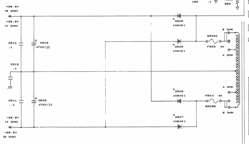

I'd love some help diagnosing a persistent hum issue in a NAD 7020E (amplifier section is nearly identical to the NAD 3020E and other 3020 variants).
The symptom:
Despite all of the above, I'm still getting the loud hum and seeing ~5.5 V AC ripple at 50 Hz.
Any ideas or suggestions welcome. Can attach photos if that will help.
Thanks in advance!
The symptom:
- Loud, constant hum through both speakers
- Present even with all inputs disconnected and volume at zero
- Hum is at 50 Hz (I'm in Australia)
- Ripple measured on power rails is ~5.5 V AC
- Both transformer output fuses (F503, F504) pass continuity
- ~34 V AC measured across F503 and F504 outputs
- ~17 V AC measured from each fuse output to chassis ground - transformer appears balanced
- ~5.5 V AC ripple (50 Hz) measured:
- F503 output to cathode of D505 (+V rail)
- F504 output to anode of D507 (-V rail)
- Replaced both main power filter caps (C508, C509)
- Upgraded from 4700 µF 35V to 4700 µF 50V
- Replaced all four bridge rectifier diodes (D505–D508)
- Upgraded from 1N5401 (100v) rated to 1N5408 (1000 V rated
Thanks in advance!

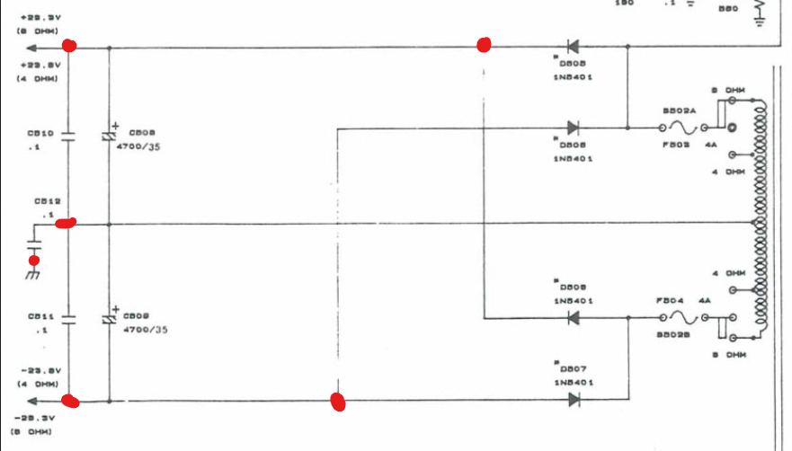

so did you buy this amp non-working, or has it "died" since you have owned it? Did it play fine and recently developed a "hum" ?
What have you tested so far? Did you diode check all the diodes in the PSU (shows at least 8 of them for the High and Low rails "power envelope") Has there been any previous repair attempts that you know of?

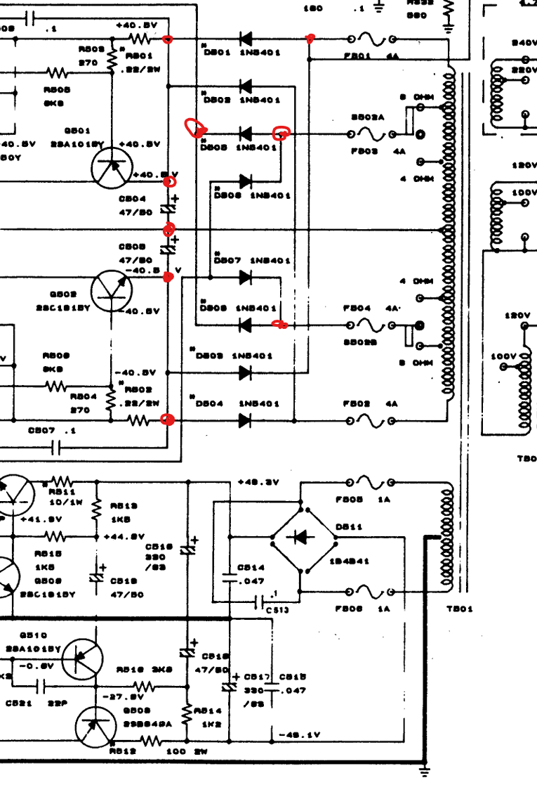

I would start with the red marked junction points and write down your voltages. Right side of Diodes will be AC, left side of diodes will be in DC. Because it's in both speakers, sounds like you're on the right trck with the PSU as teh culprit. I would check all diode/zener or capacitors as a guess, if you're gtting leakage all the way through the amplifier.

Pictures form multiple angles with good lighting would probably be best at this point.
also, check with your DMM at these locations for DC, using speaker ground for your black probe. Curious to see if you are getting the ~40Vdc and is it consistent through the PSU. If you can test the +/- rails at the amp boards, do that too. Again, you should see +/-40-42Vdc if the schematic is accurate.
