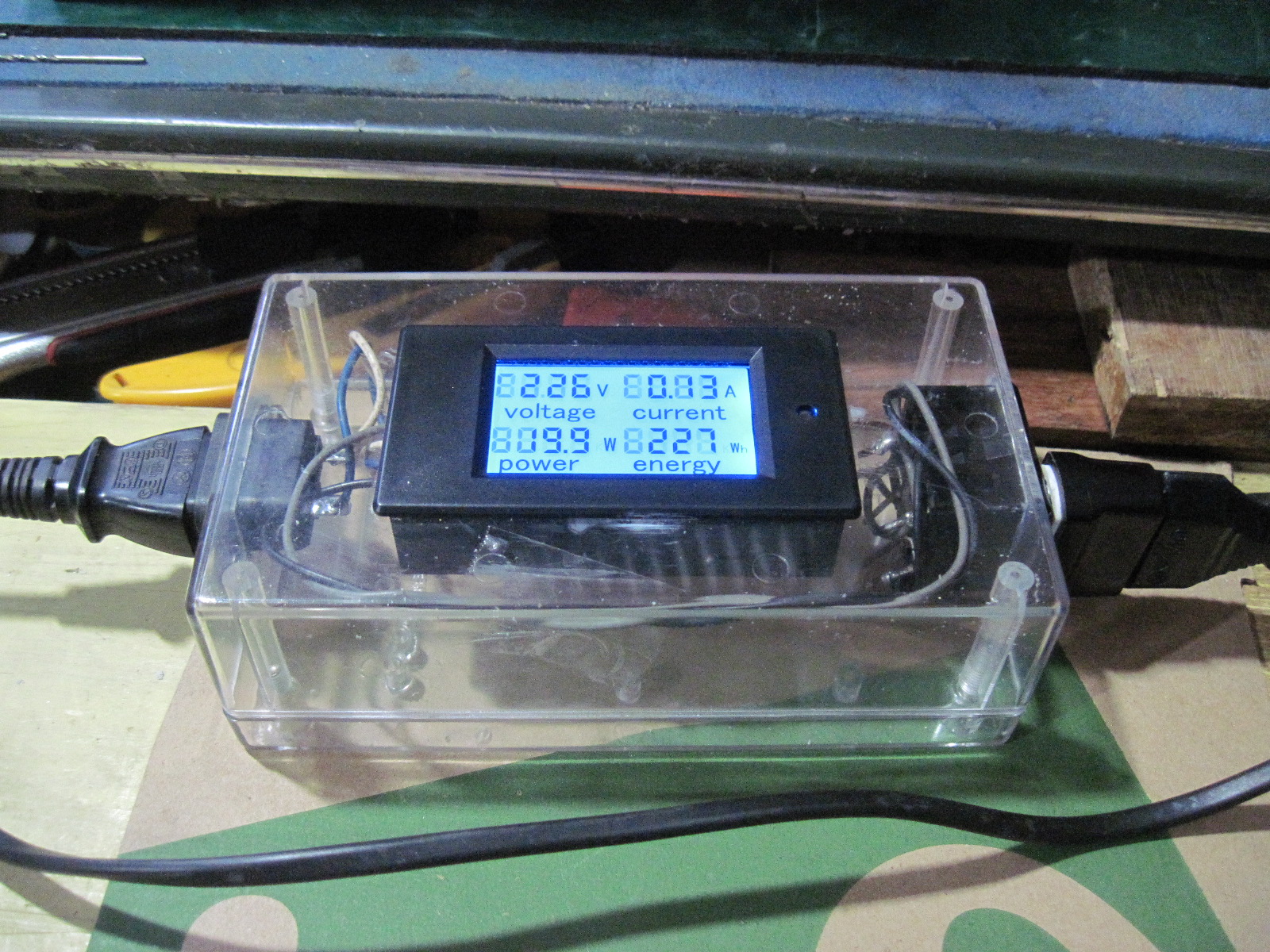

May I suggest to use a current limited supply during tests (For example, using a filament or incandescent lamp in series to the +B or line) at the amp to prevent rectifiers and trafo damaging?
Osvaldo's suggestion is a very good one. (Until you are ready to do the final bias and balance adjustments at which point you must use full mains.)

Yes, and also for prevent personal injury or damage.Osvaldo's suggestion is a very good one. (Until you are ready to do the final bias and balance adjustments at which point you must use full mains.)
I always use some form of current limiting. I have a box with a lamp of 100W, another for 200 and the third with 300W, and a switch to select one, tho (whichever combination) or the three in parallel (From 100 to 600W), all in series to the live wire in the bench. A completely different outlet color for the "seried" and the direct devices, so, no confusion may be.
i use this series lamp tester on solid state amps....
tubes can take abuse and you have time to unplug them...

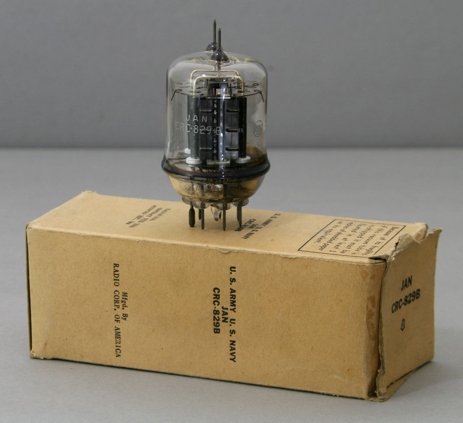

for tubes this is what i use:
red plating is the result of over dissipation in the plates,
lowering plate current and or plate voltage cures this...
this is your clue....the object then is to lower plate current
so that the plates do not turn red....
this is what you do with those pots....
having several of the 829b tubes you can select ones that do not red plate,
initially, you can set the grid bias pots to maximum negative voltage,
say -30 volts and the balance pot set to midpoint....
this is how i would do it in my amps...

when you use a series lamp tester, the current draw on the power traffo will make the lamp glow and the voltages on the amp itself will be lower, this is the reason i do not use them on tube amps....
except maybe if you use 200 watt of higher incandescent lamps, that will work...
Check, as AJT indicates a larger wattage lamp is required. Two 100W lamps in parallel with each other and in series with the amp will work and keep it from blowing up while you learn to make adjustments. Once you are comfortable you need to do the final adjustments with full mains.
I use lamps anytime I am repairing on or working on something I don't entirely trust. It has saved some expensive parts over the years.
yes, i will allow a 10 volt ac drop across the lamps,
anything higher and your voltages will be high when you
put the amp in service on normal mains...
