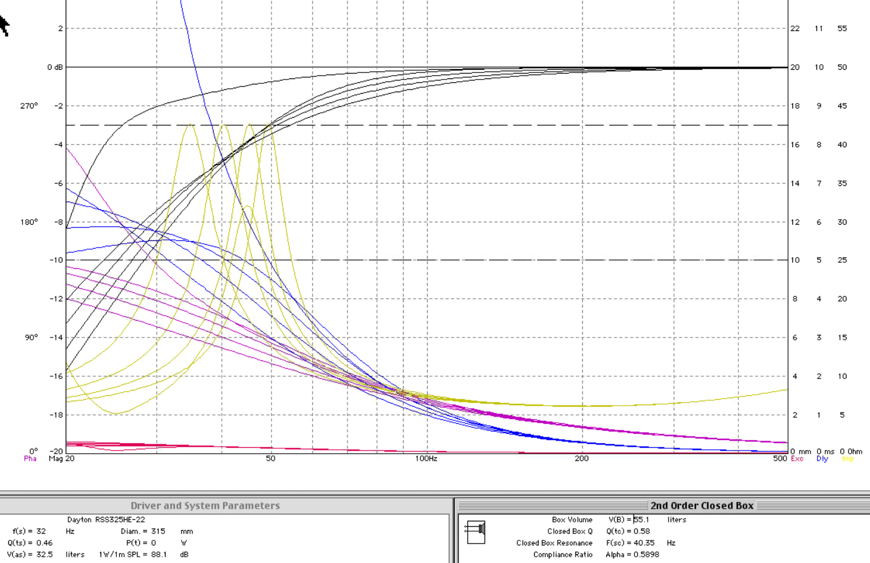

It looks like a very small sealed box, ~25L gives a Q= .7, but it reaches max displacement really quickly.
My biggest issue is that I don't know how to model a bass boost for a sealed system in hornresp.
I've tried playing with a ported box, and ~80-90L gives a good response, but the port ends up being very very long to reduce port velocity below 17m/s.

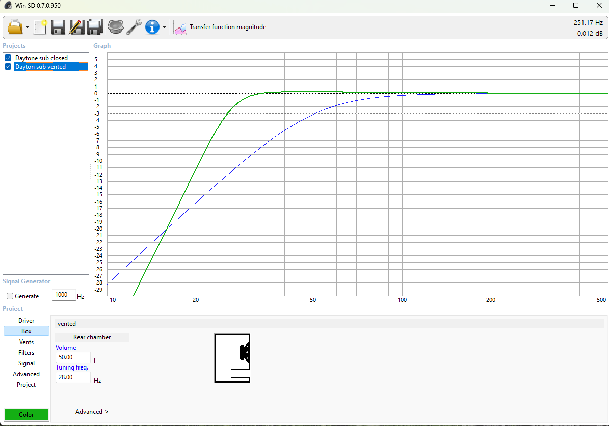

T/S max flat:
Vented net volume (Vb) (L) = 20*Vas*Qts'^3.3 = 50 L
Vented box tuning (Fb) (Hz) = 0.42*Fs*Qts'^-0.96 = ~28.3 Hz
F3 (Hz) = Fs*0.28*Qts^-1.4 = ~26.6 Hz
Yes, extremely long as in TL long with 2x Vb (100 L) dropping Fb = ~21 Hz, lowering vent mach and factoring in only needing ~120 W/105 dB/20 Hz/2 pi it still needs a 'critically damped' 5" i.d. dia. vent x 31.1"/79 cm long, ergo ideally needs a single 15" or dual 12" passive radiator(s).

Jeff, that seems a very reasonable vent size and frequency response. Especially when you add in some room gain around the 20hz mark.
How is the vent not stupidly long like I (and GM) found?
Are you able to see how much power it takes before xmax limit?

It will work in 25-50 itres sealed and get you into the mid 20s F10, a good measure of where it will go in room.
I prefer sealed + EQ for subwoofers (ideally you have at least 2).
A 50 litre vented alignment tuned a bit lower than GM suggests gives a more damped response. 25 Hz in the sim below.

Much too small as even the 5" needs fairly serious damping to get it down to ~20 m/s.
Ok, with a 5" dia. vent, predicted length is now out to ~34.4" . 😱
At that diameter, input power would be approx. 310 watts, in order to hold vent air velocity to 20m/s. Cone excursion at 310W would be ~22.5mm at 10hz, and ~16mm at 20hz.

Not according to HR in my #2 post.
edit: @ 310 W requires a 7" dia. x 136 cm/53.54", i.e. as I assumed, a TL length vent and after what has been posted since, really ought to make these a proper MLTL tuned down to where he wants/needs it.
