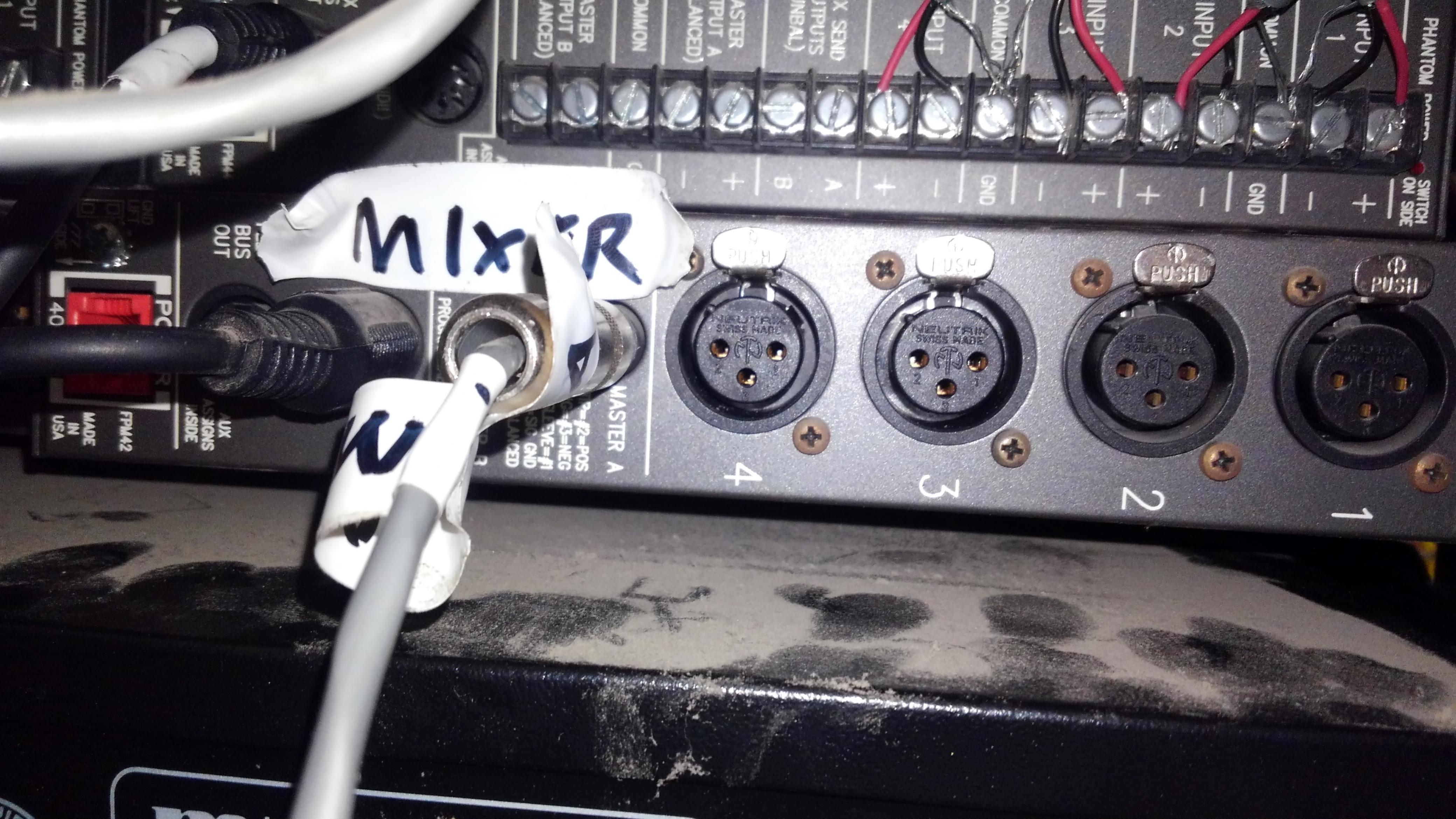

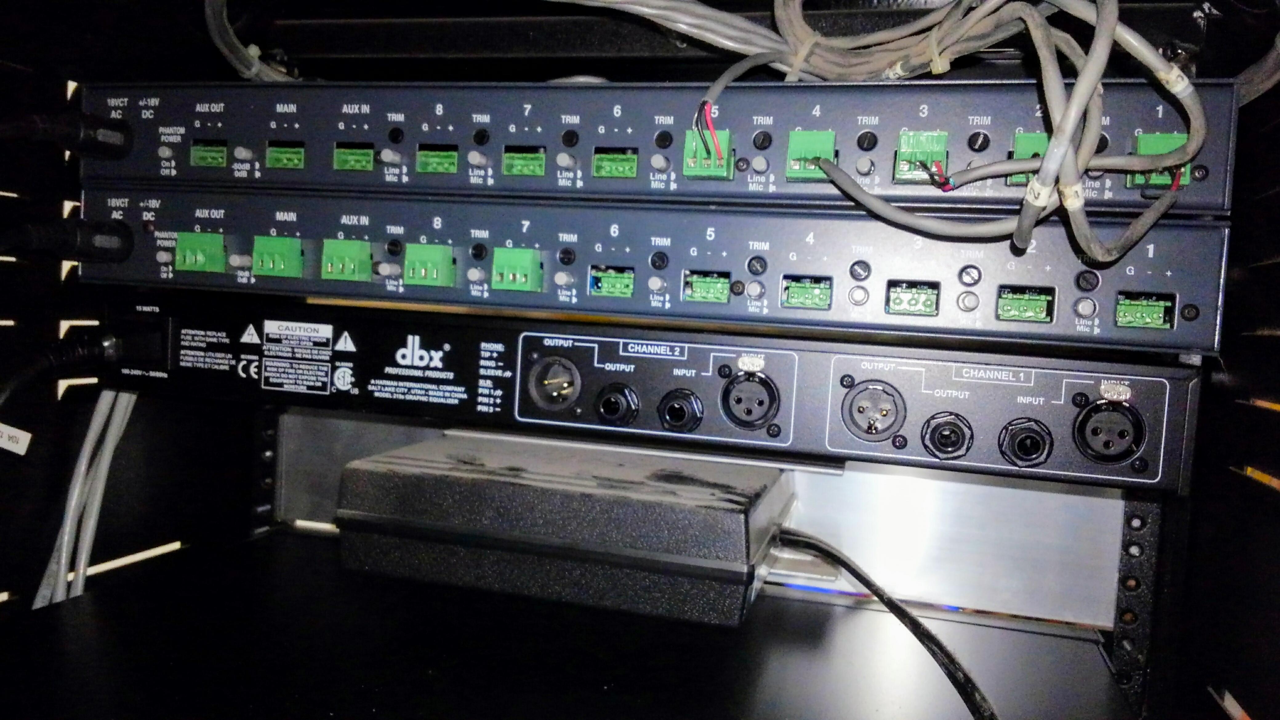

In the first picture you see to mixers cam8pro Bogen and a dbx equalizer. I'm trying to hook up the mixers to the equalizer and then to the amp.
In the second picture you will see the old mixers that I removed. The top mixer is for the mic inputs I'm not sure what the bottom mixer is for or what type of mixer it is.
Question number one what is the difference between these two mixers, question number 2 am I able to hook up these new mixers to the new equalizer or do I need new mixers.

If the input jack on the dbx has two bumps, you'll need a stereo 1/4 phone plug with a 3 wire cable. If it has one bump, you'll need a mono 1/4 phone plug with a 2 wire cable. The output of the mixer appears to be bare wire, called "main". I think the tip of the phone jack would usually be 3, but I could be wrong. Body of phone jack would be 2 for the two conductor one and 1 for the 3 conductor one, I believe. then 2 would be first ring.
