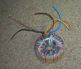

i have just turned on my first project, a powerfollower. the plastic around my 300va transformer has shrunl/melted and the insulation on the wires has melted, i have no idea what the problem - this is only happening to one channel😕

it is a power follower. the power supply is made up of just two bridge rectifiers - one for each secondairy, capacitors and a transformer
what should i connect the ohm meter between?
should the light bulb go before or after the transformer?
i will try the psu on it's own now.
pictures may come if you want them (it's a mess)

There is definately a short circuit for a load. If you are trying to get plus and minus power supplies, a single bridge rectifier will do fine. Do you have a fuse on the primary side? Are there fuses on the secondary side? This will tell you right away if there is a problem without damaging the transformer. Use slo-blo fuses when using inductive loading (i.e transformer primary).
maybe a short in the primary side of transformer...
it hapen to me in Kora Hibride...the transformer became very hot...but i have find that was two turns touching...i pull them apart put some vernish...and it riturns working properly...😉

What is the manufacturer and model of this transformer? Does it have a shield wire? It looks like it might but I cant tell. If so this should be attached to the star ground point. What are the wire color codes for your transformer? Typically orange and white are line neutral, black and brown are the line, there are some normal colors for the secondaries too but I will not speculate. If the two dot ends or the non-dot ends of the seconaries are connected, you are driving a short circuit. On the secondaries, a dot end and a no-dot end should be connected and become the common line to be attached to the star ground point. This may be what caused your problem. An idle transformer should dissipate little heat.

there is no ground wire/sheild wire
i think it is made by talema
there are red and black for one secondary and orange and yelow for the other.
After doing a little research, if indeed your manufacturer is Talema, then that means that it is made by Amveco. Their color code is found at amveco.com. The color code that your named sounds a little suspect. The smaller wires should be for the AC line and the larger wires are the secondaries.
The colour code is right actually. The transformer is from RS right?
Then blue/brown is mains
Black/red is one secondary
Yel/Orange is the other secondary
looks like one of the secondarys have been shorted (internally or externally) and has melted all of it's insulation.
safest thing to do is to replace the transformer
BEANZ : don't forget mains colour coding is diffrent in UK then US

I live in australia where we also use the brown/blue colour convention however i feel that BeanZ may be correct in this as the smaller diameter wires should be for the primary while the heavier wires should all be for the secondaries.
