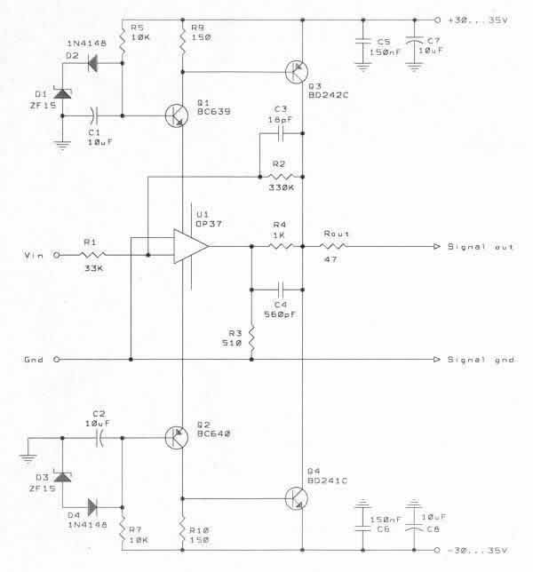

help me with this opamp pre-amp
I am planning to build this, opamp will be opa627, but I would like to have an non-inverted configuration and class a pre-amp.
Can I just change the R1 R2 to non inverted configuration ??
Hmmm .. have to think about this one.
To change to non-inverting wouldn't be difficult.
I leave this to someone else to post solution.
A couple of questions, that may help anyone posting reply:
1. You use very high power supply, 2x30-35 Volt, for being a preamp.
Why? You need very high voltage output?
Gain is x10.
2. I have myself used TO-220 lowprice BD241C/BD242C transistors.
They will work. But really, they are not for very good audio.
Can you think to use any other TO-220 transistors?
For example MJE15030/MJE15031 would be a considerable improvement.
They would much better match OP37 quality.
OP37 is a very good Audio Op-Amp :)
Regards, Lineup
I'm guessing ground Vin, put 1M or so in the other input line so it has a ground reference, then drive the other input. This is a variation on an old circuit. It uses the current draw of a heavily loaded op-amp to run the output stage. Though it could give good performance in its day, using few parts, I doubt it's a desirable way to build an audio circuit.

I am using opa627 non-inverting 10X to drive Nelson's F4 amp at the moment, but not enough voltage swing to drive to it's full output. Looking for some easy way to drive it before I decided which tube preamp to build.

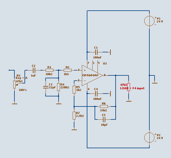

Yes, opa2604 is my first opamp to begin with, it does drive the amp to full swing at +-24v. But i replaced it with 2X opa627 and big difference in sound quality.
Yes.
It works at very high volt output, into 47 kohm.
If I am to believe one spice simulation I did with attached circuit,
the problems begin at ~ 21.5 Volt peak output.
For +- 24 V supply and a 47 kohm load. = F4 input.
This means OPA604 has got something like 2.5-3.0 Volt drop.
It corresponds well with the datasheet diagrams.
For +- 15 Volt, there is max +-12 Volt output swing. = 3 Volt drop.
As you can see, I have set the gain of my OPA604 circuit to like x15.
This gives max output at around 1 Volt RMS input.
I also added a 47 kohm Volume potentiometer at the input
and 1k gate resistors for the OPA604 input pins. (It wont hurt!!)
This circuit shows almost 'no distortion' below 20 Volt output.
Less than 0.001%.
I would think for a real circuit,
this preamp will NOT be the weak LINK in your audio system.
... knowing even very expensive high end speakers have
THD at the 0.500% level ..... at only 1 Watt RMS into 8 Ohm!!!
:D :D
