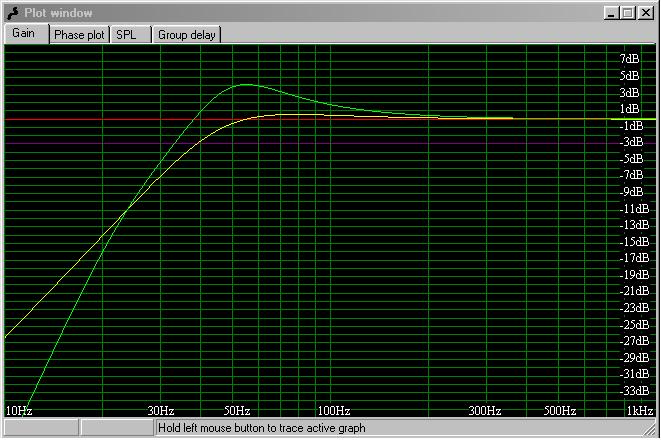

If you haven't built any/many enclosures before you may want to start with a sealed one. There is very little you can do wrong that way (provided it IS actually sealed🙂). Car subs generally rely heavily on the vehicles transfer function to boost the real low frequencies anyways and if you have a small car you can usually get away with a fairly small sealed box and still get nice low extension. If you're looking for nice smooth response go sealed. If you need a little more kick you could consider a ported box. But I'd just go with as big of a sealed box as you're comfortable putting in your car up to the recommended 1.7 cu ft.
As far as measurements of the box itself you'll have to post some more info regarding maximum dimensions where you'd like to put it in your car. i.e. if in a sedan you may have 38" between the shock towers and 14" in height. From that we could determine how deep the box needs to be to get your desired volume.

This is a real quick and dirty comparison. I suggest you download WinISDBeta to play around some more with it. But basically I simulated a 1.7 cu ft sealed and ported enclosure (tuned to 36 Hz). The yellow curve is sealed, green is ported. As you can see you're -3dB @ 40Hz sealed and -3dB @ ~33Hz ported. The main advantage (or dis if you don't like it boomy) to the ported box is the large gain centered around 55 Hz. Personally I prefer the sealed response but to each his own. If you listen to lots or rock/rap you may want to tune the ported box even higher. WinISD isn't perfect but it'll put you in the ballpark as far as box size, port diameter/length and roughly what you can expect from the box. But keep in mind that the low end will be boosted lots when in the vehicle so you don't need it to be ruler flat. A nice steady drop off is desireable generally.
