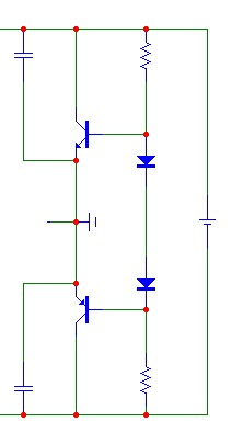

Ground channel amplifier 🙂 (gain =1) is very good idea in spilt battery system (+,GND,-). The Most advance is 50%/50% supply split in all battery capacity/charge conditions. So the DC-offset do not vary during batteries are run out. It is must in DC-coupled headphone output. Remembe headphones do not like DC current 🙁

So is this and a lot less complex than a complete amplifier.
MaKari said:Ground channel amplifier 🙂 (gain =1) is very good idea in spilt battery system (+,GND,-). The Most advance is 50%/50% supply split in all battery capacity/charge conditions. So the DC-offset do not vary during batteries are run out. It is must in DC-coupled headphone output. Remembe headphones do not like DC current 🙁

This looks interesting, I'm going to try it in the only 2 ch amp I have. When I converted it from active to passive ground, the soundstage got less precise, and it sounds more distorted in all. But this is a very messy prototype amp (the JISBOS-buffer amp mentioned above). Now I use center battery point as virtual ground and two rather small electrolytics from rails to ground.Nico Ras said:
