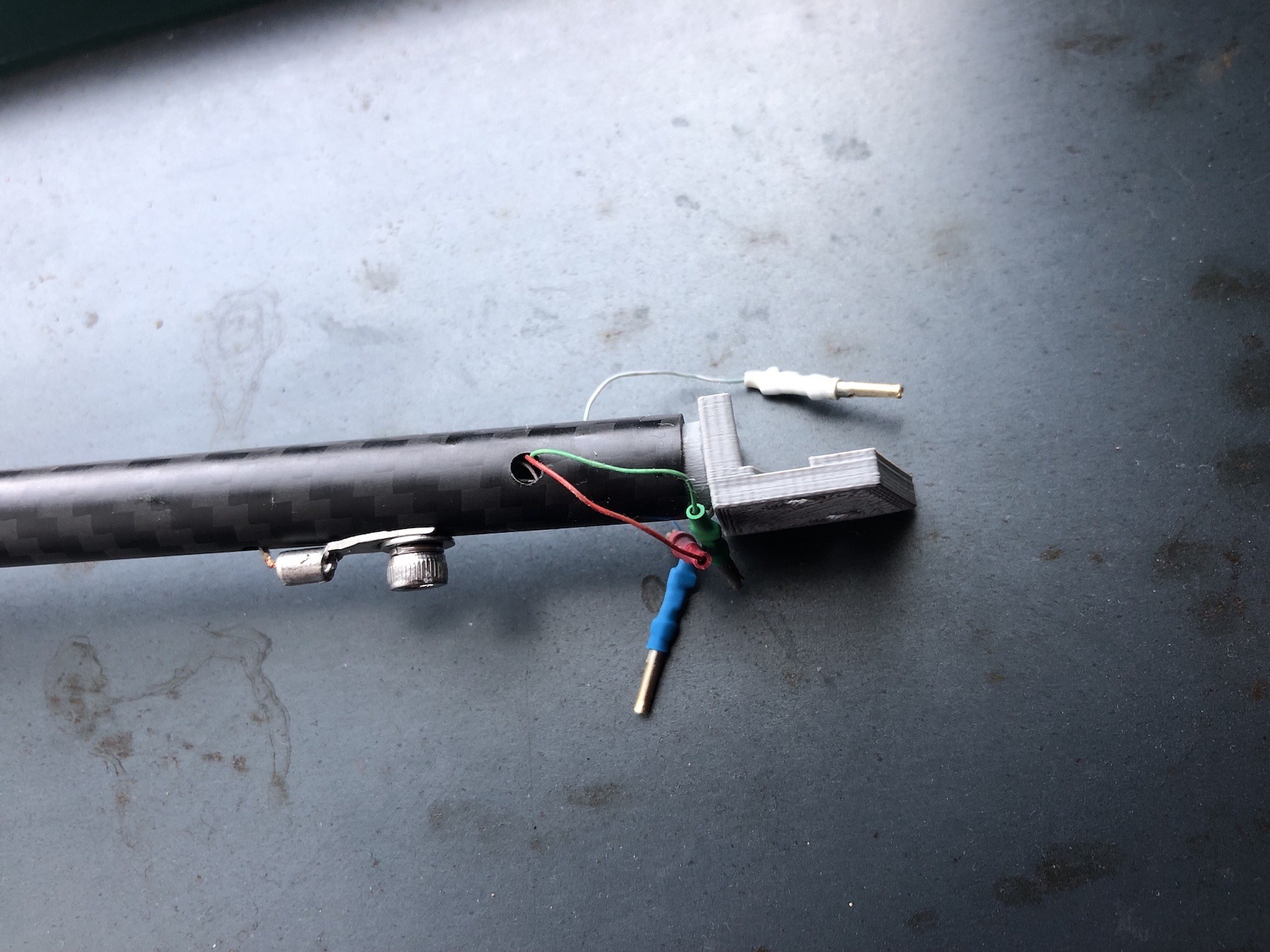

I added a M3 bolt running through the carbon fiber and securing into the brass tube. from that bolt there's a small spade where the ground wire connects from the PIB and arm. Also connected to that spade is a second ground wire that is soldered to the tinned copper mesh that the wires travel through inside the arm's brass tube. The carbon tube has been sanded where the bolt and spade connect to it. I thought this would be enough, but I'm still getting a ground hum.
Thoughts?
Hi,Hum with all arms... hum with motors off. No hum with my 1980's Well Tempered Turntable and Lary Pederson carbon fiber arm. In response to another post above, I just checked with the meter and the carbon fiber tube I use is conductive on its inner surface, not outer, so it likely IS coated. I will drill thru both the outer carbon tube and inner brass tube and put in a M3 x 6mm small bolt to anchor a ground wire. Perhaps that will do it.
Sounds like the problem is more in the side of the TT and not in the TA. Any transformer near the TA or TAs wires? However I would try changing the material of the TA to see if hum still there. If it is might not be the carbon fibre wand. However I never used carbon fibre for my diy TAs, I like bamboo wand more.
Hope you get a solution soon.
Rgds
Adelmo

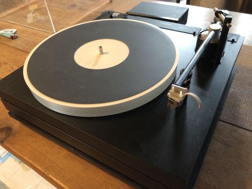

Even with the inexpensive Ortofon 2M Red moving magnet, this arm really performs. I use carbon fiber and mostly 3d printing because I don't have access to lathes or decent wood working. Oddly, we both just heard the DC motor warble on this highly modded WT Simplex table... not related to ground but certainly another issue to figure out.

The Cardas wires came twisted in pairs. Lary Pederson didn't twist both pairs together with his carbon arm, which I've emulated - each pair can be pulled individually forward or back. I'll make another arm and twist all together. I'm not absolutely sure how he grounded.
As it happens, the DC motor began warbling yesterday. I found an option recommended by an Amadeus owner and hope to tackle that soon as well. I'll do as you've suggested.
You can leave them in twisted pairs, just twist the two pairs together. The idea is to keep the ground wires as close together as possible, ie minimize the loop.
Here's the WT Simplex. I bought the plinth with no arm, platter, spindle - only the plinth, motor and the bearing. The distributor wouldn't sell me the platter with its attached spindle, so I used older Well Tempered parts and made a deeper base to accommodate the deeper bearing and spindle. I still have to possibly get a new motor and raise it 1/4" to be able to play 45rpm LP's. 3d printed many of the parts.

No phone base + wifi, bluetooth, yes - 15 feet away from the rack. On early attempts, I knew little about grounding. Know a bit more now obviously still not enough. I've incorporated a brass tube inside the carbon fiber tube and drilled through both to mount spade that has the ground coming from the PIB box, connecting tot he space with another wire going back into he arm and soldering to the tinned copper mesh that the signal wire travel through. The 4 signal wires are Cardas and came twisted in pairs. This last time, I kept the 2 pairs separate but in the same woven mesh. Would it be advisable to have the ground wire wrapped around the signal wires in the mesh, even with the ground soldered to the mesh? I haven't wrapped the wires too tightly out of the arm to the PIB. head shell is PLA plastic. The arm I'm emulating has a metal head shell. I'll try again and wrap the twisted pairs and ground more tightly as they exit the arm. Need to get a clog out of my 3d printer at present...

You need to find if its electrical or magnetic.
Does it hum with psu unplugged and arm over platter, nothing spinning? If so it could be a gnd loop between source and phonostage. Super unlikely, but must be ruled out.
1.Take the belt off, unplug motor psu, spin the platter, hang arm over platter. Does it hum, if so it's magnetic. Eddy currents from platter. If not the platter is good.
2.Now put the belt back and do it again. Does it hum now, if so it's either eddy current or radiation from motor. If it's louder than in the previous case then it's magnetic, motor and platter.
3.Plug it in turn it on But dont play. Is it louder than before, if so it's the motor, electrical field or magnetic. If this is the only case that's noisy then it's just motor electrical noise.
4.Now play and hang the arm over the platter, is it louder than before?
Each requires a different fix. Which we can discuss, once you have results for every case.

Getting over a surprise COVID infection... I'll get back on the tonearm and table tomorrow and run through the suggestions. Motor is mounted on the other side of the platter. The last time I worked with it, the arm hummed when plugged into the phono stage and preamplifier whether resting on the arm rest or playing on vinyl. I put a few drops of Wire Glue on the inside inner bolt that runs thru both the Carbon fiber and Brass rods, in the event the connection of ground on the bolt was not sufficiently meeting the brass rod.

This may have been answered, but is there a metal shielding tube carrying the wires inside the carbon tube? Is that metal tube grounded?
