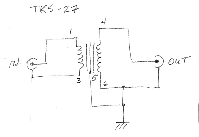

I'm not comfortable with the grounding, etc. of MC step up trannies for phono cartridges.
I've attached a little schematic of the SUT in question. They're mounted in an ugly little electrical enclosure, steel chassis. The box has a pair of RCA jacks for input. The input jacks are floating from the chassis. I will be hardwiring the outputs to the interconnect cable, coming straight from the enclosure.
I want to wire up the SUT with single-ended input, using the 300 ohm primary (lugs 1 and 3). Secondary lugs are 4 and 6, 100k ohms. Secondary will also be single-ended.
My dumb questions:
- For unbalanced input, should lug 3 be grounded? If yes, where? Directly to the chassis? Or should the single-ended input float, leaving only the ground wire from the turntable grounded to the chassis?
- Lug 5 is a shield for the secondary. I'm assuming it should be grounded to the chassis?
- For unbalanced output, should lugs 5 and 6 be shorted and grounded? Lug 4 would then be the output signal 'hot', 5+6 would be output ground?
I think that's it. Any help would be greatly appreciated.

According to this schematic...
...if I'm reading it correctly, for the primary, I would ground the input shield and lug 3 (0 ohms), and the input 'hot' would be lug 1 (300 ohms).
I would leave the secondary floating by grounding lug 5, while lug 4 would be signal 'hot' and lug 6 would be signal 'shield' (not grounded until the RIAA preamp).

Don't ground the primary. And if you can convert the cartridge-to-transformer wiring to balanced with a shield, that's even better (ground the shield). Secondary grounds from pin 6.
Thanks SY. I think this is what you meant (single-ended input, drawing attached). Did I get it right?
Yep!
If you use twisted wires for cartridge hot and cold, connect to the primary, and then ground the shield, you'll have an even better interface.

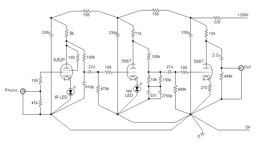

I think I might change my RIAA preamp's output stage to a cathode follower using a 6DJ8, instead of the common cathode 5687 it is now. That should give me a more 'standard' 40dB of total gain from the preamp. I didn't like it that the subjective level from my records was a couple of ticks lower than from the CD player, but I guess that's a small price to pay for being able to use the SUT in the system.
Is this your design or a published circuit?

My preamp is a variation on the Arthur Loesch circuit published in a Sound Practices article from many years ago. SY and others helped me get it right, in this thread, starting here: http://www.diyaudio.com/forums/tubes-valves/147717-cathode-bias-questions-3.html#post1886286. The final schematic happened way after that, which I've attached. I call it the "Gutbucket" because it's in a really ugly steel chassis. I took a lot of suggestions from that thread, wound up with LED bias for the first two stages.
