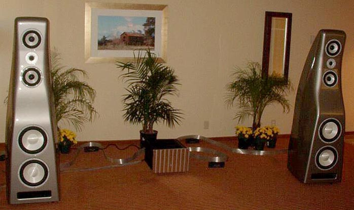

Well, the easy way is to use a wide BW point source [cone] woofer and HF compression horn speaker like the pioneers of audio arrived at.
http://crev.vo.llnwd.net/o42/audioreview/images/products/product_121090.jpg
A more complex, but superior, way is to create a two or way horn like Danley Sound Labs' SH50 Synergy horn and add a separate sub system.
