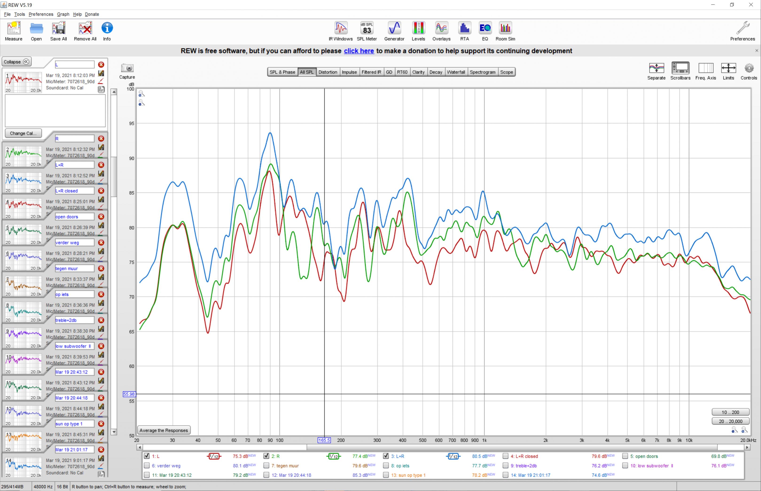

And now the measurements.

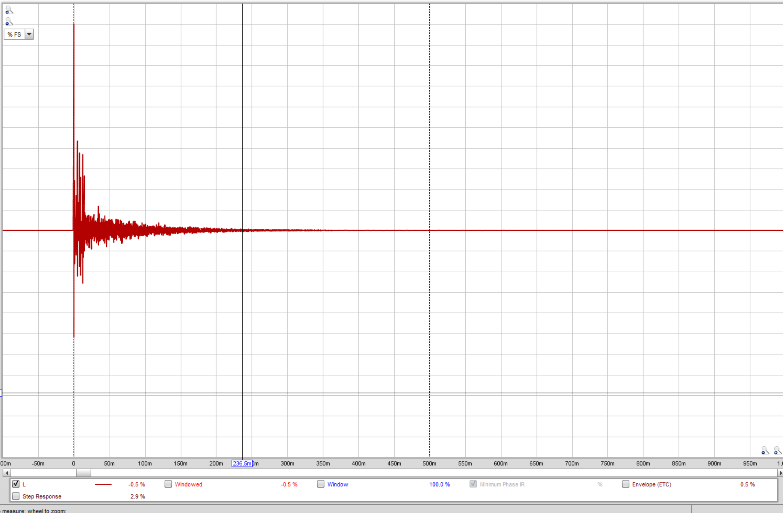

I have taken a lot of measurements with UMIK-1 and REW. All the measuremnts are smoothed to 1/12. I tried to correct for gated measurements, But the impluse ilooks different to the one showd on the doucmentation of UMIK. I cannot recognise the first reflection point to correct for. I have also included the Impulse as attachment.
L = RED, R = Green and LR = Blue.

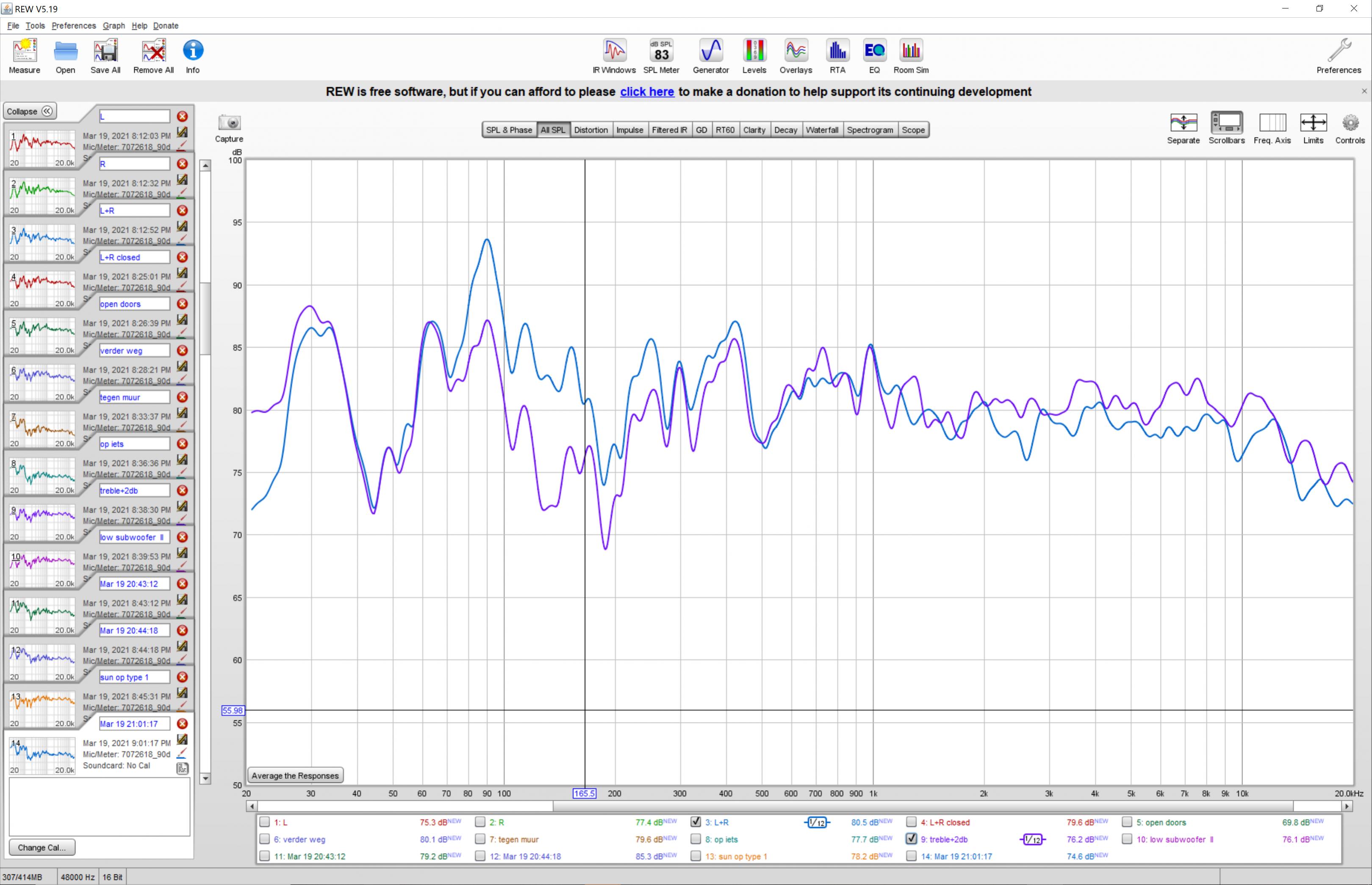

The "changed DSP" mesurement, I tried to boost the treble and lower the bass.

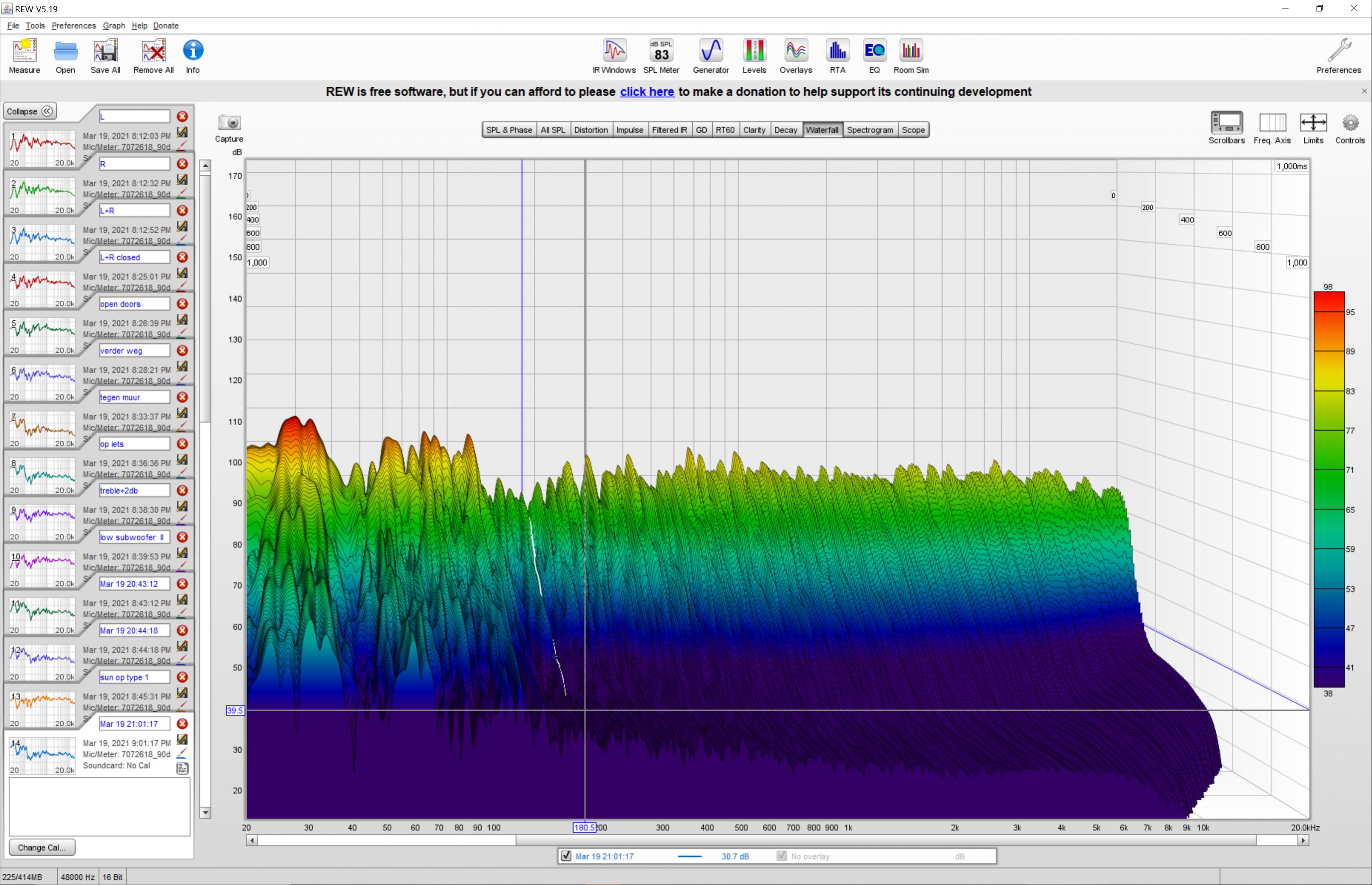

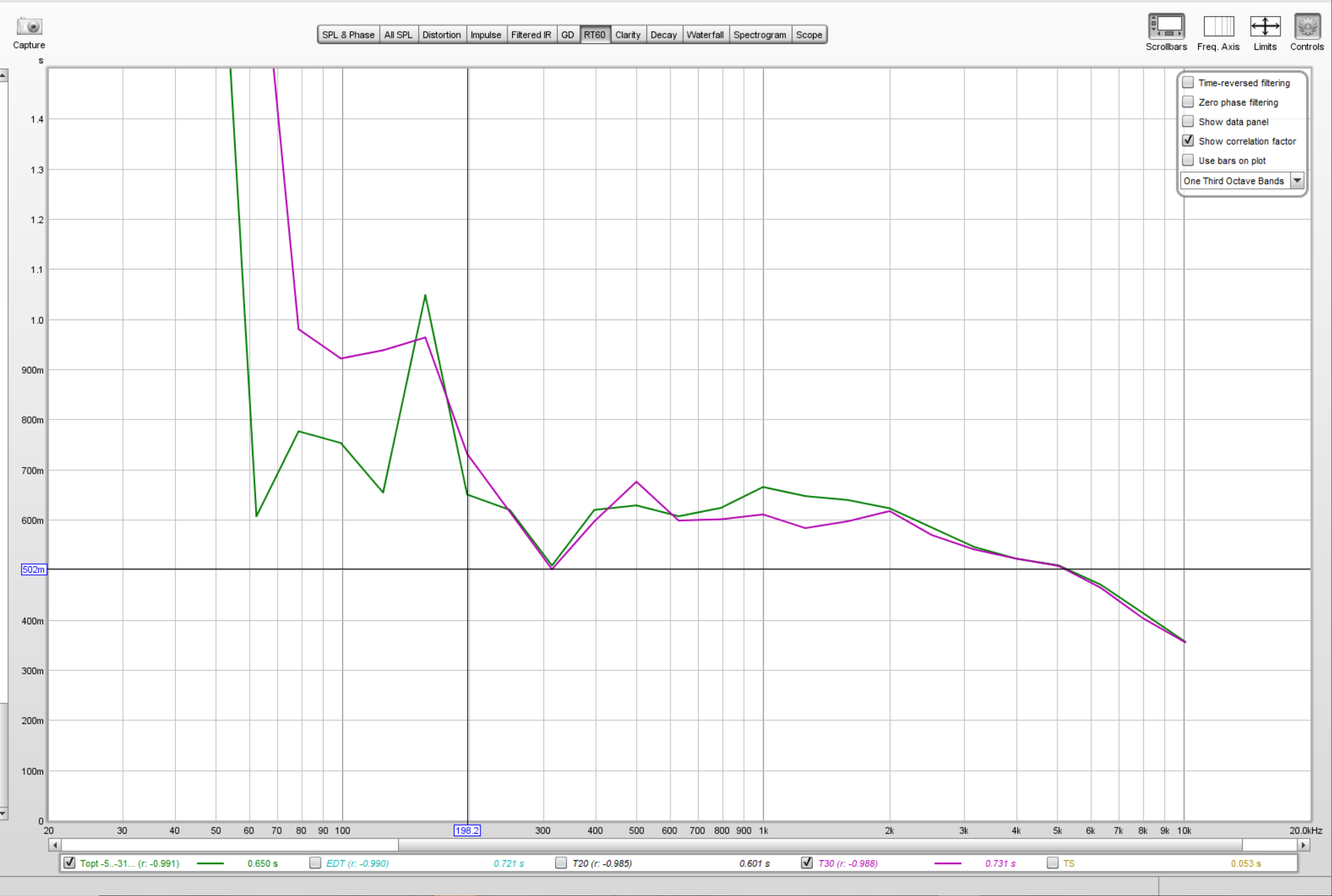

The RT30 and waterfall should have values lesser than 500ms, but I see a lot of reflections here. Should this be the main problem to fix first? Which wall to start with? The glass of the back wall?

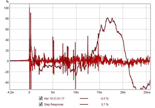

For starters, go to the Impulse tab, and zoom in on the ~ first 20 ms. That will show you where the first reflections come in. To do that click on the Limits button on the right top of the screen and set 'Left s' to something like -0,010 and 'Right s' to 0,020. Set the top to something like 120% and bottom to -60% and press "Apply Settings".
That should give you a clearer look at the impulse and the first reflections.

When I look at the example on the website of MINIDSP. Even If I zoom in, I cannot get something similar to the example. This is what I'm trying to do: Loudspeaker measurements
I have added the measurement as an attachment. Can you please see if you can get the gating window correctly?

Let me guess, this was with both speakers playing, right? At least the double peak seems to indicate that. Try to measure the speakers one by one.
So first the left speaker, then the right speaker.
Right now we seem to be looking at both speakers at once, which doesn't make it clear what is what.

Which would look best if you measure it in the exact sweet spot. Both spikes you see close together in my plot, should form one spike if the measurement microphone is equal distance to both speakers. A little movement goes a long way. But first let's see the left speaker and right speaker separately.
I take it you measured at a distance? In the neighborhood of the couch? The tutorial you show is measuring up close, to get rid of most of the room effects (for instance, for crossover work). You are trying to learn what your room does. So that does mean measuring at the listening position and analyzing what we see there.
The RT30 and waterfall sure could use some help. It is a very lively space. The distortion at low frequencies is high too, I'm guessing it's only the KEF left and right channel we see in this plot?
Very, very live room. As the ceiling is already installed, it's late now to discuss ceiling absorption.
It would be good find and tame (if possible) a few strong reflections in 4-15 ms range (see IR)

I spent a lot of time masuring and reading, if you can measure separately this should help, you would ideally get nearer to 300/400 ms max above 500-1KHZ, not much you can do below 100 without EQ. I think T30/T20 are more informative
Do try the clap test by short sharp clap around the room and you will find problem wall areas, your room looks way to live with too much hard unbroken reflective areas

Thanks for the response. Indeed the room has too much hard reflective areas. I measured again and even with one speaker at a time the result is very bad. Everything is above 650ms. Playing with the pillows of my sofa's I can get it closer to 500/550ms.

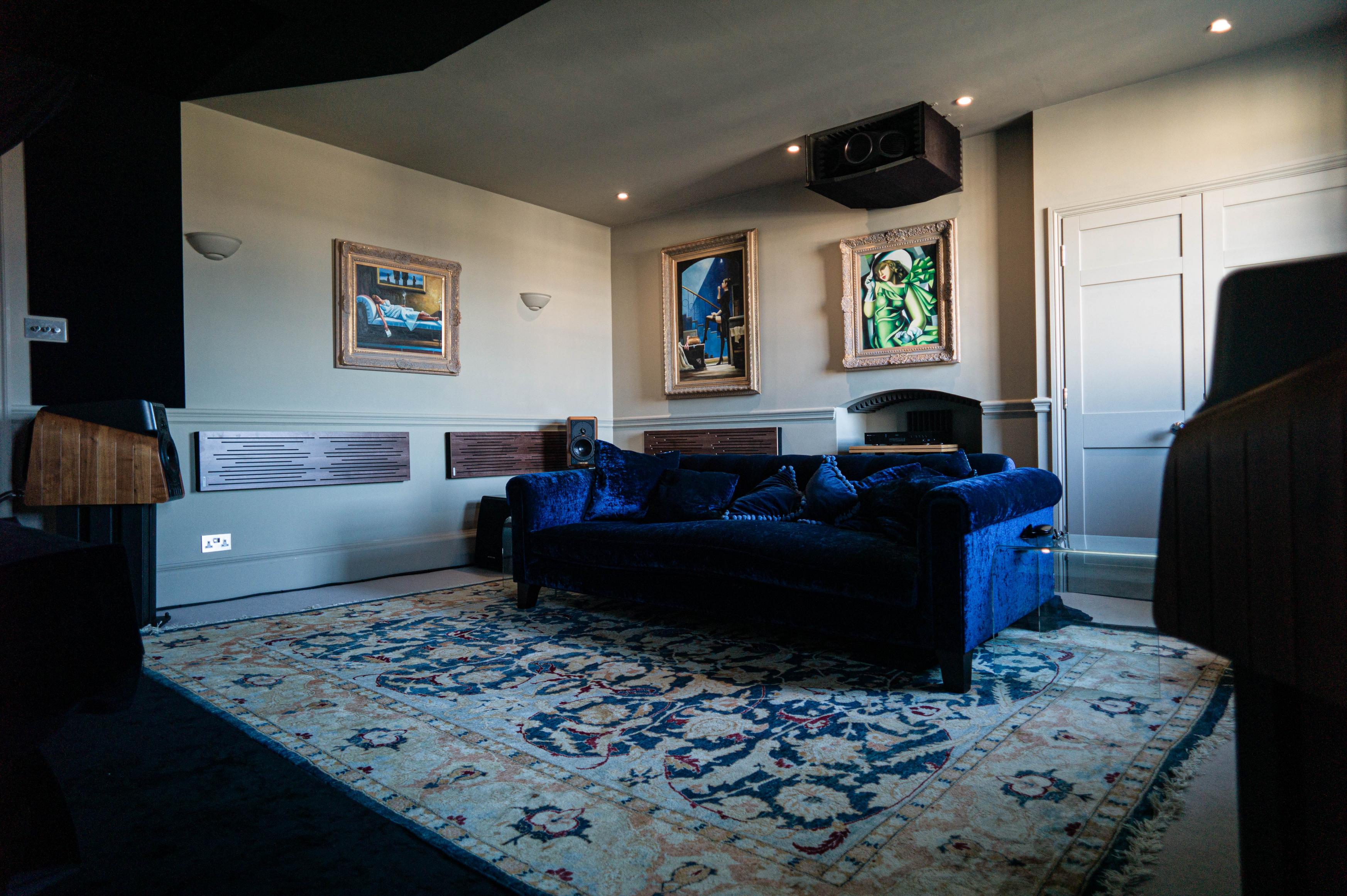

50mm will be fine, the bass trapping from these will be pretty minimal, I have used these in my room with good effect and they look great. I set them at ear level. Ideally I would have had a few more above the dado rail, but was pretty happy with the sound. it's nicely clean without being dead, or soaking up transients and dynamics. No congestion and the imaging improved
