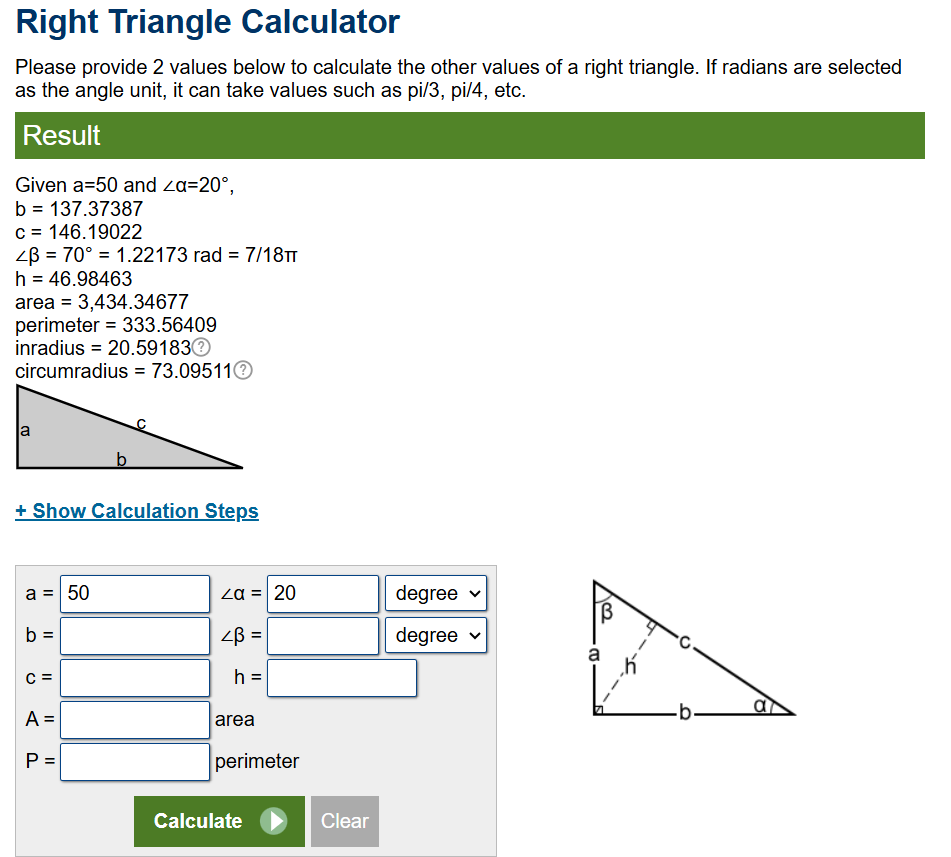

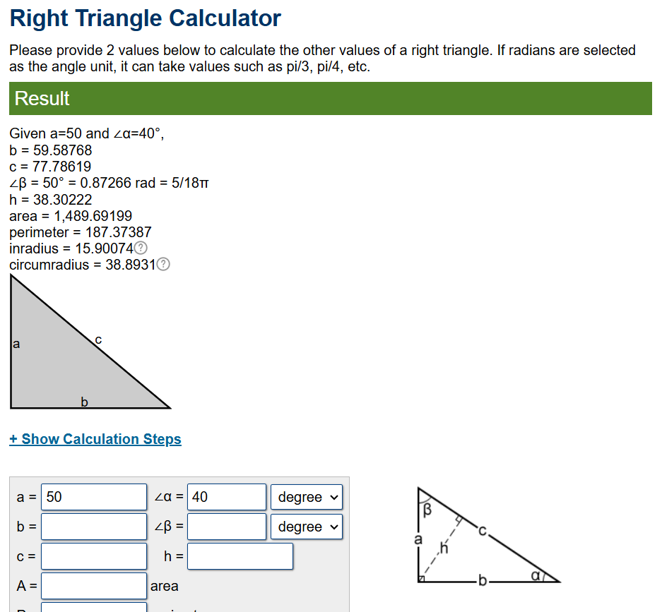

I made two pictures,
Example 1 has typical small two way speaker with waveguide. Its well made and starts to have 60° (-6db) at 1khz until 20khz
Example 2 is k-402 horn as mentioned before
Listening distance is 3 meters
Both angles in your pictures are the same, around 50 degrees, while the K-402 is around 90 degrees and your theoretical "typical small" speaker is said to be 60 degrees.
Obviously, 90 degrees covers a wider area (at any distance) than 60 degrees, at 3 meters from the source the 60 degree covers roughly 3 meters @-6dB, the 90 degree around 4.5 meters.

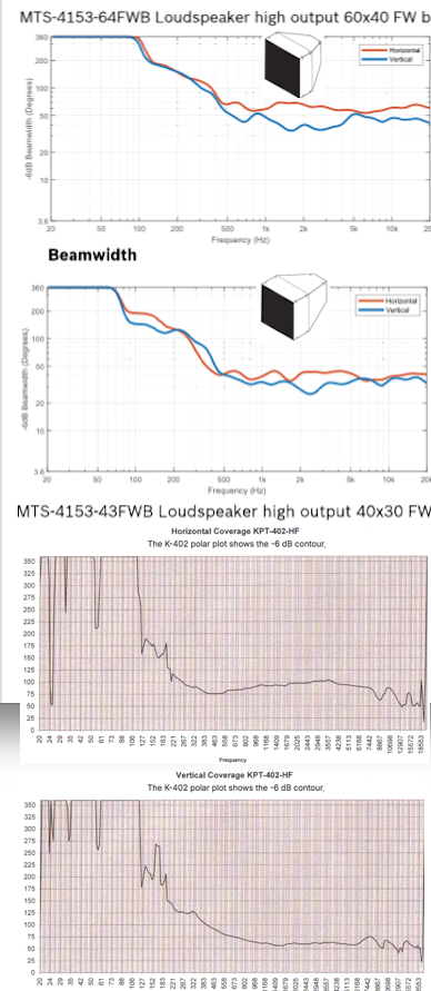

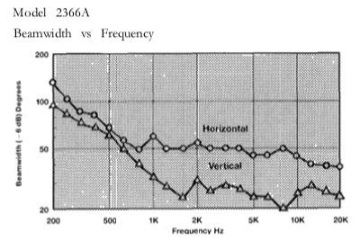

The "small" speaker's horn would be over 445mm (17.5") wide to have ~60 degree horizontal coverage pattern at 1000 Hz. The JBL 2385 (nominal 60 x40) horn expands to 70 degrees at 1kHz:

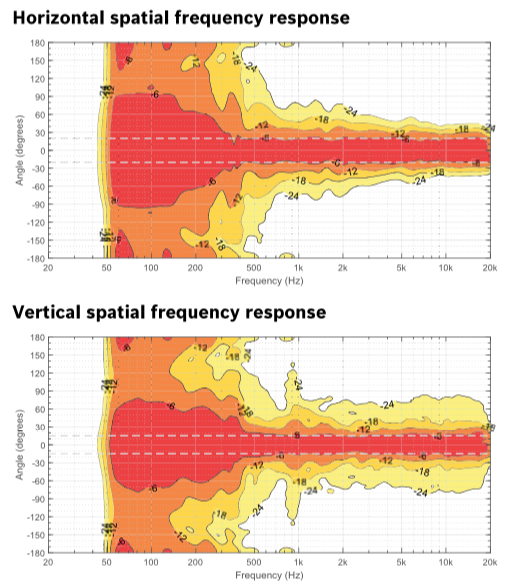

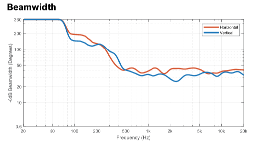

The typical waveguided speakers i had in mind was Genelec 8030. See the attachment
So i have diy speakers 15" bass 6,5" mid and xt1086 nsd1095 combo on top crossed at 1400hz . Xt1086 is 80° x 60° constant directivity from around 1400hz
Ubacch works extremely well with the xt1086 (plug on/off makes huge improvement) but not with the average small Genelecs
Why is that? Speaker placement is the same
My room is extremely good, it measures and sounds really good
Actually the lower i go with crossover with the xt1086, the better the ubacch sounds. Even at 1000hz when i have directivity mismatch with the 6.5", crossing so low
  • Genelec 8030C Professional Studio Monitor Horizontal Beamwidth Measurements (1).png
  • Genelec 8030C Professional Studio Monitor Horizontal Directivity Measurements (1).png
The attachment shows the Genelec 8030 dispersion expands from ~over 100° at 2kHz to 200° at 1kHz.
From 4kHz to 10kHz the Genelec 8030 -6dB is 120° (60°left+60°right=120°).
Nothing like your "Example 1", 60° (-6dB) at 1kHz.
Why is that?
The XT1086 is ~55° at 2kHz, and ~105° at 1kHz, about half the dispersion width of the 8030 "near field monitor"(as Genelec refers to it). Near field monitors are generally used in the 1 -1.5 meter range.
As you have found, (and I mentioned in post #17) Ubacch has less "work" required to remove the room response from the HRTF (head related transfer function) the more narrow (and consistent) the dispersion pattern of the speaker system is.
Art
