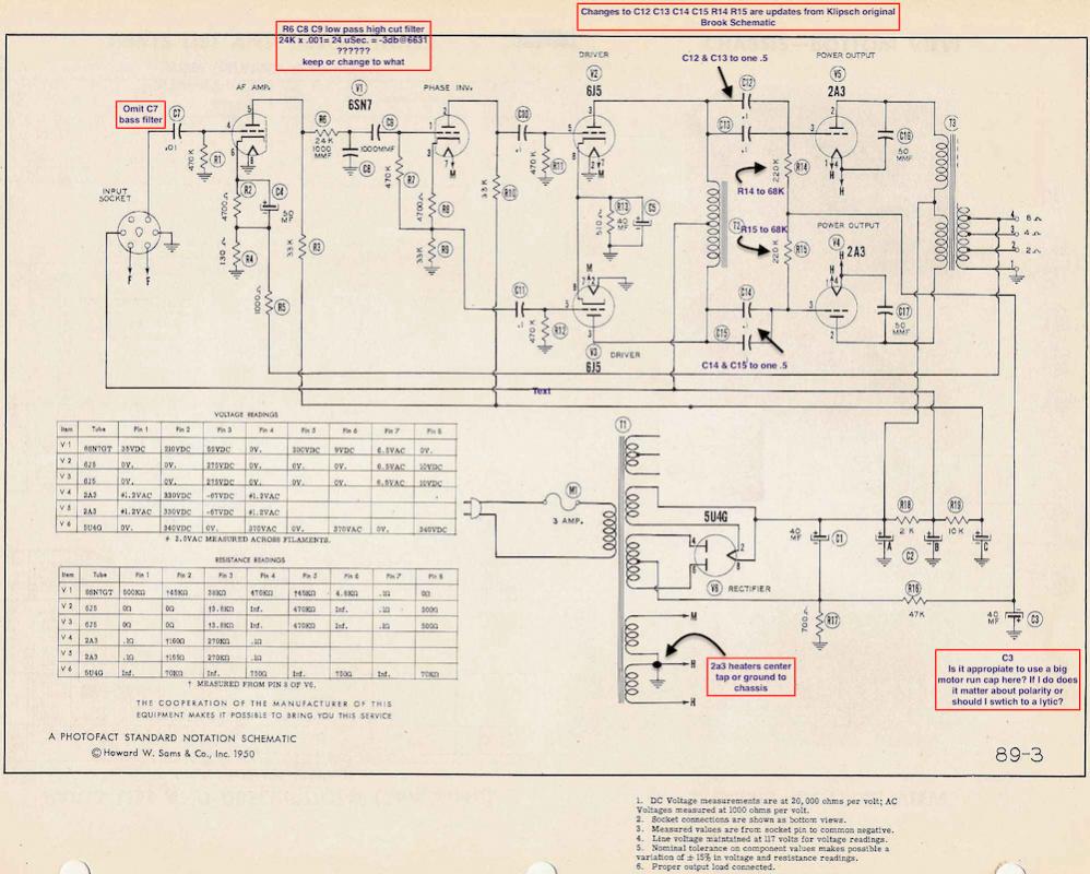

Wondering if someone can help understand the centre tapped choke used in the Brook12A design.
What happens if the centre-tapped (1800-0-1800) is replaced with two separate chokes, each 0-1800. Does it still work the same ?
A friend just built me a pair of monoblocks and I wanted to understand what happens. We just went ahead and put two single chokes in it.
It sounds brilliant, no complaints whatsoever. The 700R used for the negative bias is a source of heat and needs to be managed.

Here's the schematic.
Yes, it'll just be more expensive.
CT chokes, just like PP OPTs, don't need core gap (currents in the two halves compensate each other) and thus can have more inductance per iron size.
But separate chokes benefit from the inductance being less dependent on the signal level.
Well, not exactly.
Actually, separate chokes do Not get the same results, versus the results with the center tapped choke.
Two separate chokes are not on the same single lamination.
That means that any 2nd harmonic distortion of one 6J5 will not be canceled by the other 6J5.
And, the driving impedance change versus signal level seen by the tapped choke is almost constant.
But separate chokes each will see a very large driving impedance change versus signal level.
And, the second harmonic distortion will not be cancelled until After it comes out of the push pull output transformer.
And when there are two or more music notes at the same time, the 2nd harmonic distortion creates Intermodulation Distortion (more tones, more distortion).
Cancel the 2nd harmonic in the driver stage. That way, the output stage does not have to deal with it.
Hmmm, it seems that those designers at Brooks may have actually known what they were doing, way back then.

Lets look at the 6J5 drivers and 2A3 outputs a little differently:
Look at the top driver, and the top 2A3 (the one that it drives).
The driver has some 2nd harmonic distortion.
The 2A3 has some 2nd harmonic distortion.
The input to output phase of a triode is out-of-phase.
But we have the serial effect of two triodes, so the 2nd harmonic distortion of the driver
is partially canceled by the 2nd harmonic distortion of the 2A3.
The same effect is true for the bottom driver, and the bottom 2A3:
Partial cancellation of the 2nd harmonic distortion (again, this is a “serial” cancellation).
But we know that there is more 2nd harmonic distortion of each of the two drivers if we use 2 chokes, versus if we use the center tapped combined choke.
What that means is that the partial 2nd harmonic cancelation of a driver and its respective 2A3, will have different amounts of 2nd harmonic cancellation, depending on whether we use 2 separate chokes, or instead use the single center tapped choke.
Now part of how this all works out is also dependent on how well the driver tubes are matched, and also how well the 2A3 tubes are matched.
And then, there is the factor of the differences in the inductance of the separate chokes versus the single center tapped choke, the distributed capacitance of both, the possibility of saturation of both, and more.
It is nice to know all that.
But there is another factor that changes the overall result; the global negative feedback that the amplifier uses.
Negative feedback tends to lower distortion.
But that means that the distortion that is inside the global negative feedback loop is partially covered up (making it harder to hear certain changes that we make, such as 2 chokes versus one choke).
What you heard as a difference with 2 chokes, versus a single center tapped choke is dependent on all the above factors (and a few more, but that is enough of that).
