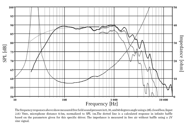

“SB acoustics” looks like a good option
and especially the 6ohm
10” SB29NRX75-6 , I’m a bit concerned that is has a break below 1000hz and I will possibly need to cross with the midrange around 950hz .

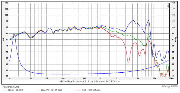

The driver's preference for one enclosure type or the other is determined by its parameters (the way it is designed). Its size does not affect that aspect. Today, the trend is generally toward ported enclosures so it's a little harder to find woofers that naturally play very low in sealed enclosures.
For 10 inch sealed, I like this one (there's an 8 ohm version also):
Scanspeak Discovery 26W/4534G
https://www.madisoundspeakerstore.c...very-26w/4534g-10-aluminum-cone-woofer-4-ohm/
It won't go super low, but it's a big improvement in bass weight/extension/sensitivity over any 8 inch I've tried sealed. My concern for it in your application would be the breakup region that gets serious around 2 kHz. Depending on how low your midrange can play and the slope you want to use, the 26w/4534G's breakup may be lower in frequency than you want.

Forget that driver crossing that high. It Will get impressive High spl and deep in 30 liter volume.
Cross it no higher than 150 hz top. Higher than that it Will Sound muddy/thumpy.
Im sure there is plenty much better drivers around.
Better use is dedicated subwoofer.

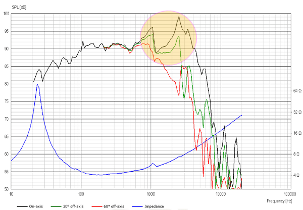

28w-4878t01
That one breaks up even earlier than the 26W/4534G. The areas of random, large magnitude peaks and dips in frequency response are ones you normally want to avoid or suppress somehow. I don't think your crossover has any kind of parametric equalization feature, so it's not going to help you filter those specifically. You just have to rely on the crossover roll-off to suppress them enough to make them inaudible.
Your dome midrange is a limiting factor in this situation. It just can't play down low enough for many larger woofers to work well. Even some very highly regarded and expensive woofers have breakup behavior that won't let them play smoothly to high enough frequency to mate well with it. Another trend in recent years has been the push for harder/more pistonic cones and stiffer formers, glues, etc. They are very linear and responsive in the areas where they are behaving, but they often have more aggressive breakup and more chaotic roll-off than older, softer materials.
700hz . Now I’m crossing the Visaton TIW200XS at 950hz with 18db slope
At 700 Hz and 18 dB per octave, I think you are far enough away from the 26W/4534G breakup to be OK. If you find another woofer you like that has mostly smooth frequency response up to about 2 kHz, it will likely be OK too.
It's worth keeping an eye on off-axis behavior also. The dome will have very wide dispersion at the bottom of its range, and the woofer will likely be narrowing there. A little mismatch isn't a big deal, but if the off-axis response is very chaotic or rapidly falling off, that is less desirable than matching the wider dispersion of the dome.

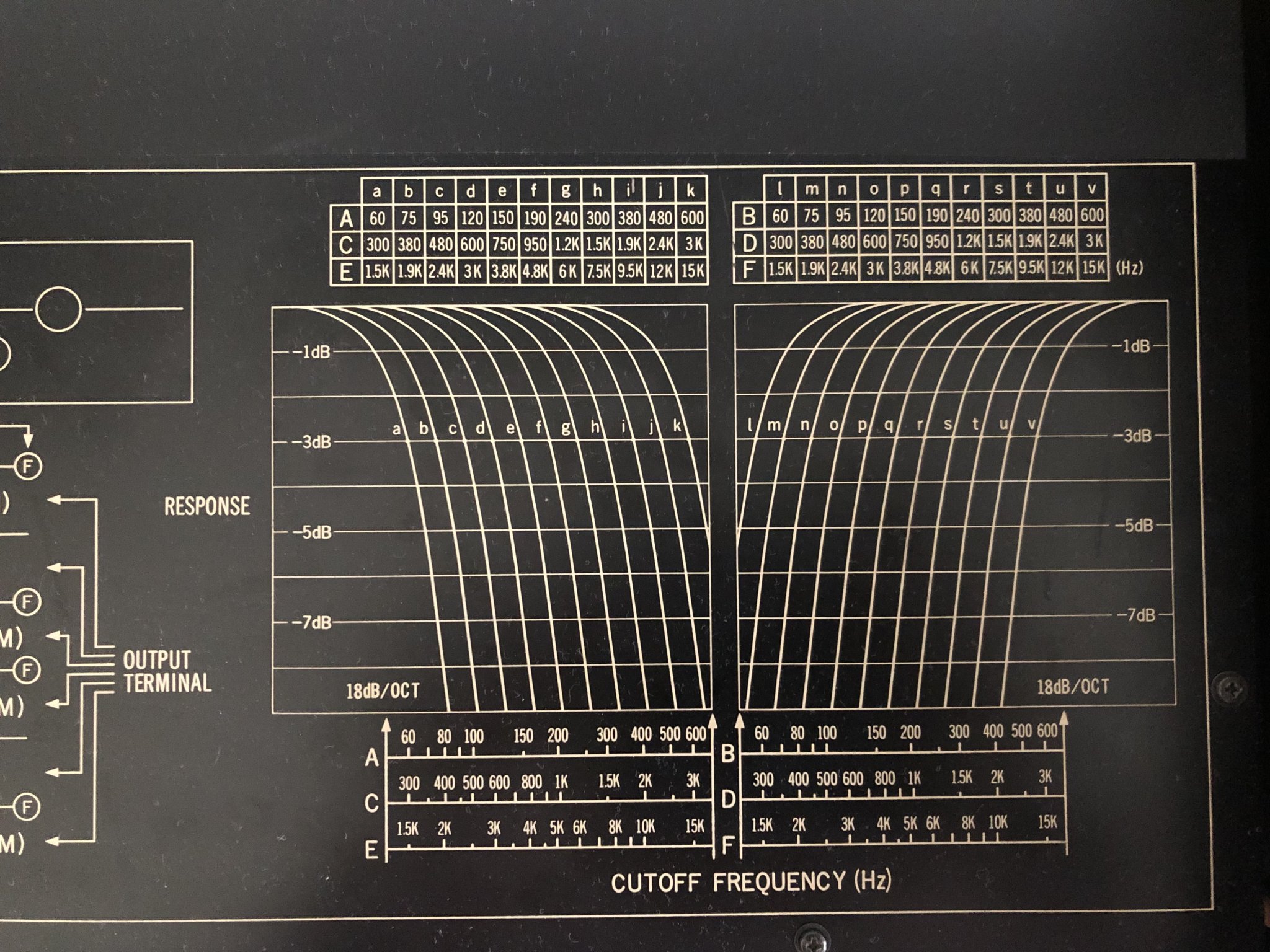

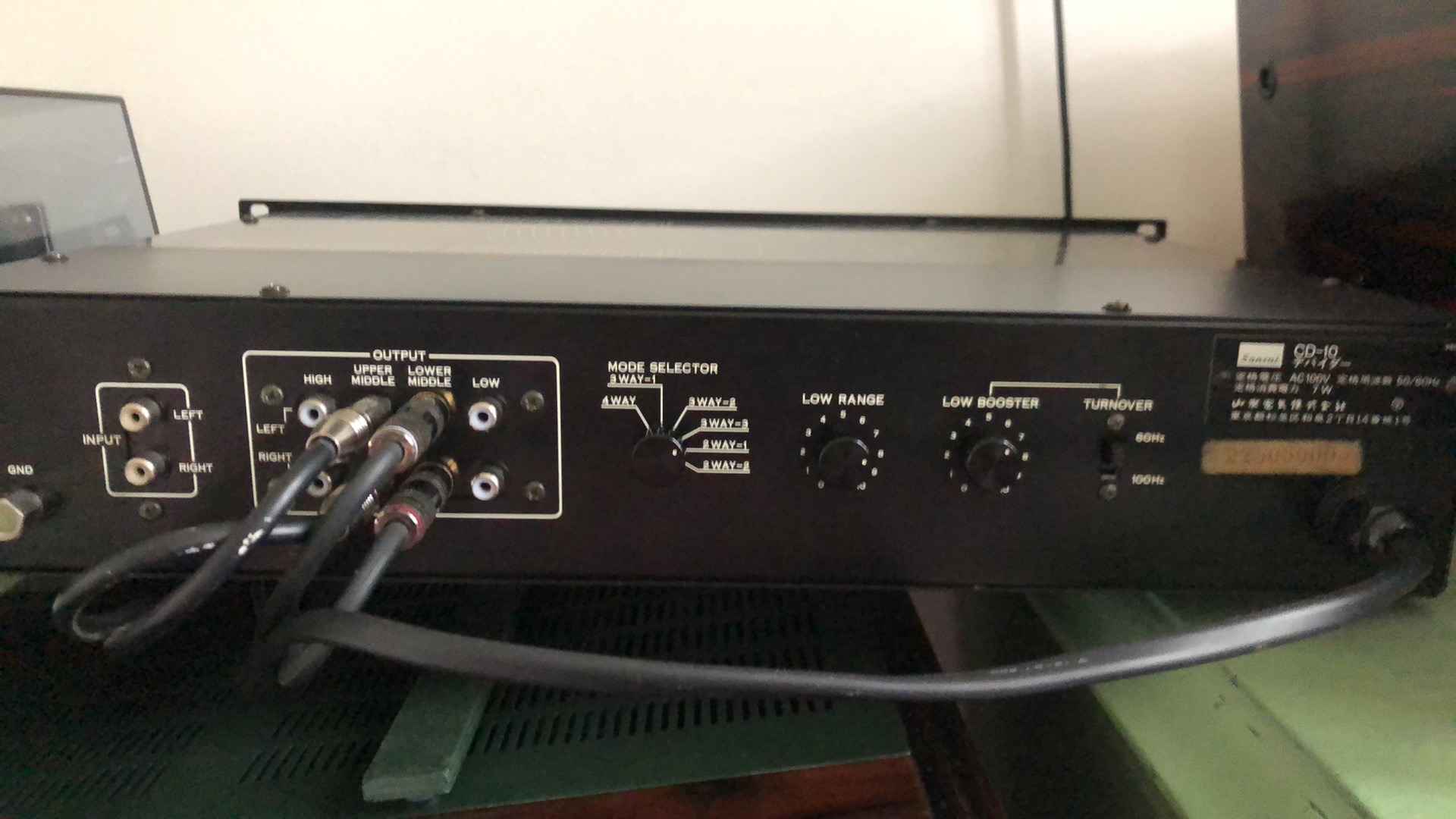

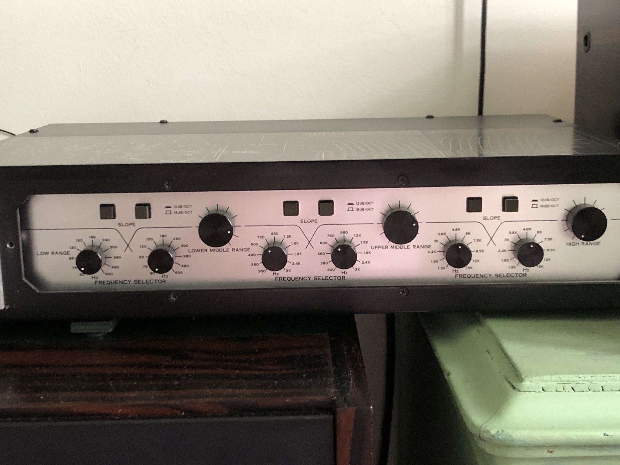

Maybe it worth posting a photo of the crossover and its function ?
So as far as I understand a 3way speaker with dome midrange is almost impossible, personally I can’t find on the internet a woofer that breaks up above 2000hz.
I have the option to go 4way and I do have on hand and extra amplifier and the
8”Visaton AL 200 but then I assume that I will need to go with a 12” subwoofer; and that is impossible space wise ….Enclosure for 4way speaker and 4 amps in my listening space it will be overwhelming, so I really need to keep it tight .
As an amateur I need to ask how “they”achieve to make a two way speaker with a woofer and a tweeter and sound good enough to put it on the market and ask for high prises too?

Truth is that I’m not playing loud , I’m not enjoying loud music any more and my listening space is not big. I can see that the driver above can handle 80W continuously and I think that I will not go that high very often or never .
The short answer to what I’m willing to compromise is as less as possible but I do understand that is going to be compromise with a dome midrange driver….
