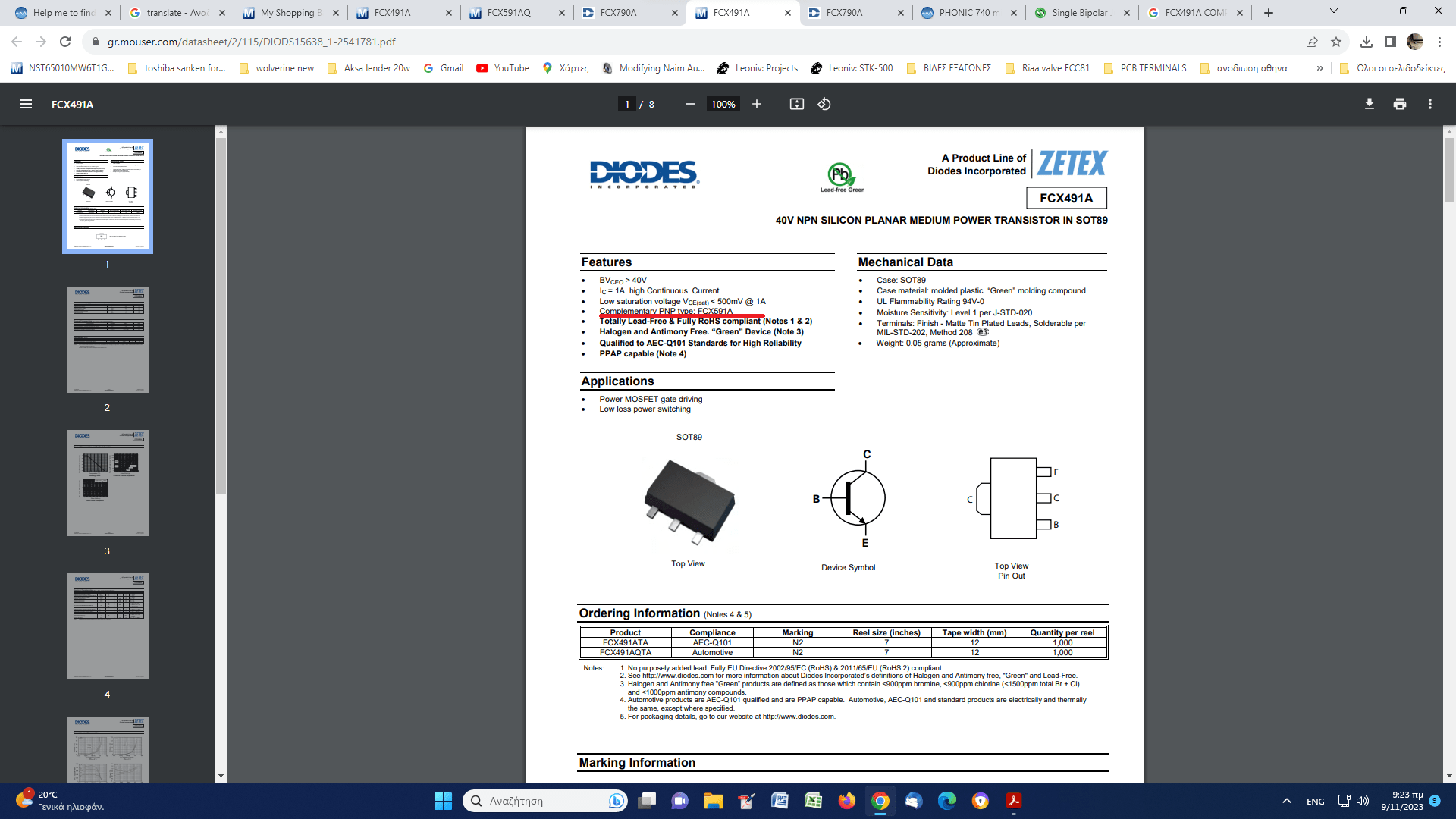

Is it necessary the PNP AND NPN driver belongs to the same hfe grade?
I ask this because i can find ZTX790B availabe but only ZTX690A.
Same for FCX790A & FCX690B. Last combination would be the best for me as they are available at Mouser.

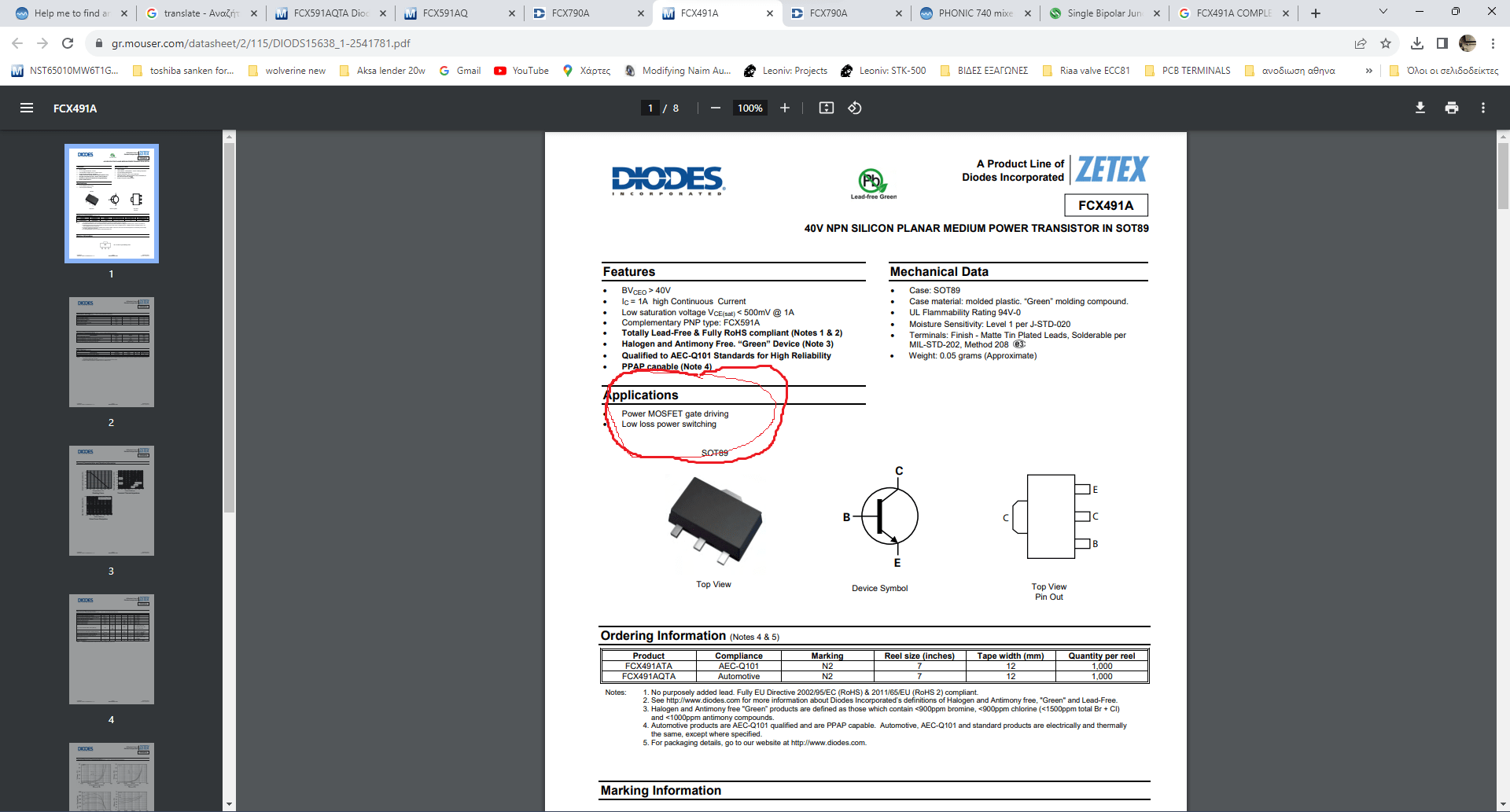

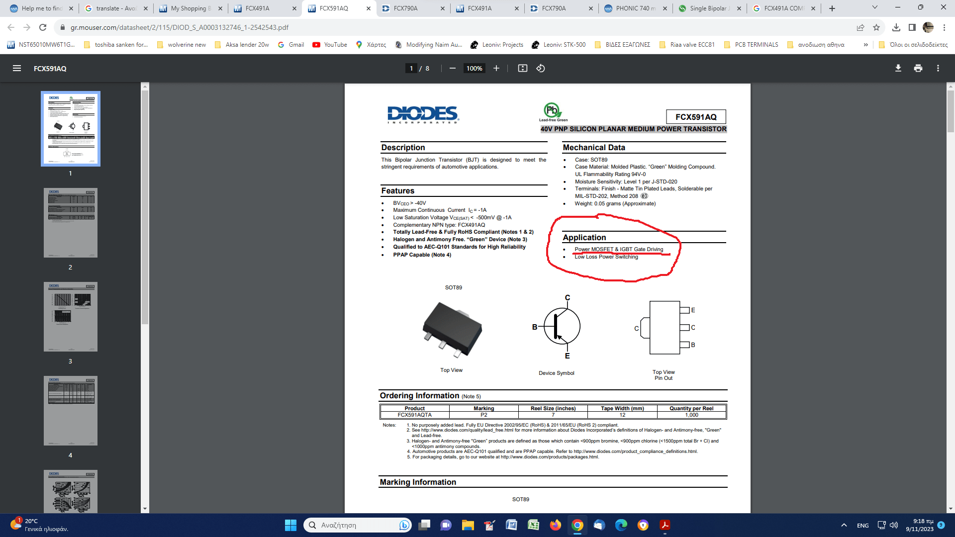

Just now i see this.
Theese are Complementary pairs and available at Mouser.
Application -Power MOSFET & IGBT Gate Driving
The one that i have on hand are special designed for the job but i don't know if these are suitable in my case.
https://gr.mouser.com/ProductDetail/ROHM-Semiconductor/RGT40TS65DGC11?qs=QkPn6D1Vh3jrPGFRkdViBA==
ZTX749/690 is my universal “2 amps and under” driver set. Been using them for decades.
Not necessary for hFE to match. Most of the time you charge through a resistor and discharge through a diode, to force the mosfet/IGBT turn OFF time to be faster even if the NPN driver has more gain. That prevents cross conduction. The series R value tells you how much peak current is needed (VGS/R). Discharge will try to draw more, but run out of gain. Thats ok as long as it’s faster overall. Total energy is the same in the charge/dischrage cycle (for a given vgs) - so the overall heat only depends on frequency, not the number of nanoseconds it happens over each time. Just the number of times per second. 70 KHz isn’t crazy high these days, I’m confident they won’t overheat driving normally-sized devices. Some of the really big ones need 8 or 9 amps - but we’re talking solar farm size inverters and 14,000 watt amplifiers. That stuff is way outside my wheelhouse.

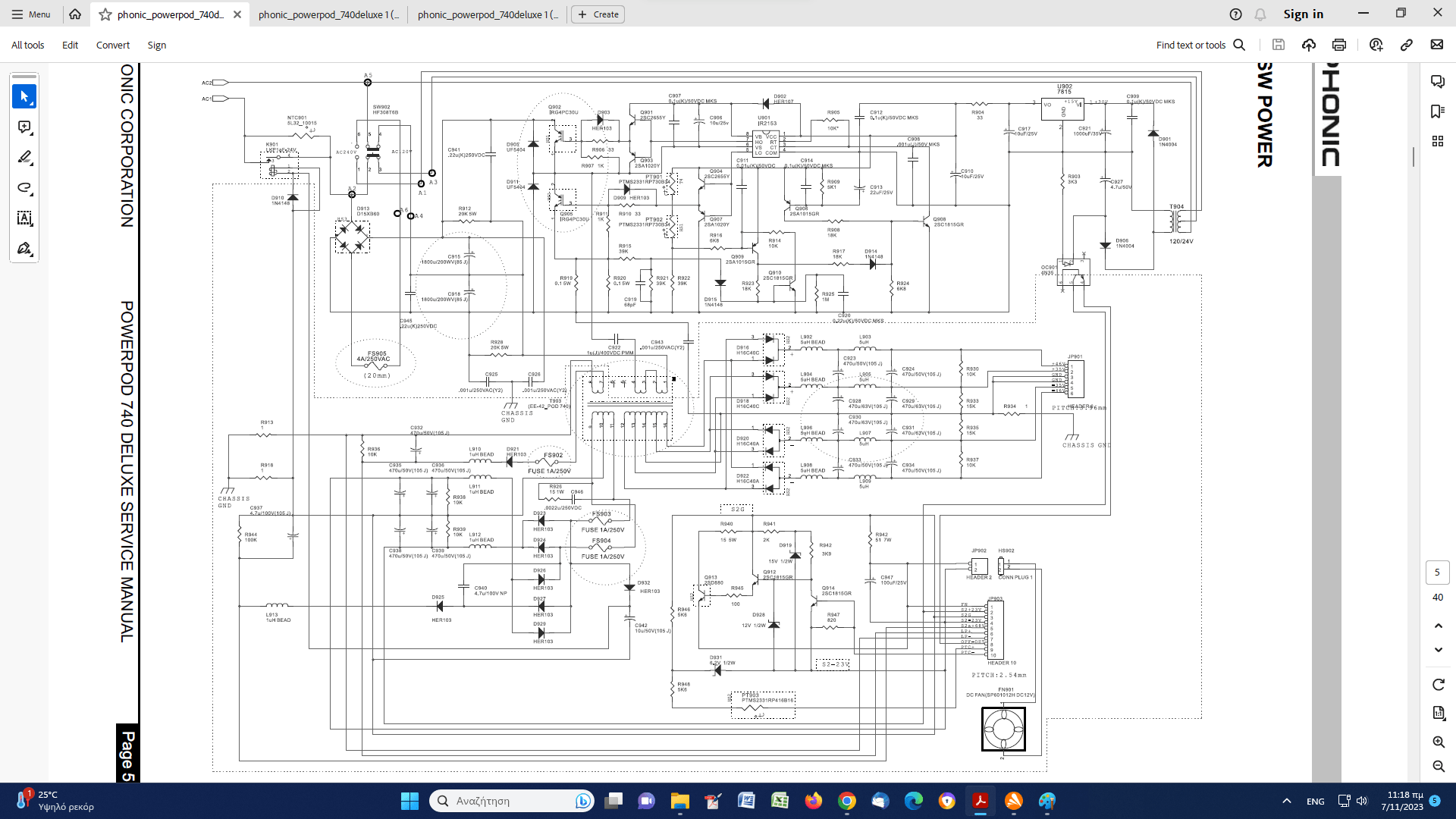

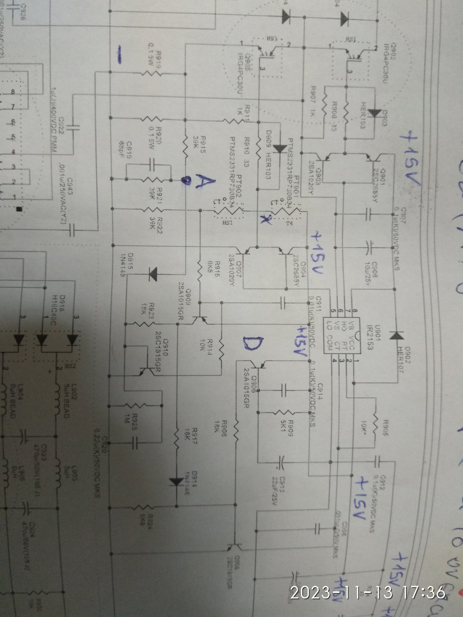

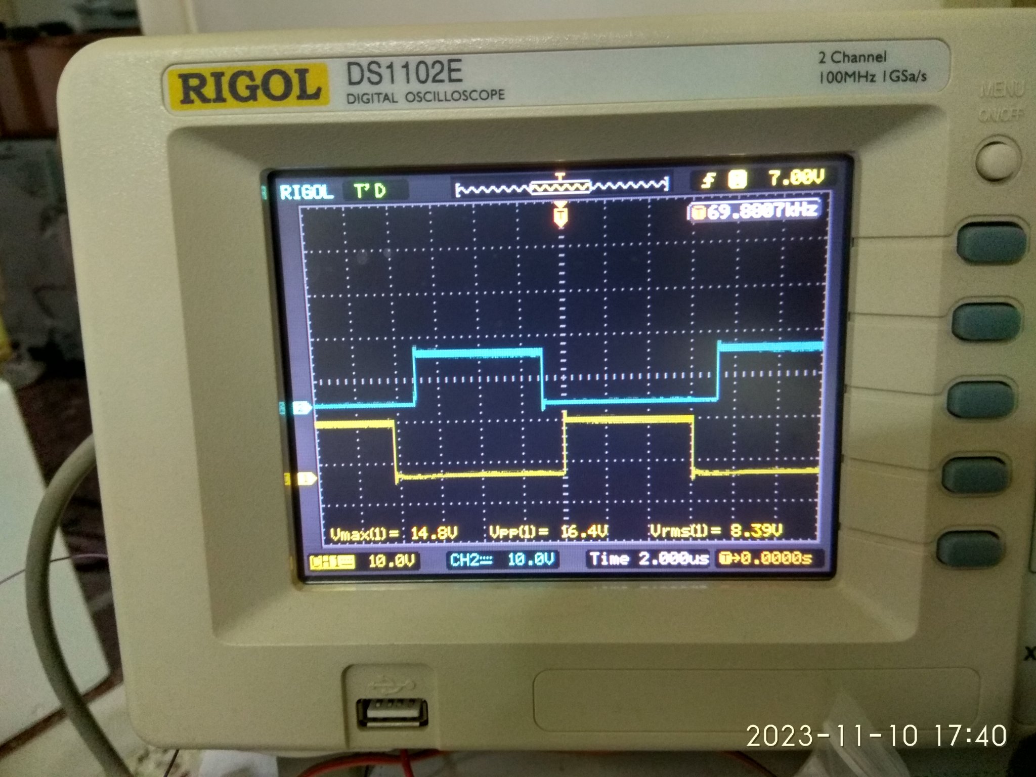

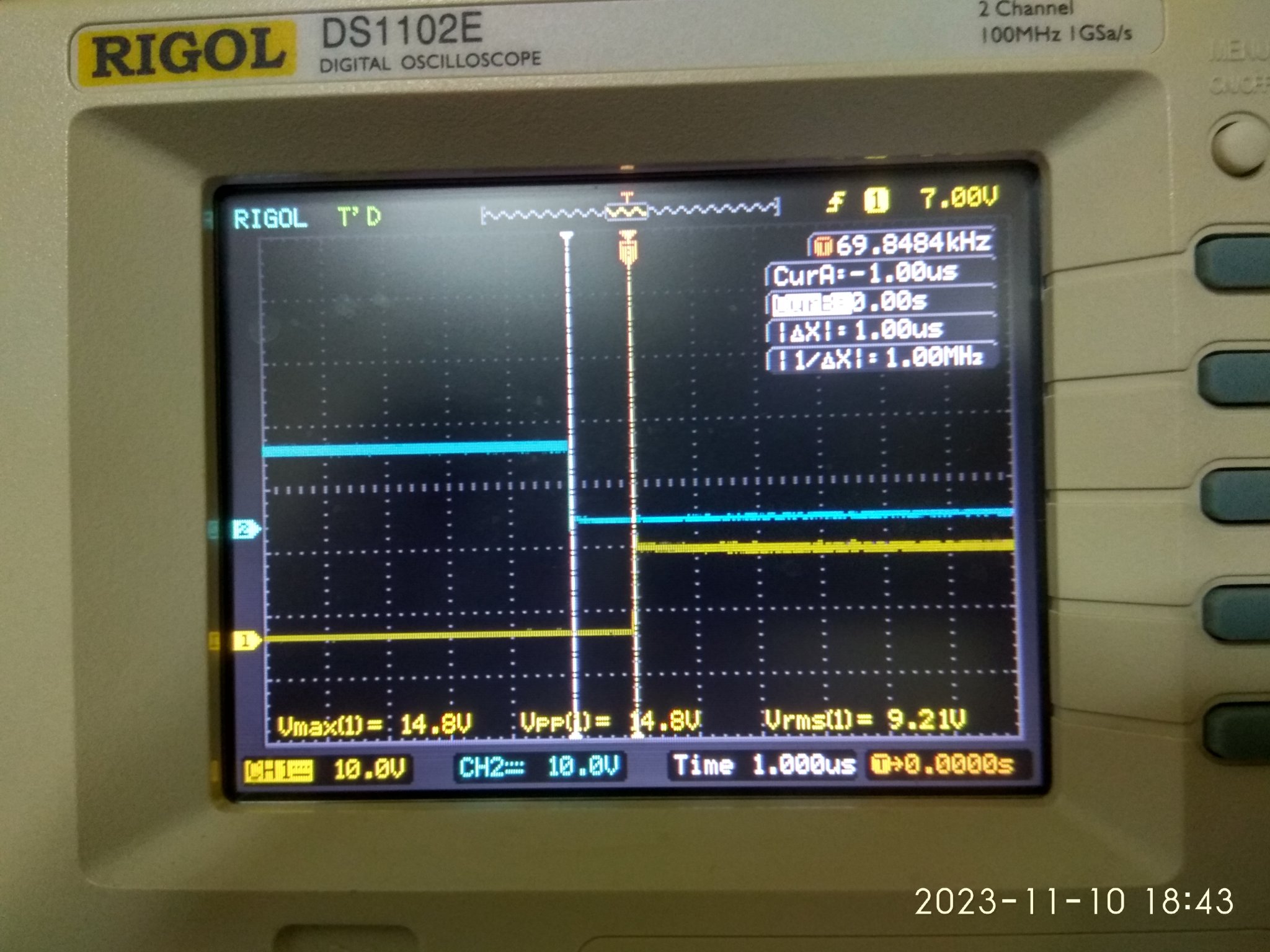

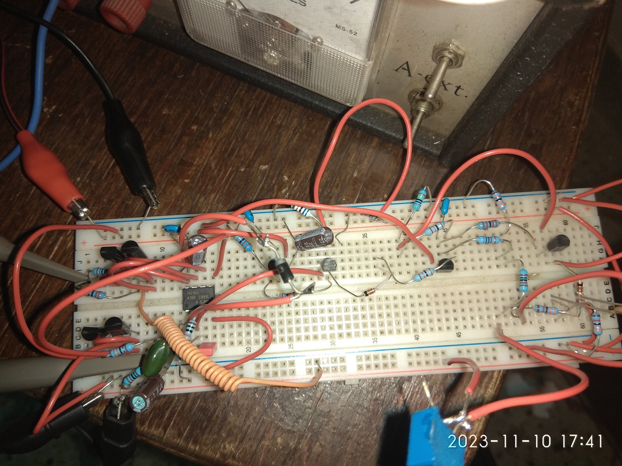

In the meantime i have this
A breadboard same circuit to study the purpose of each one of the transistors around the IR2153.
Scope at the drivers output
According to my findings
Q908 stop the oscillator when is active.
Q906 is a time delay circuit.
At startup delay the oscillator ,in compination with Q908 ,about 1".
Collector Q906 is positive and this positive voltage in Base of Q908 keep this active and IR2153 oscillator not working.
Q908 have a second role too.
This prevent the direct start after power off.
This time is about to 15".(C913 discharge)
Q909 is an overtemperature switch.
Two thermistors,one at the main heatschink and another one in the smps transformer keep the Q909 base positive as soon as temperature is low enough.
When temperature is high base go negative and this active the 909 and this active Q908 to stop the oscillator.
Q910 is an overcurrent switch
Current sense resistors Q919-920 monitor the IGPT current.
1.8 volt at point A about 3.6A is the maximum allowed current.

I have seen so many reports about instant failures after startup in smps using IR2153.
One report say that is a very high frequency oscillation at startup.
I think this is the reason for use of the Q908.
Another reason for instant failure is the uncharged big electrolytics that is practically a short circuit for IGBT,that's why the NTC is in circuit.
