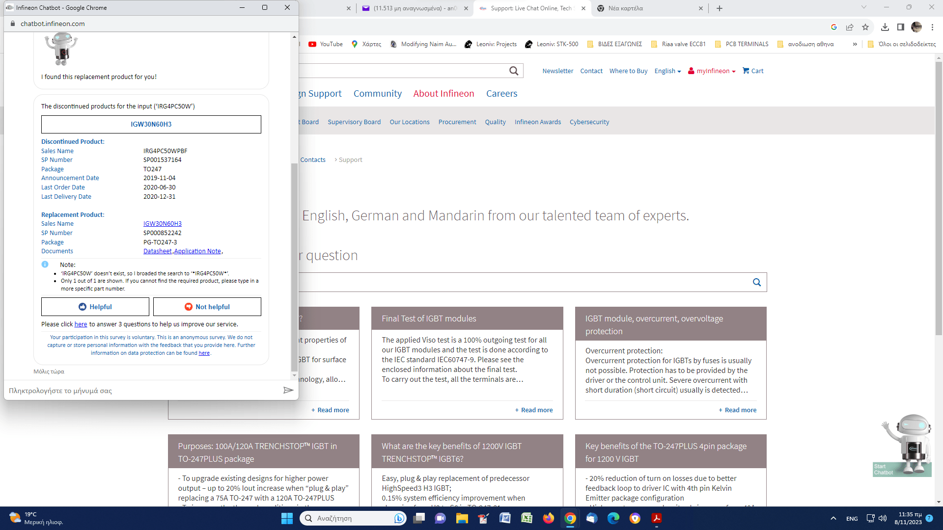

Today I got luckier and have an answer via chatbot.infineon.com
