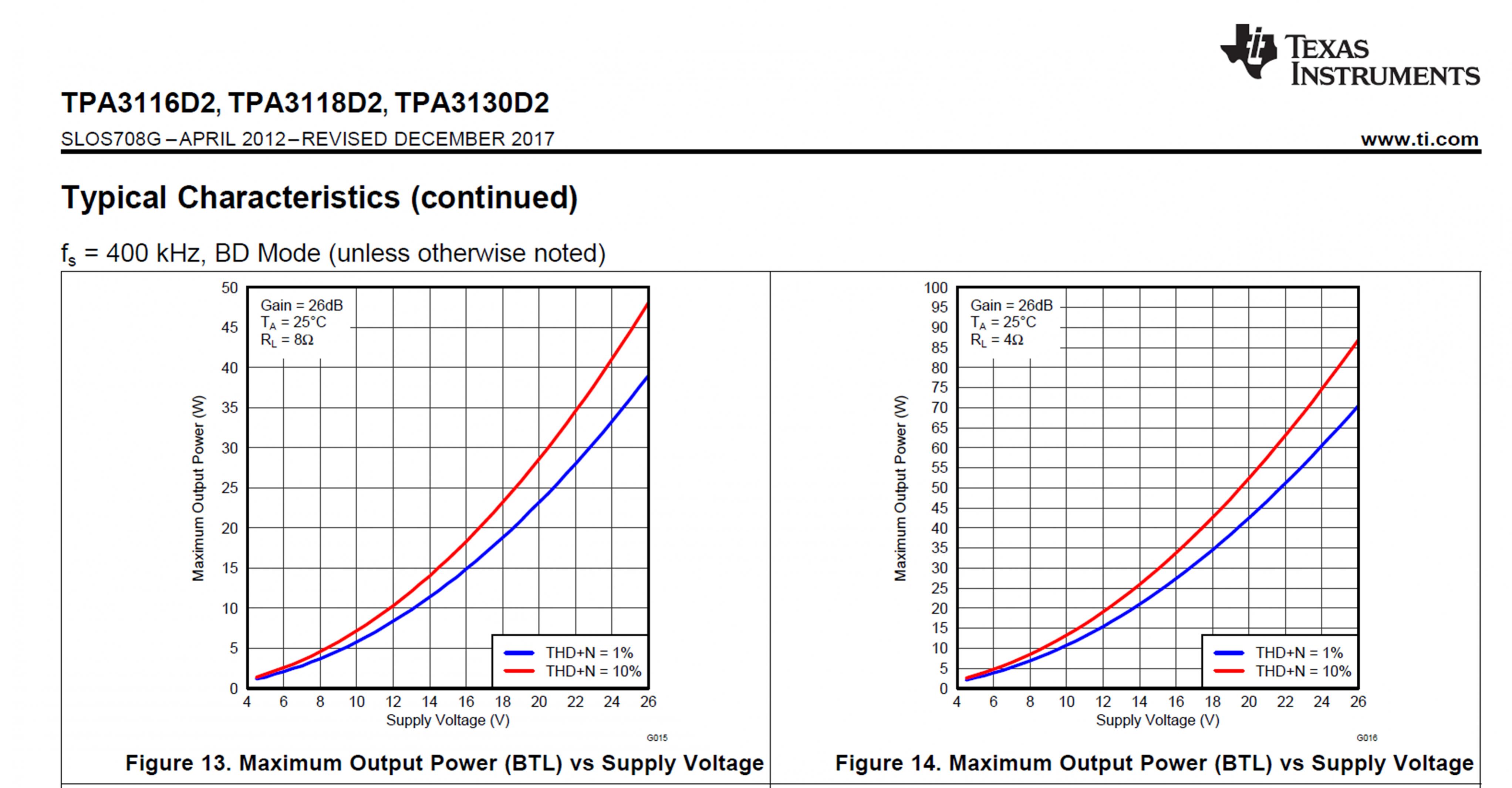

Where I get stuck is: does 18V supply give me a max signal of -9V to +9V ??? (therefore 6.4V RMS, 1.6A , 10W per channel ?)

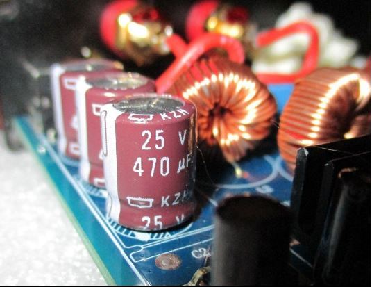

There is a chinesium 25v power cap onboard so I would not use more then 20V. Clean output (1% thd) at 4 ohm reads 42W. 2 channels makes 84W max = 4.2A but you can go about 1/3 lower as most power supplies can deliver a peak higher then they are rated for continuous.
A standard laptop power supply, about 19v 3A will work fine.
For 8 ohm loads you can safely go to 24 volts with most of these tpa3116 amps in which case you want at least 4 amps continuous power. There is a small risk of the 25 volt cap being off-spec so you may want to consider swapping it for a 35 volt one of the same value.
For 4 ohms, I would follow @Think's recommendation to stay at 20 volts or less to prevent overheating the chip.

You are close. The outputs are actually swinging from +0 to +18 volts. But since they are configured BTL, as one amp is swinging from +0 to +18 on one side of the speaker, the other side of the speaker is swinging from +18 to +0. This doubles the RMS voltage to 12.8 volts. Now you have 3.2 amps and 40 watts per channel.
Mike
OK thanks everyone. I hadn't grasped that the power graph was showing bridged into a single speaker. I've got a 18V 3A brick on the way.

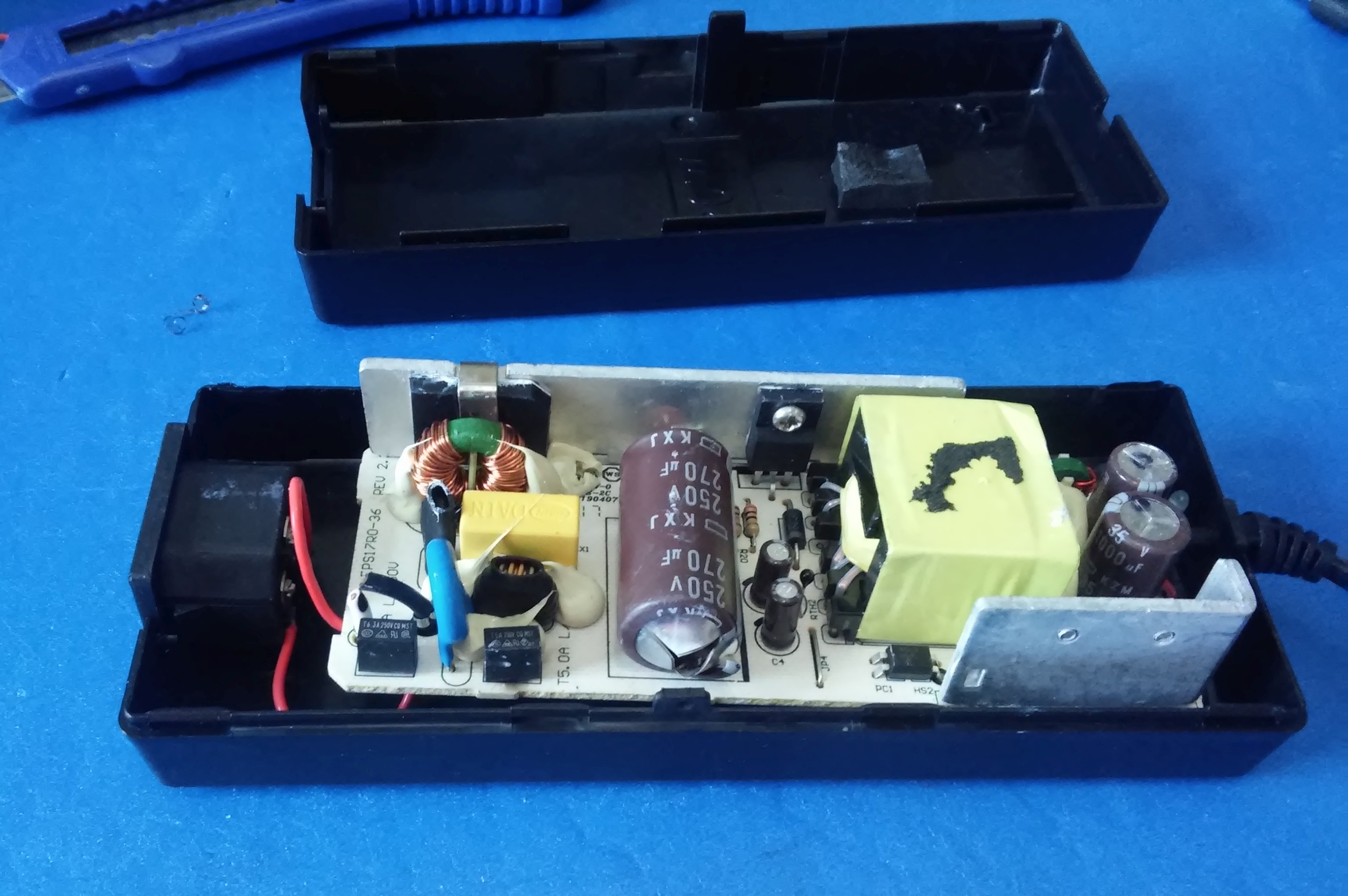

Then I started using the same model amp with a 24V 6A supply (all I had that was >12V ) after two weeks of intermittent use it blew up in the middle of the night. Anyone see a problem with this supply? is 270V OK for that cap (other similar PS I have use 400V).
Amplifier survived and I'm using a 19V 3.4A PS now. I have a gut feeling the laptop supplies might be better quality ????

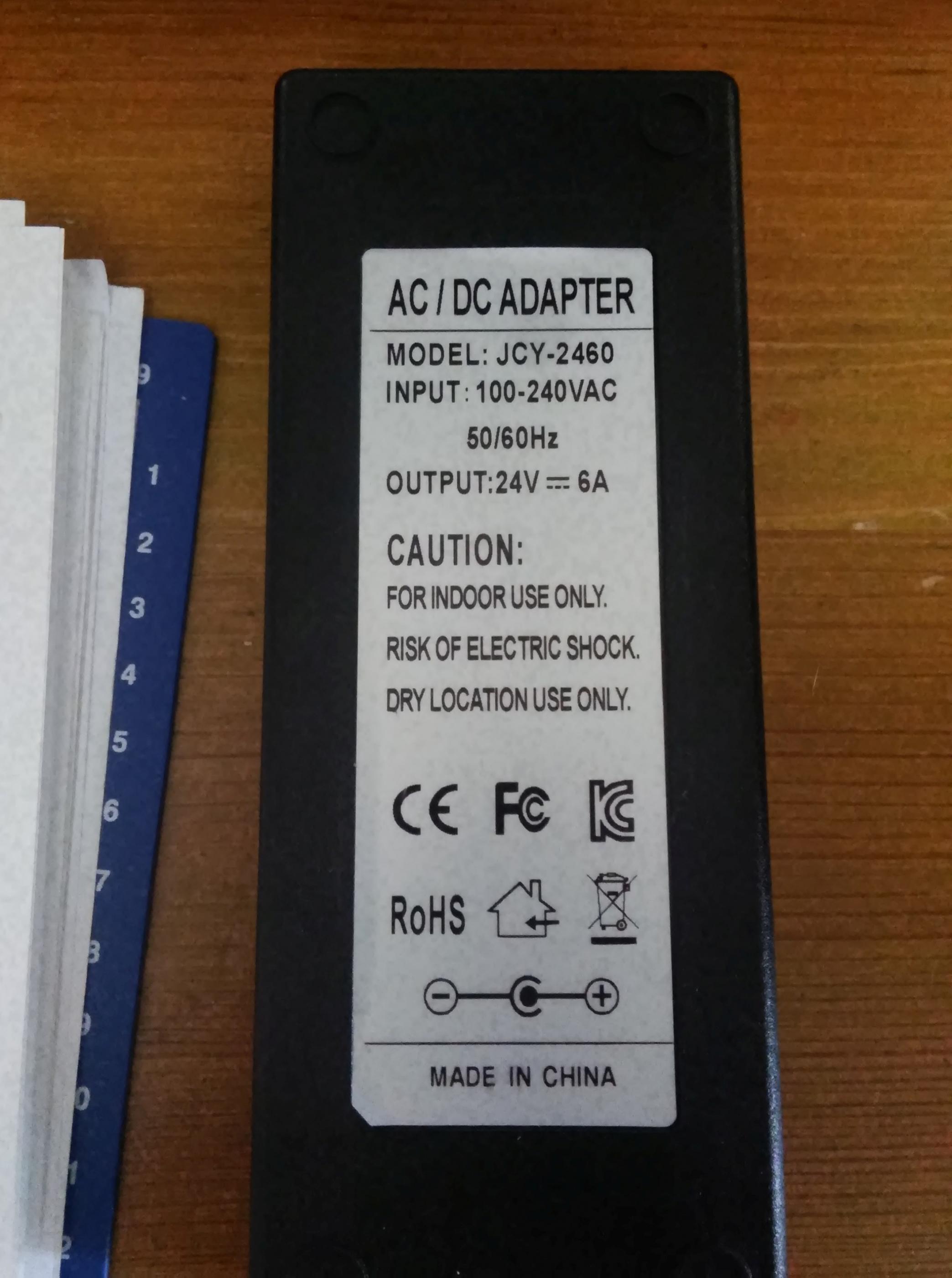

That is amazingly bad. Given your UK flag I would assume you are on 220-240VAC so expect 339V rectified peak indicating your suggested 400VDC rating for that capacitor. Does the supply claim to be rated for 220VAC use or is it marked for 110VAC only.
It is marked 110-240VAC.

Do the math ... 240vac is an RMS voltage so translate it to peak voltage...
peak == RMS X 1.414 == 240 X 1.414 == 339 volts.
So when you rectify the line voltage that cap ends up with ~330 volts on it.
To be honest, I'm surprised that 250 volt bulk cap lasted as long as it did. 400 volts would be far more reasonable for European use.

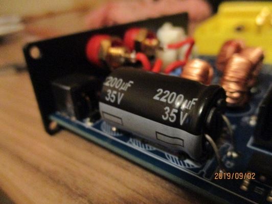

FWIW... My power here is 110vac, so the power supply is less of an issue. But a lot of these mini-amps are coming from China with marginal bulk caps in them. The TPA3116 loves to be on 20 to 24 volts, but most of these little amps ship with 25 volt caps in them. I routinely upgade them to 2200 uf 35 volts before letting them out into the wild with 24volt 4 amp supplies attached. Curiously, the provision for this is most often included right on the board.

I just updated my previous to show how I upgrade the caps. As I mentioned, the provision to do this is most often right on the board. It just requires a bit of soldering skill.
Thanks. I will do this when I use the amp for my music. For the customer arcade machines I'll stick with 19V supply, it's plenty loud enough when your head is 300mm from the speakers !

Sorry. I went for an afternoon kip. As far as I know there is no reasonable cost effective way to bulk rectify AC mains lower than its peak at any reasonable power level, full or half.

What range of uF would be suitable to replace the blown capacitor? I've got a 400V 100uF here but looking to see what I can buy (on ebay!)
I would suggest 400v same value 270uf. More would increase the loading on the rectifier when powering up, less might not provide adequate filtering.
