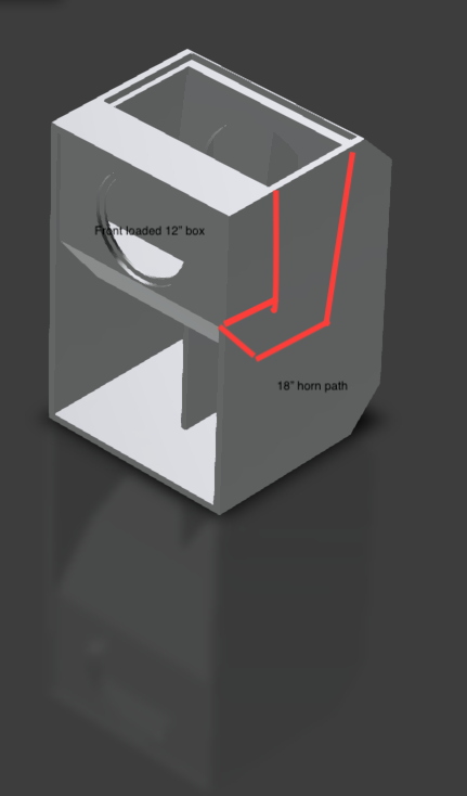

Help me sim CW B36-MF in hornresp
as this cab has two different drivers in the same horn path its not possible to simulate in Hornresp. Very unusual.
The front loaded 12 has it's own small back chamber in front of the 18" offset front loaded horn compression chamber. The two drivers don't share the horn path.
The 12" is mounted on the front, the 18" access panel is on the top.
Two separate enclosures in one box, not unusual for a bass guitar cabinet, though this century typically they use front loaded bass and horn loaded tweeters.
The diagram below gives a rough approximation of the bass horn, FC around 60 Hz.
