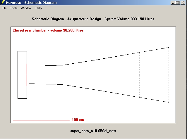

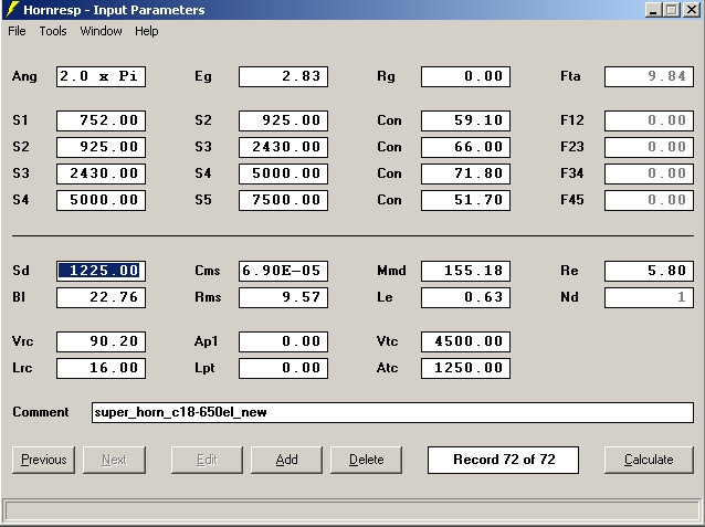

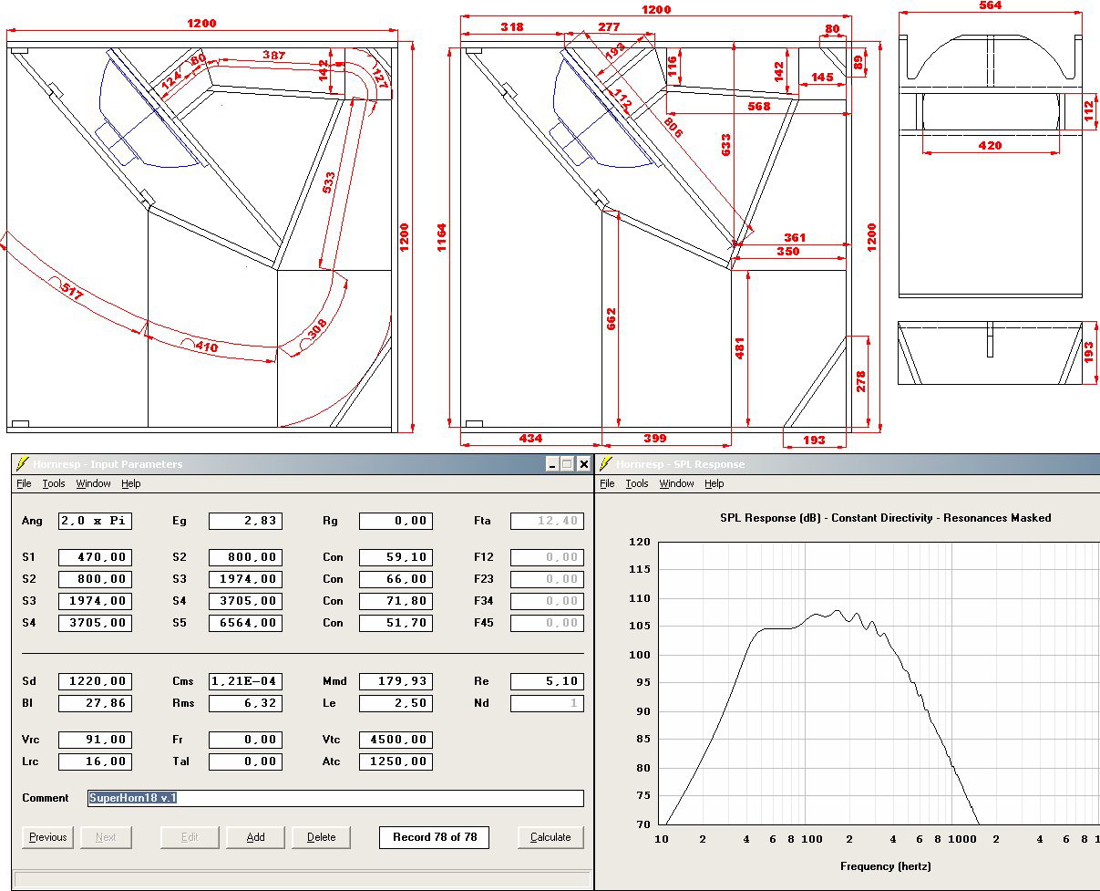

Hello everyone.
I support it. I plan to leave his post. I applied to a C18-650EL 2012, but the problem is the size of the new plan. Please help with. It is an example that I have improved in hornresp.
Regards
