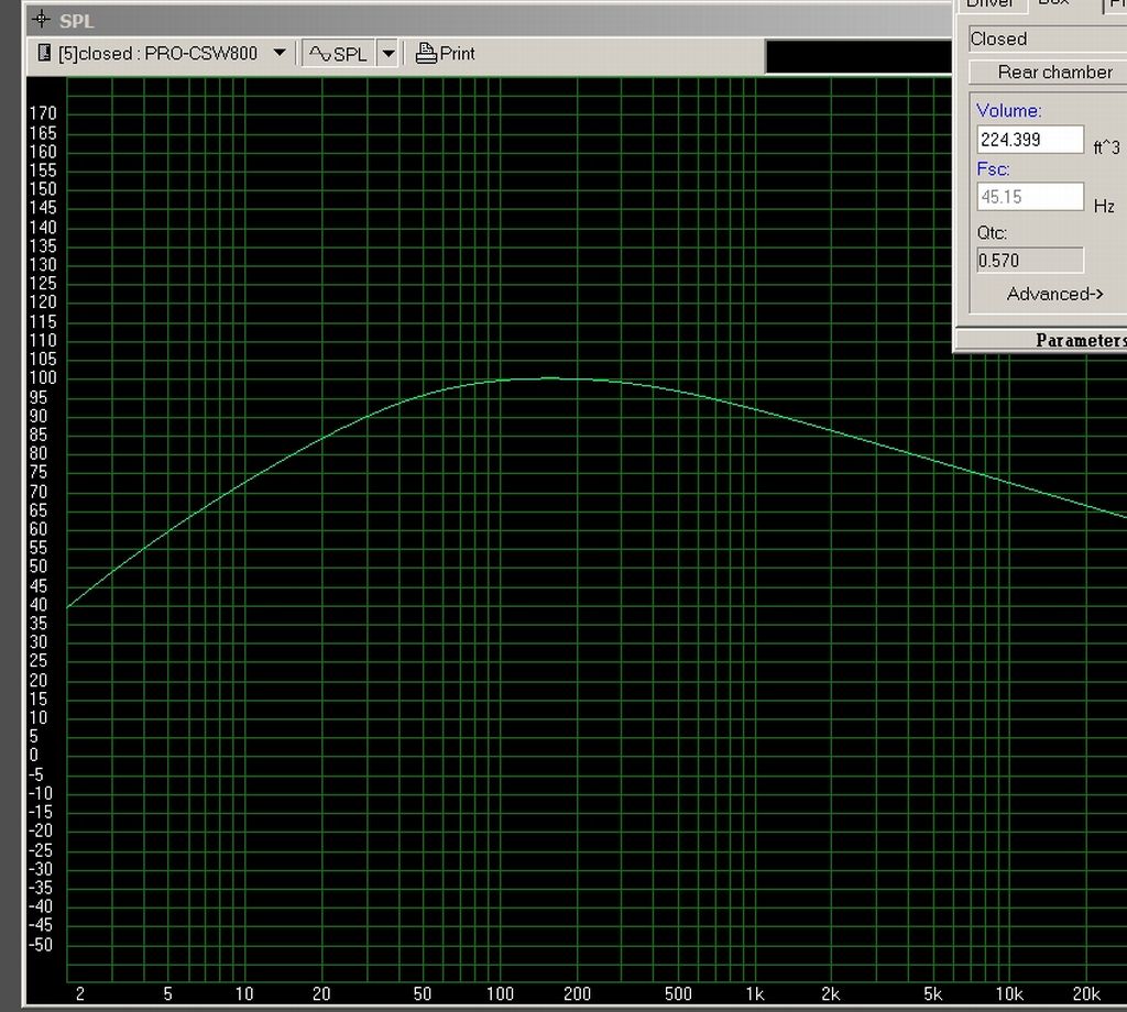

Note, That at 25hz, This is at an Xmax of .4025" for three drivers according to Winlsd.
So I would think that 6 X 8" per side should easily get you to your 110db goal.
The woofer that I have are the Optimus PRO-CSW800 and MTX had a woofer with nearly the exact same specs.

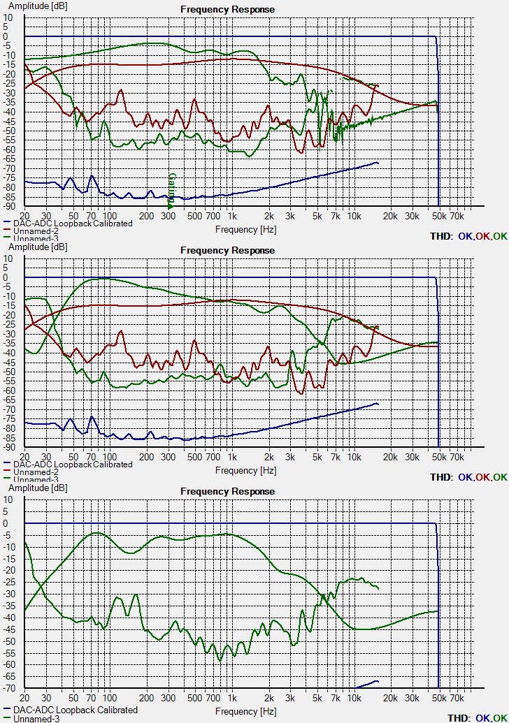

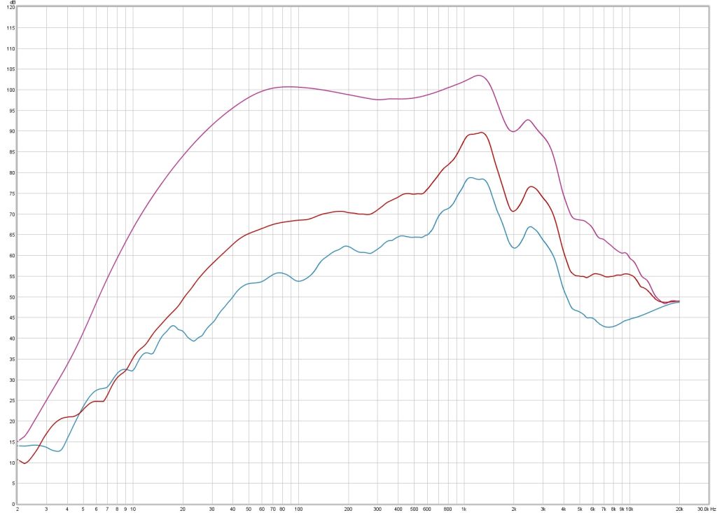

Right now I have 4 X 10" and 4 X 12" (in regular speaker boxes) and I can get a comfortable 109db at 14' away ( my listening point ) in a room of 11' X 18.5' X 8' with my 500 watt per channel amp.
This is at a clean level but I have not measured the exact amount of power it takes though.
I do measure about 119db standing about 2 feet from the front of the stack on one side.
I hope this give you a good Idea of what it takes to reach these kind levels.
In this room I get a very comfortable full sounding loudness of 105db with very low distortion all around the room.
It is very hard to measure the THD due to the reflections in the room but this system typically shows below .5% across its bandwidth and only about a maximum of 2% to 5% in below about 60hz.
The low THD is the benefit from using so many drivers.

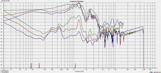

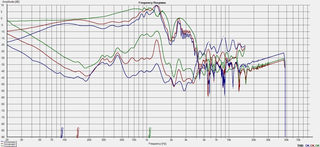

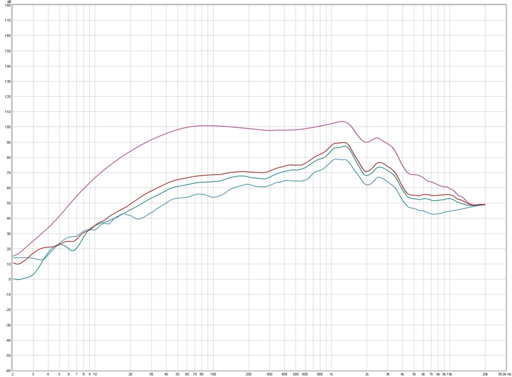

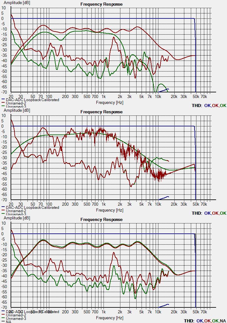

I may have already posted these but here are a few samples.
Some of these are with no midranges or tweeters and is where I am at right now. he,he
Enjoy !!

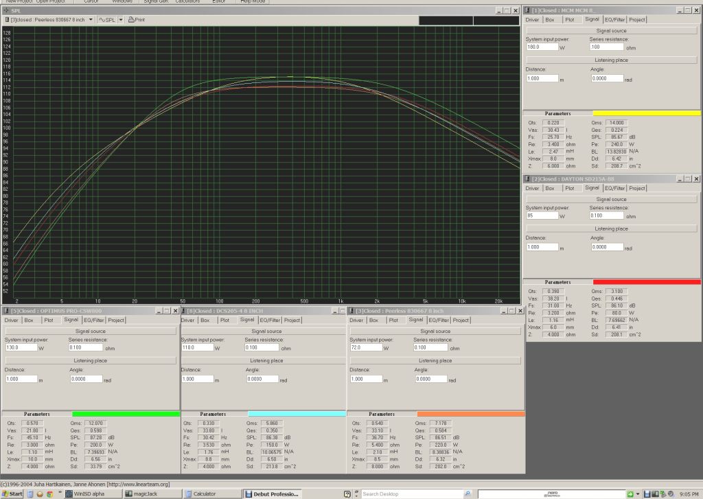

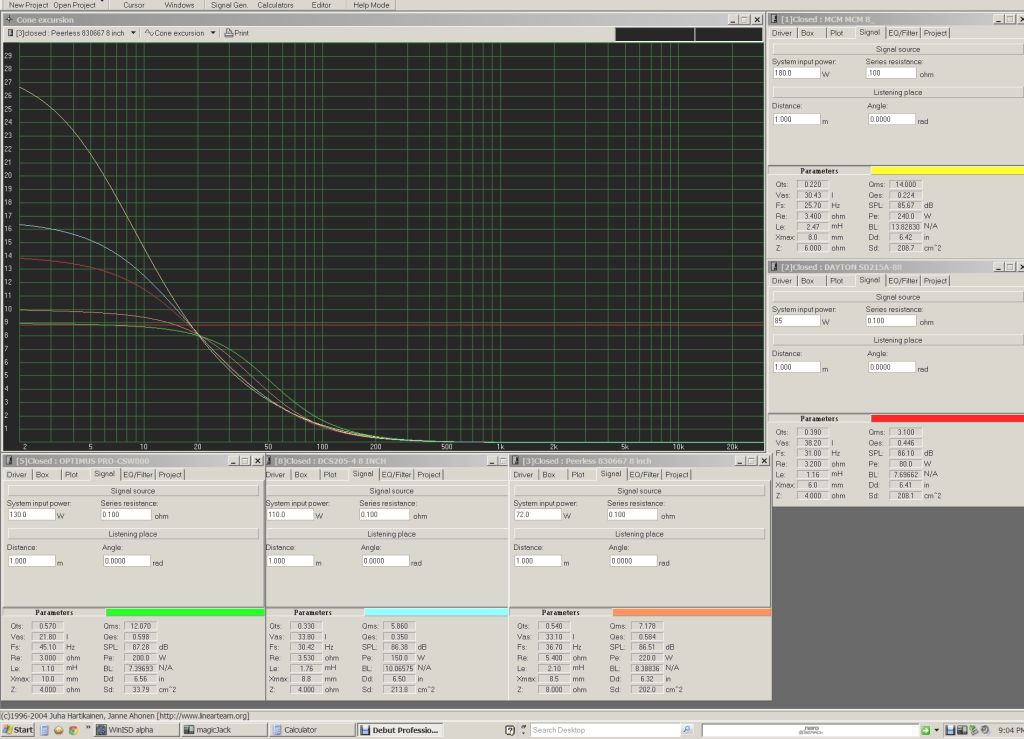

This is the one I had in mind,
MCM Audio Select 8'' High Excursion Woofer - 120W RMS 4ohm | 55-2421 (552421) | MCM Audio Select
It is similar to my woofer In fact I like its specs better than mine.
It has a nice low Fs of 25.7Hz and a Qts of .22 and a High Qms at 14 but I think that is what you want for a dipole sub system.
But don't quote me on this as I forget right now what is supposed to be good and it always seems to be a very highly debatable subject.
But they look pretty good to me and would be my choice to try out.
But simulated it in Winlsd first I am not sure if the specs are correct the Qts and Qes seem kind of low this is typical of off brand driver specs.

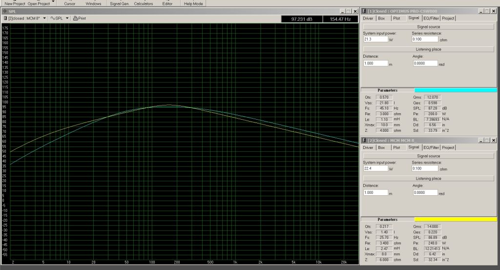

Well like I said I am not sure what to look for,for dipole system as I will have to do some re-reading.

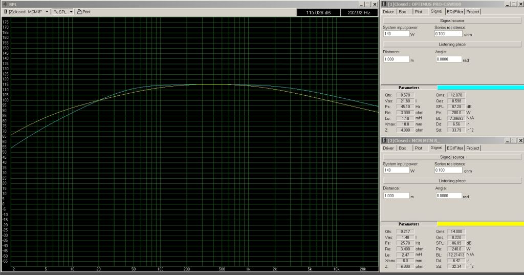

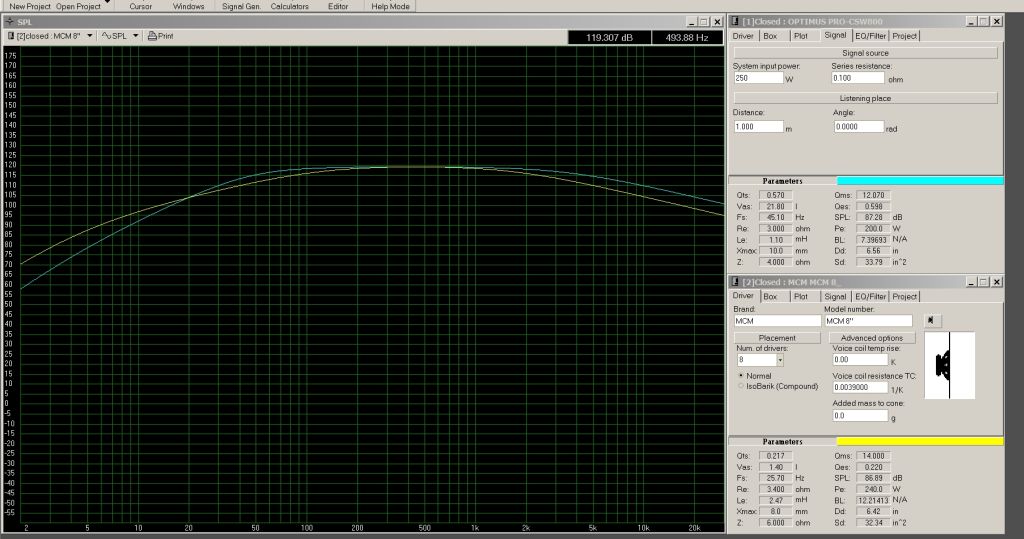

If you sim the MCM driver in Winlsd it doesn't look like alot but if you put 6 of them in a sealed 6 cu.ft. box they really start to shine.
You can put a Linkwitz transform filter on them to make them flat to 20hz,but they quickly run out of Xmax at 30hz and 37.4 watts.
But it is still producing 108.5db flat with -1db at 30Hz on up.
And with out the filter 119db at 432.4 watts.
This is only 72watts per driver and they are rated at 120watts rms/240peak so I don't for see any issues there.
That is still 104.6 at 20hz and 110.25 at 30hz.
Added another 6db to that for two cabinets.

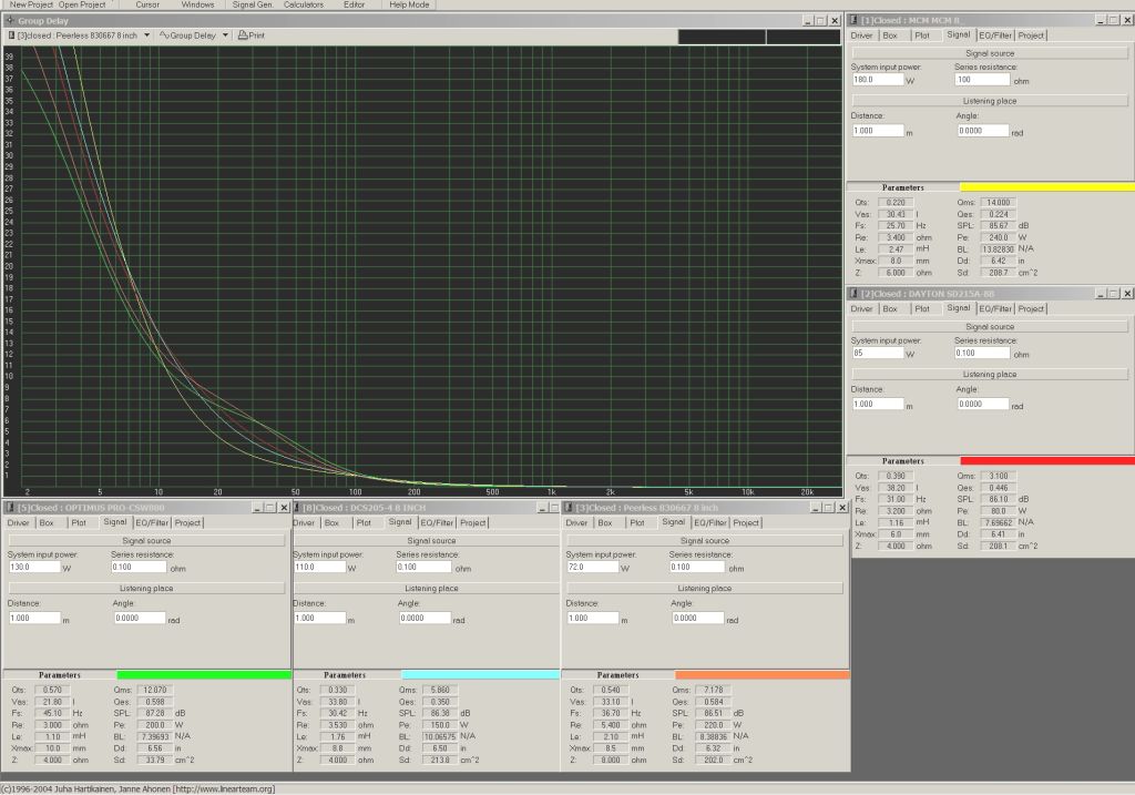

It is the group delay that you want to watch in order to keep the bass from getting muddy sounding or as some say, Slow.
Also when looking at the simulation you have to keep in mind that the low end droop in the response curve is going to be more flat due to room gain as well.
Depending on the size of the room this can be anywhere from 3db to as much as 12db.

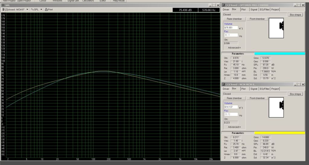

I have read in order to simulate a dipole in Winlsd is to use a very large closed box.
I am not sure how accurate this is but it does make sense.
As the box gets larger the effects of the pressure built up inside the the box has a lesser effect on the driver thus flattening out the response curve to a certain point showing just the effects of the driver parameters them selves,then the sensitivity appears to drop past that.

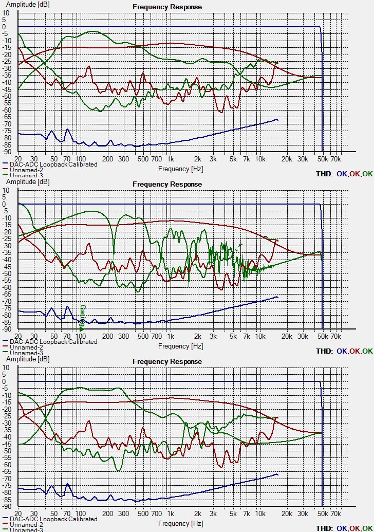

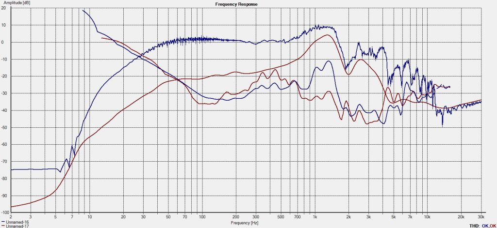

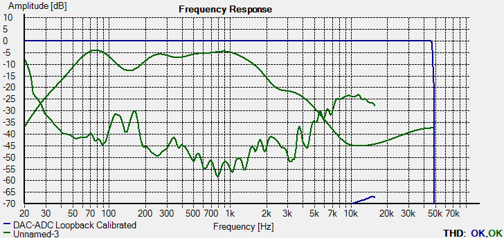

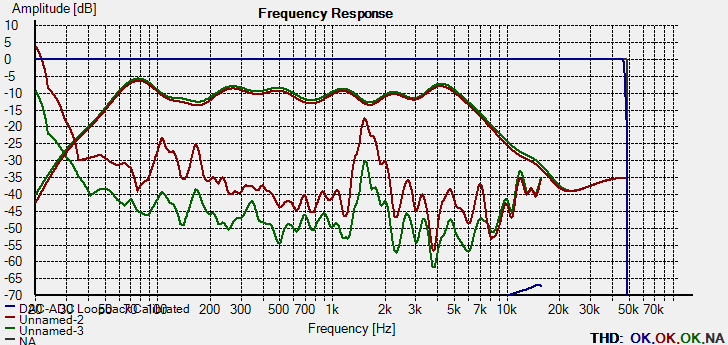

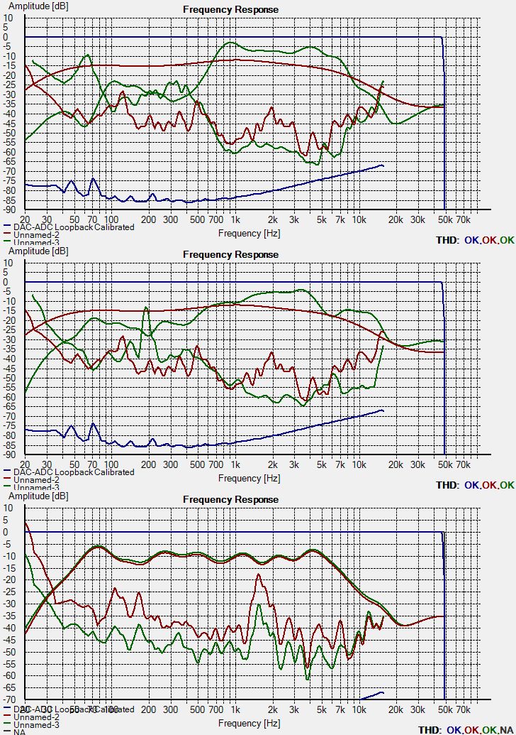

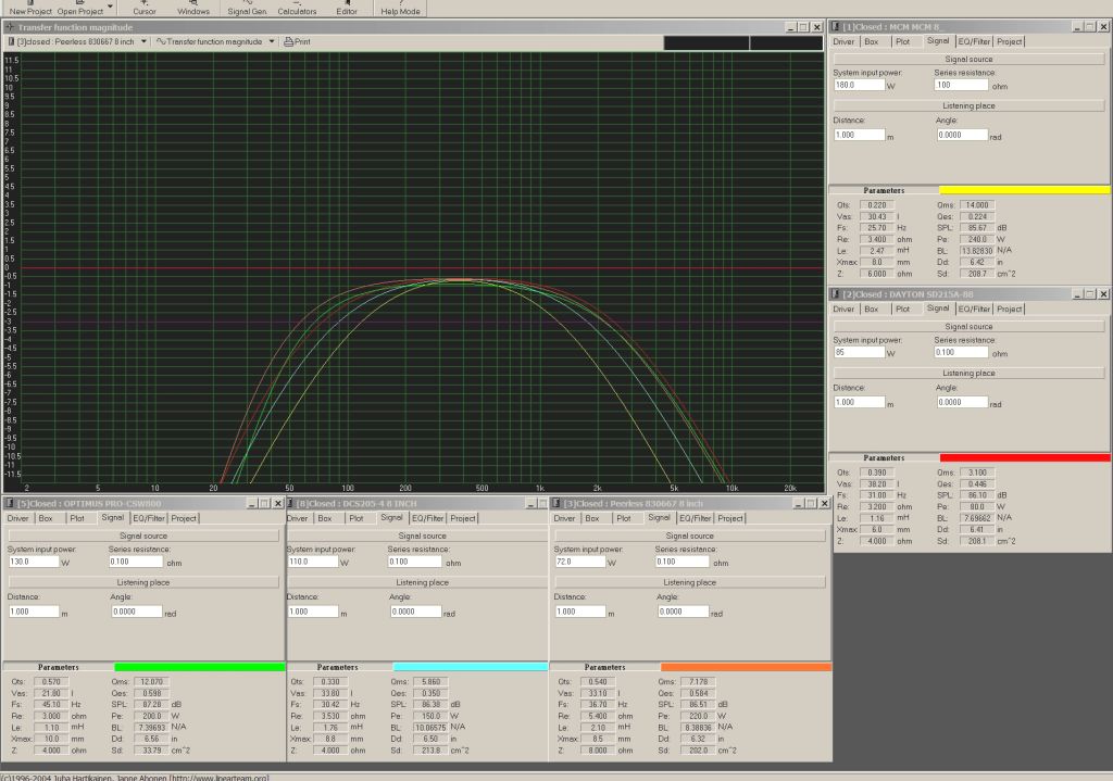

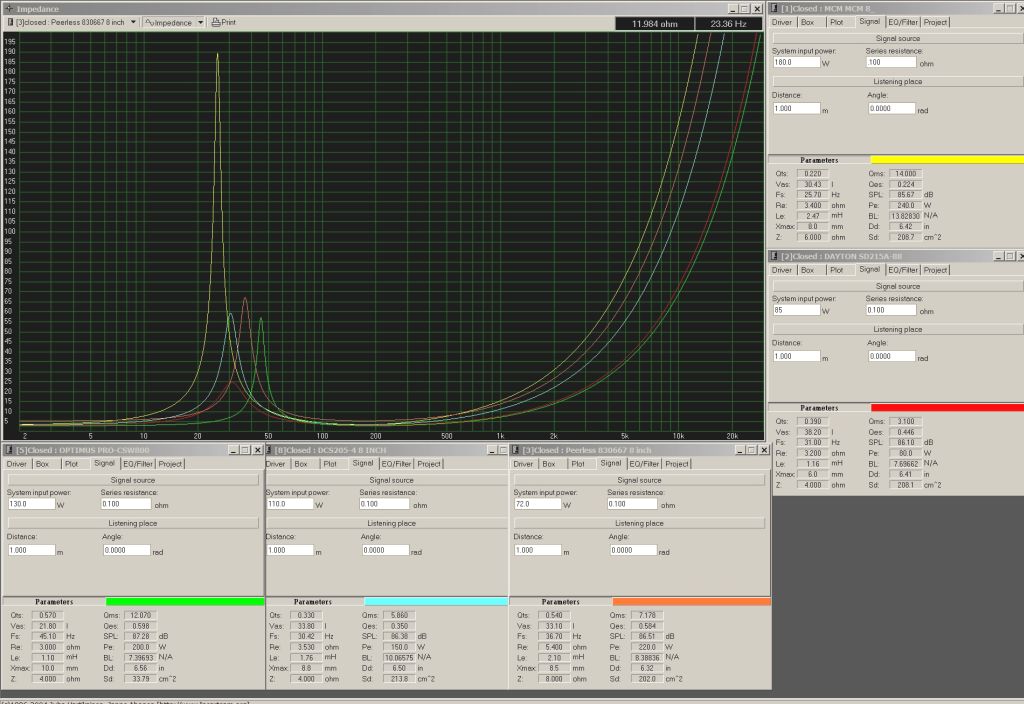

I was messin' around with Winlsd today and decided to compare it to some real world test of my RS 8" subs.
First I did some tests on the boxes that I had made for them and as expected I had terrible results.
So I won't bother posting those curves until maybe at a later time just to show the effects of the rise of THD from using a much smaller box.
The THD was quite high and the boxes rattled very badly as they did the last time I tried to test them.
But they did very well for there intended application and that was behind the backseat of my 84 Camaro where there was lots of cabin gain back in 2004.
In these tests I choose to use a open free air method.
These where done in my listening room and if the weather was better I would have done these outside to eliminate any effects from the room.
But they weren't loud enough to have any serious results in the data anyhow.
I used HolmImpulse and REW V5 for these tests with a Dayton measurement Microphone.
The HolmImpulse program shows the THD and frequency response curves at two distances.
One flush to the driver and one at a distance of about .5 meters ( I think as I forgot to note this and the charts show that it may have been closer).
It is sometimes hard to juggle the calibration between the the two programs as they are different but the data usually comes out the same between them.
The REW V5 plots were calibrated to my SPL meter and four measurements were taken with one flush to the driver, and, the rest about 12", .5 meter and 1 meter away from the driver.
Once I had gotten the graph limits set properly I had printed them all out to compare. I was quite amazed to find that when I superimposed one on top the the Winlsd simulation I had found that it was very spot on!
With very little differences in the curve.
The 20Hz point and the 60hz point nearly exactly lined up within only a few percent's of difference.
The only discrepancy in comparing the data was that with the simulation, as you decrease the box size past where the curve doesn't change any more the Spl starts to drop.
So, I readjusted the signal level to 30watts in the simulation to compensate for this and to match the REW V5 plot at 100db spl.
In the real world test I had measured 1.9Vrms and for the 4 ohm driver this is .9 watts rms.
As I had mentioned that the db scale in the REW V5 plots were calibrated so they show the true real world Spl of the tests.
Thd curves show to be pretty decent and If had done this outside like I wanted to that measurement might have come out a lot better.
Also I didn't have a scope hooked up to check for any clipping or deformities of the waveform at the lowest frequency's.
I will do this at a later time.
Generally I can't hear much of difference of the 10% THD that low.
But, It is good to be able to measure it though any how!
What I can hear is the huffing of the air as it moves through the vent holes and this can be annoying at times but generally not heard when playing music as it is only noticeable at about 30Hz to 20Hz and below.
enjoy !!!
jer :)

So now that I have convinced my self of the accuracy of Winlsd I did a few more simulations using the MCM 8" sub compared to my RS 8" sub.
Even though these were meant to be for a dipole configuration Winlsd still depicts them as a closed box.
The results were very impressive besides.
The first plot was each type of single driver at one watt of signal input.
The second plot is the same but for a maximum Xmax setting at 20hz about 22 watts of signal input.
The third is for 6 drivers with xmax of 8.5mm at 20hz at 140 watts input.
And, The fourth is for 8 drivers at an xmax of 9.7mm at 20hz (8mm at 30hz) with 250 watts rms input.
This shows why I like these drivers for the money.
But, I have not tried one yet so I would get a few of them to try out first before getting a bunch of them.
But so far the do look very promising especially for a closed box type system if they turn out to be to noisey for a dipole setup.
Remember to added another 6db to this for stereo and they still should only be -6db shy from the maximum in these plots and that would be about 110db Spl.
Not to mention that room gain may make up the difference as well.
Knowing what my past experience was with my 6 X 6.5" open back cabinet, 12 to 16 of these drivers will fill a room quite nicely even in a dipole setup or open back line array.
I did a little calculation using surface area alone using my system, and my system is about the equivelant to 15 X 8" drivers and my Spl's seem to coincide with the data in the simulations.
My 10" and 12" drivers don't have anywhere the xmax that these things have.
When I got my drivers I almost got 12 to 16 of them for the soul purpose of trying a dipole system.
But I ended up with 8 and I burned one up by accident last year trying to test it, and, another one I dropped the day a brought them home trying to carry the stack in.
It had bent the frame and the voice coil is rubbing on the magnet,it sucks but things happen.
There is a chance that I could fix it but I am now down one driver so I now have six.
After todays measurements I am seriously think of just sticking with a dipole setup with my remaining six 8"er's and use them nearfield in front of my mixer just because of the lower THD and sound quality.
As my main system is for completely rockin out and it does that job very well indeed !!
At least they will hold me over until I can get some newer and higher quality drivers.
I will do some checking in the dipole spread sheets as well as comparing to the peerless driver.
Peerless drivers are very good quality and so are the Daytons so I will take a closer look at those too.
More later !!!
:cheers:
jer :)

Thats cool, markusA,
I had been doing some more more sims today and I had some very interesting results.
I won't go into great detail,but here is what I have.
My Optimus driver has nearly the exact same specs as the peerless driver only has a 4 ohm voice coil and 2mm more of xmax.
And it has nearly the same curve as well with the difference in level showing due to it being a 4 ohm drive instead of 8 ohms.
The daytons look very good as well.
In all of these sims I used a 550 cu.ft. box and set the power levels for a 8 mm xmax at 20hz for 6 drivers.
The all look very good But to me the MCM driver seemed to be the best one for the money and had the highest output as well as a smoother low end roll off.
One of the dayton's only has an xmax of 6 mm but I set them all to 8mm's in the sim.
Then I got to thinking how the peerless even looks the same as the RS sub except for the gold spring loaded push connectors that are on the RS sub.
So, I did a free air THD test at three levels.
I didn't note any voltage levels but the highest one was near its xmax if not more.
Now they may look kind high but in reality the aren't bad at all.
The curves are the bottom of the HOLMimpulse chart are the THD curves and are in db's so here is a link to convert them,
THD to dB - convert percent to decibels dB and dB decibels to percentage percent voltage % vs per cent converter THD+N distortions calculation signal distortion factor attenuation in dB to distortion factor k in percent decibel damping - sengpielaudi
The sad thing is that you can never get those figures any where unless somebody tests them and posts them and this is where the risk of buying drivers comes in.
Zaph Audio has done this for a few of the well known drivers and a quite few from dayton as well.
If the manufacture's stated their THD's in there data sheets they probably wouldn't sell any drivers at all. he,he,he.
If the peerless is any thing like the RS driver then I would say that it is a little pricey.
These are the highest xmax drivers for an 8" that I could find.
The next possible step are the Bazooka 10"'s that parts express has for a very nice price.
And then there is the 12's but the displacement per cost factor now starts to sky rocket as I am assuming that you want to go with a dipole bass system.
I have not yet tried a TL type enclosure yet, but I plan to do so this summer as well with my 8's just to see if it is really all that people say that they are.
Anyway here are todays charts and I will start scoping out some 6.5"er's.
:cheers:
jer :)
