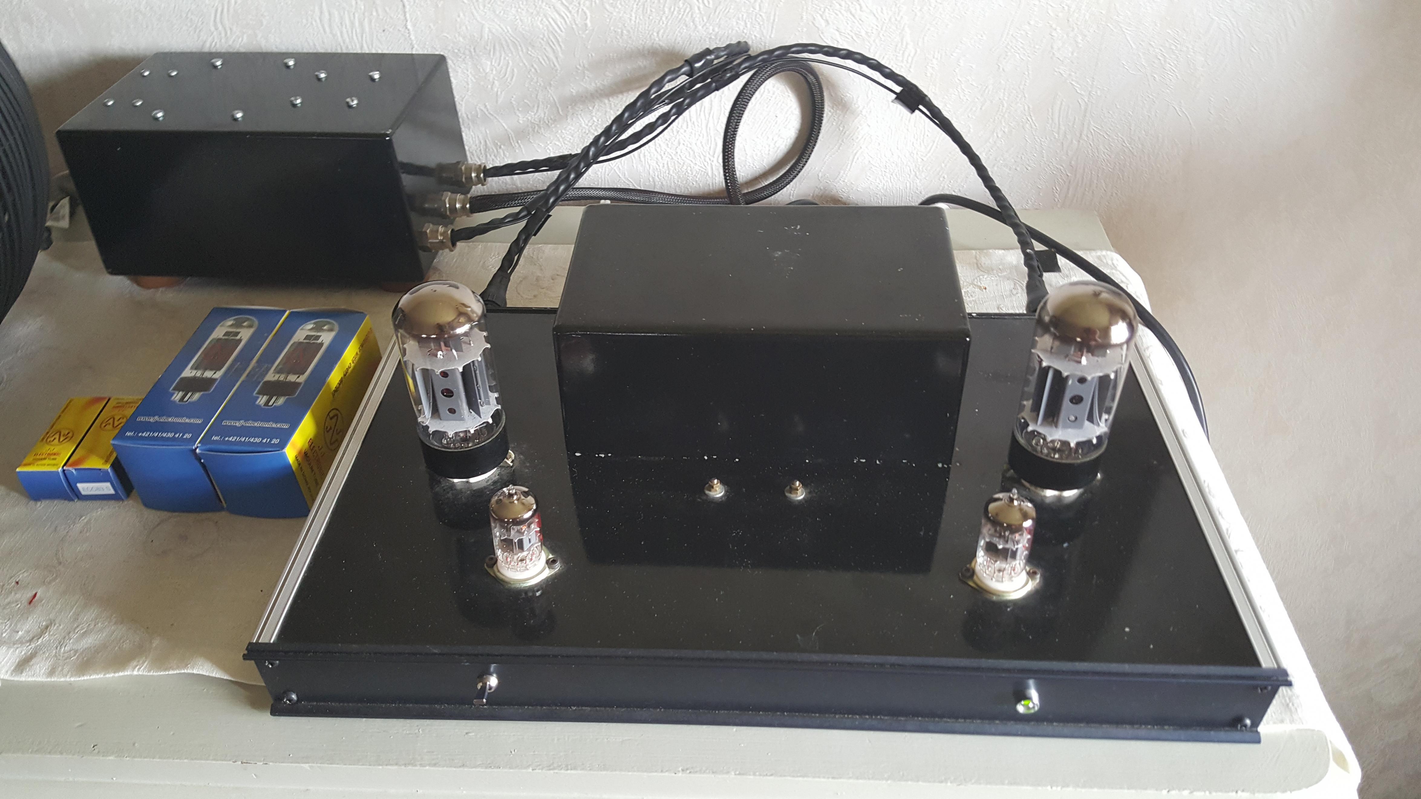

This is one of my recent amps SE 6550 12ax7 with Lundahl trafos both in and out with separate powersupply. Works fine but needs high sensivity speakers like horns.. so please suggest new projects.
Can you show the schematic of this ?
I don have a schematic. I have looked around and figured out a design. Mostly its a design by Lars Ohlsson also called RimboLasse. I can make a schematic if you like?
but anyway i still look for a schematic that performs well and have a nice wery good sound. Im really struggling to find a good highend schematic.
