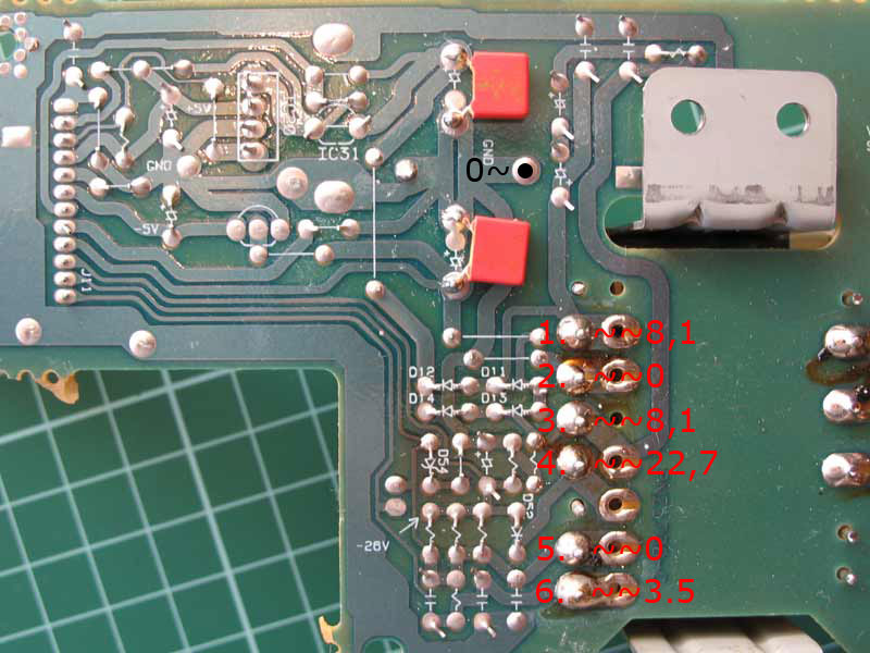

I have put this question on the beginning of the thread but the debate went in other direction and left it unanswered. We covered the rectification, diodes, caps part, mostly. I did not get an clear opinion about what to do with the trafos. I have read that putting the bigger trafo can help a lot. Since my CDP has really small trafo feeding everything, I have done some thinking and came to conclusion that it might be good idea to cut off leads of existing trafo-marked 1,2,3 - leave in in place to feed the rest. In the place of removed introduce power from the new separate toroid transformer.
- the questions are:
1. Should I even bother with this - is it worth the money/time?
2. If yes - Do I read the measurements right- I need 8 V secondary(or should it be 9V?).
3. How big the new trafo should be?
I have done some measurement with the CDP in stand by mode as you can see in the attachment:
You could do worse! The pd906 I was modding was someone elses and there budget did not run to new transformers.....I'd think that you'd need about 50va tops, with the correct secondaries 8-0-8 which after rectification should be giving approx 12vdc supply.

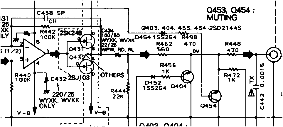

in my attached image
- you can see the 1/2 4558 OP amplifier
- output cap C434, in my player was 100uF/50V elyt :whazzat:
- and all the muting junk they have added, before the Line Out RCA jacks
by the way, in my PD-S504
the headphone amplifier, if we do even want to call it this
was a small dual..!! older model op-amp, with gain=1 ( buffer )
:bawling:
think it is the same as can be seen in that service manual for PD-S505

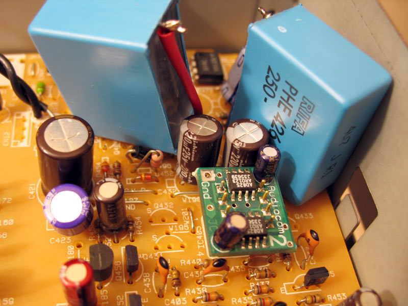

I first swapped NJM4558 with AD826 - much better. It was hard to tell how much improvement was to OpAmp alone because I did it at the same time I cut out the muting. Then I have tried AD825 on Audiocom adapter (I have from before), for some days now and compared it to AD826. Despite I thought it should be just single version of AD826 it somehow menages to beat it. Initially I thought it was because it was new and not properly broken in but the audible margin is still there.
Today I was busy:smash: as you can see in the attachment. I have done some big caps bypassing and CHANGED OUTPUT CAPS. I had a pair of EVOX-RIFA 4.7uF caps hanging around and thought to give them a try. I had no chance to listen to it yet. I have forget to measure the offset before the change but now it measures 0,5mV. Is it OK?!?!

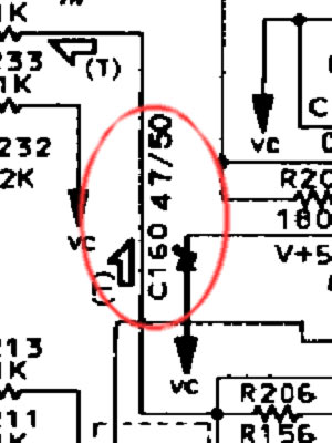

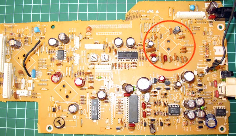

Today I have come to strange finding.
I looked to schematics serching for possible good place to use spare 47uF Oscons. I found 3 places with 47uF in the schematics. I searched for them on the board itself and found that they are not 47 but 4.7!!!😱
Now I'm wondering is it the bad scan of scheme to blame for non visible dot or it actualy is 47uF supposed to be in those positions but by some fault they mounted 4.7?
WARNING!!!
I want to warn everybody who intends to use schematics that I gave link to in the beginning of this thread. Because of the bad quality of scan some details are lost. There are more more mistakes like the one I have shown in my last post! Many dots and commas are missing.
