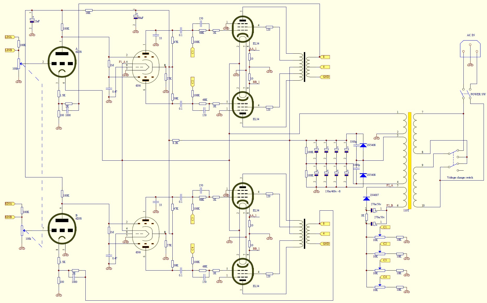

As for the third rec, I do have the schematic (or at least what is reported to be the schematic):
http://www.diyaudio.com/forums/atta...922573-new-suppo-audio-el34-amp-el34_6dj8.jpg
There was quite a bit of discussion/confusion/argument as to what tubes actually belonged in which slots. Lots of back and worth over what could be subbed for what. I did like the sound of the amp when it was working so maybe I should just try and rebuild what I've got P2P and see if I can't sort out some of the confusion. Any thoughts on the schematic as shown?

Easy way to test transformer turns ratio. Connect the transformer secondary 8 ohm and 0 volt taps to a low impedance transistor amplifier's output. Connect an FM tuner (if you don't have a signal generator) and tune between stations. Use the interstation noise as a signal. Turn the transistor amp up enough to get an even integer voltage (to make the calculation easy), say 1 or 2 volts. Once that is set and stable, measure the voltage from plate to plate leads on the transformer primary. Divide the plate-plate by the applied voltage at the secondary, and there is your turns ratio.
To get the primary impedance, multiply the speaker impedance by the square of the turns ratio. For instance, if you determine the turns ratio to be 20 to 1, and you are connecting an 8 ohm speaker to the 8 ohm tap, then 20 squared time 8 is 3.2k.
Be very careful when doing this. Observe proper live voltage working requirements, as you could generate serious and life threatening voltages on the plate-to-plate leads if you turn up that transistor amp a little too much.

I am very new to the world of tub amps and mod electronics but I have some difficulties with the schematic for one it appears the schematic show two 12AX7 tubes but mine only has one (and actually I am using a 12AT7). It also appears to be missing the 110 230 switch.

Spent some time this weekend looking over the schematic and reading up on electronic symbols. Realize now that the Scheme does show just one 12AX7 tube (same tube different pins). Also I opened up your link to the schemeatic and the 110 230 switch was clearly shown. I had opened a link to the other schematic from that thread which does not have the switch on it. Sorry for messing up your thread.
