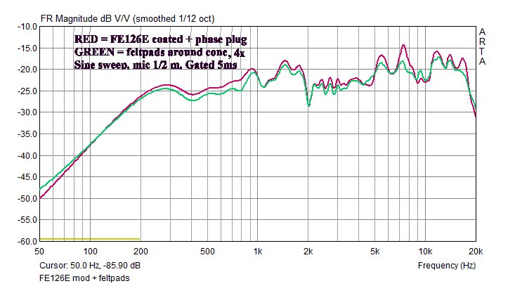

First let me say that I have not studied the EnABL process.
Some weeks ago I did however do some simple measurements of the Fostex FE-126e. This driver has some nasty peaks around 7 kHz.
First I compared a new driver with a coated driver: The coated driver is unanimously reported to sound considerably better than stock. It did however not show any noticeablel change in the measured response (at leat not at higher frequencies).
Based on hints from MarkMck regarding location of resonant modes, I tried to add small felt and cork pads around the perimeter of the driver, 10 mm from edge. This did show results. It seemed that many small pads were better than a few larger ones.
Attached is a measurement I saved. This is with only 4 felt pads. 8 small cork pads (10mm dia) were even better in flattening the HF peaks. I show this only as example of measurement. I did not have the time for a proper listening comparison.
NB: The coating, using ModPodge, is important before doing these experiments as it will allow self adhesive pads to be applied and removed without damaging the cone.

I wondn't really expect the mod-podge treatment to show up in the FR -- its job is to reduce cone self-noise....
In my mod the damar pattern is an attempt to help quell the resonances Mark pointed out... i know they aren't totally effective, because i can still see them in the impedance plot (i have to get a laptop assembled to put FR measure kit into place)... we are just about to go another round of experimenting on the cones, i'll give this a try.

The 2.7 kHz peak was bothering me the most. I tried the felt pads on the cone about 5/8" in from the edge. This did reduce the peak, but also tended to reduce the upper treble and I think it caused new dips and peaks. I did not want to lose the upper treble so I removed the felt pads. I got a large piece of some heavy felt, about 1/2" thick, and cut a hole for the driver with triangles that projected past the point where this 2.7 kHz resonance came off the cone. I taped this to the speaker baffle. It looks a lot like what Bert Doppenberg did on one of his speakers. If you go to http://www.t-linespeakers.org/FALL/bd-pipes.html and then go down 1 screen you will see what this looks like. It sounded horrible. I reduced the BSC resistor to about half and it now sounds better than ever. The 2.7 kHz peak is gone. While it now sounded very good the 5kHz peak was much obvious. The 5kHz peak seems to come from a resonance well down the cone. I tried the "98 cent tweak", speaker stuffing wrapped between the whizzer and the cone, and this calmed it down some. I have to take better measurements and refine these but hopefully this may be of some help.
