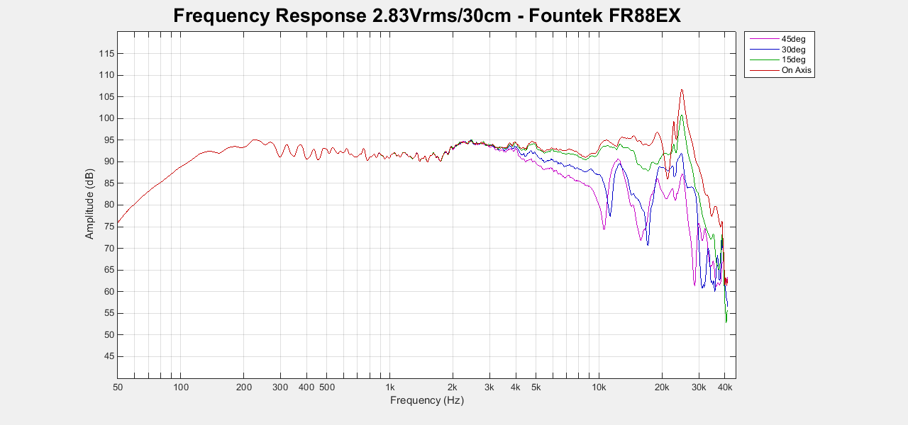

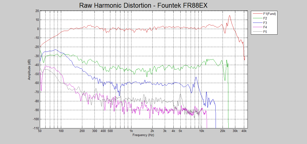

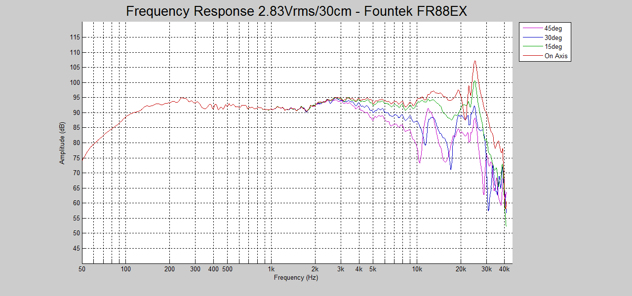

Unless the 4" is very extended on-axis (flat to near 20 kHz) you will likely be "looking" at a more complex filter than what I've suggested: more complex filter = more components in the signal path.
88 db at 2 meters, no problem for even the Fountek 3" provided it's loaded (good enclosure) properly and bandwidth dependent.

Got it! I think a piece of 4” PVC pipe cut to length of the estimated depth of the enclosure should do it. This test config should be relatively easy so i’ll add a strip to the bottom so it sits well on the mixer bridge where I intent to put them. I’m subsribed to SONARWORKS anyways so i’ll let it have a go on them as well.
Now to pick the candidates and start ordering. Hopefully there’s enough interest in the used market for the drivers that don’t make the cut or this project will get expensive! LOL
The Fountek FR88 and Dayton RS100P are gonna get the first go round. I’ll wait for suggestions for other candidates......get the aluminum favorite out front first.....not sure if I can work with an aluminum mid......NOT something you see often in professional monitors.
