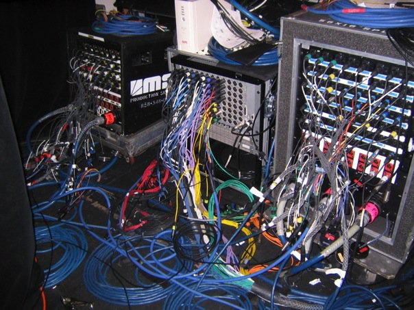

I’d be inclined towards as few separate boxes and interconnections as possible for a mobile PA system.

While I have no need or desire to emulate such a system, nor could I ever be accused of being a Bose apologist, I’ll repeat my earlier assertion that even with a design goal requiring far less dispersion flexibility than the F1 & sub combo, the modularity and integrated EQ/active amplification is key to its efficacy.
No matter the extent or choice of drivers selected, I’d keep that in mind. One or two signal cables from your source, and power cables for the on-board amps seems to me to be an elegant answer to the load in / out question.
That's the plan! My Mackie DR32 feeding a pair of Behringer iNukes with DSP or similar and some 18" subs. In ear monitors and a tactile drum throne get the job done.......and iPad of course! Lola
