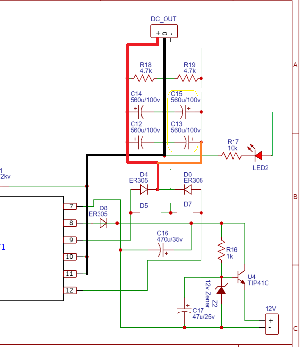

so, here's the smps.
and this is the schematic of the smps that i reverse engineered and drawn on easyeda.
Before i proceed with my plan, i need an input on the schematic.
is it right/correct? is there anything that i got it wrong?
Thanks.

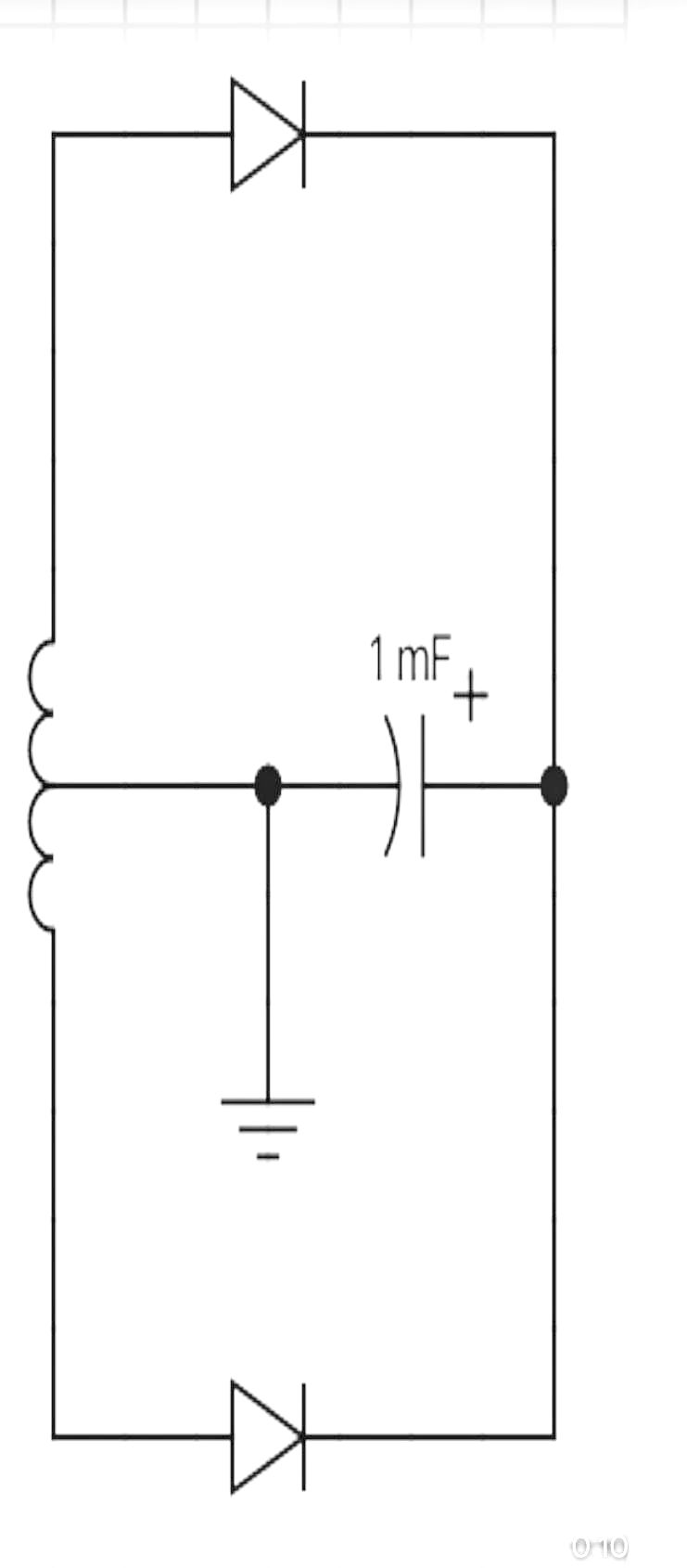

Hey bro, you can convert dual rail to single rail output with this step :
1. remove D5 and D7
2. reverse C13 and C15 polarity position (negative cap to ground 0)
3. make a jumper from positive C13 to positive C12

@greenocean
I already done the conversion from dual to single rail, it's not like what you suggested to me.
What I did was:
1. split the secondary winding center-tap, so now I have 2 windings.
2. put a bridge rectifier at each of the winding, 4 diodes per winding, so that's 8 diodes.
3. paralleled the output of the bridge rectifier and the reservoir capacitor.
I know with this setup the diode loss is doubled, but the current capabilities are increased because the previous setup and/or your suggested setup just utilizing 2 opposed phase half-wave that become a 1 full-wave.
The current setup utilize 4 half-wave, 2 of them are opposed phase, and the output is 2 full-wave paralleled, in theory this should increase current capabilities, at most double the current.
Now it runs cooler, previously the transformer temp is not that hot, warm to the touch, now, ice cold. And the voltage drop from diode loss isn't that bad either, it's just down .5v.
thanks for the reply though, I appreciate it.
