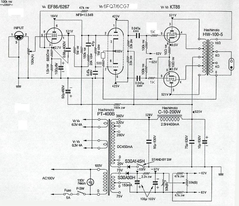

I want to build a high power amp. I have a 100watt 4.5k vintage transformer I want to put to good use. I have narrowed down my search to two amplifiers:

http://www.tube-amps.net/images/KT88_PP_01/KT88_Schematic.jpg
Which is a better designed amp? As in more stable (against oscillation) and rugged (can be pushed to its limits without burning up)?
Which tube can take more abuse the KT88 or 6550?
Let me know what you guys think of the designs?
I think 525V on the screens of ultralinear output tubes is excessive, even for KT88s/6550s. This is a problem with both. Reducing that to 450V would be a "safe" solution.
The first amp is a Williamson, so it may be prone to low frequency instability unless you make a few provisions with the coupling caps (I'd stagger the poles further than they are, by using .47uF for the first set and .1uF for the second set). Depending on the output transformer, it may also have high frequency stability issues, so you'd want a good scope and generator to work out proper compensation. The Williamson requires a VERY good output transformer, so if yours isn't known to have 10Hz-100kHz bandwidth and good high frequency behavior, I would hesitate to go this route.
The second amp is a Mullard design, and will be easier to stabilize. However, it will have more gain and noise than the Willy. Again, it will still require some feedback compensation if you want to do it right - so be prepared to get out a scope and generator.

Jon made what IMO is the crucial point. Williamson topology is vulnerable to instability. Go with the Mullard style circuitry.
As for getting the gain right, use a different small signal tube complement. The 12AT7 is head and shoulders above the 12AX7, in LTP service. Depending on drive signal level, choose a high gm linear triode as the voltage amplifier. Candidates (in order of increasing μ) include the 6FQ7, 12AV7, and 6GK5.
BTW, use a 10M45S CCS instead of a resistor in the tail of the LTP.

I would believe it may be worthwhile on a guitar amp, and even plausible with the right transformer. But on this amp the secondary is 380V, and the claimed output 529VDC... and you won't be able to achieve that with a half-wave rectifier.
I agree with the others about the instability of the Williamson.
I also agree that, in your second schematic, a 12AT7 would be a better tube to use than a 12AX7, although I don't see a 12AX7 in your schematic. I think Eli must have meant instead of the 12AU7? Trouble is, that will give a lot more gain, so a 6FQ7/6CG7 would be a better choice. You certainly should replace the 12AU7, which is not good tube to use here because of its non-linearity. As Eli says, use a CCS in the tail. If gain is too high, try removing the EF86 cathode bypass cap.
The 0.68uF EF86 screen bypass cap should be connected between screen and cathode, not screen and ground. The way it's shown in the schematic will cause positive FB.
Using a single diode to rectify HT makes no sense IMHO, whether it was meant to be drawn like that or not. Use a bridge rectifier.
The 6550s/KT88s should have screen stoppers/droppers of about 1k when used like this.
You could encounter problems setting the OP tubes' bias because, although there is a balance adjustment, there is no overall bias voltage adjustment.
The Williamson as drawn has NO power switch on the PS???????. There is no bleeders for the bias supply.......could be a safety issue, but I would bleed it SOME!
There is also no warm-up protocol, full B+ on turn-on, wouldn't have a chance to warm-up. Not good for longevity...short term perhaps.
Note the fuse at B+...it was added later after the schematic was drawn up.

ok I have redrawn based on your suggestions, please review.
I will make the necessary modifications to the power supply: lowering B+, time delay for B+ and full wave rectification.
