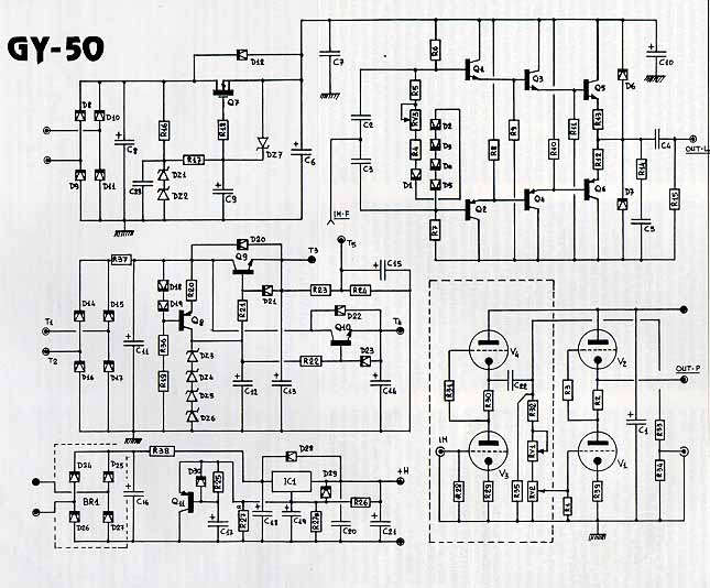

a hybrid amplifier could be the answer
You can build a very decent en not too expensive amp that has tubes at the front and transistors and the back end. I once build an Italian kit with good result. If you don't want the best of the best and don't want to put fire on your wrong speakers......

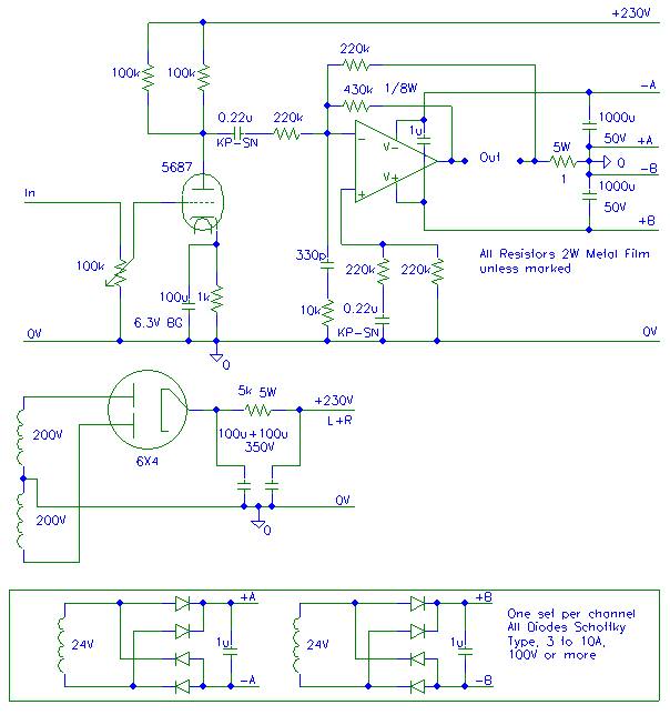

Wei thinggywotsit is quite wrong : the 437A is a very high transconductance triode , similar to the British 3A/167M but with a different base (magnoval, I beleive). As to how it sounds...I've never been able to afford one!
Konnichiwa,
Just to be sure, you are aware that all your "choices" will sound drastically different to each other?
And I hope you do not mind me saying that non of the choices you list strike me as having the potential for particulary good/outstanding sound either. Of the whole lot I'd probably choose the AN PSE Amp if I absolutely HAD TO CHOOSE one of these.
But even then I think you would be miles better of building a copy of the design by Simon Shilton (SJS) PSE Amp, this is easily adapted to PSE 300B, simply change Bias and +B Voltages to suit...
To make this schematic suitable to 300B's you simply add a moderate value Input Capacitor to the two +C Supplies, to bring the +B up to 350V under load, try 2u2 for starters. Equally a small value input Capacitor would likely be apropriate for the -B voltage to bring this up so 300B Valves can be biased correctly.
However, even the designer of the above prefers an amplifer much along the lines of my own preference, as shown below:
If you cannot find the WE 437A or think it too expensive, the E810F or E55L Triode wired works great too in the same circuit, maybe with a slight adjustment of the cathode resistor. Of course, now you are down to 8..10W Output Power.

Konnichiwa,
My bad, I meant TRIODE, but somehow wrote Pentode, as the discussion was about them. Anyway, my usual lysdexia.

Well, IF for arguments sake, you'd ask what I'd recommend as beginners Amp, hybrid and all, look at the attched. I think the resulting Amp would sound not halve bad.
Op-Amp chip of course National Semi LM3875 and yes, the whole shebang on the positive input can be replaced by a wire, if you are not worried about offset and the Amp may sound better that way. Also, you COULD return the positive input (with or without RC combo) to the 1 Ohm Resistor (negative speaker terminal) instead of ground, achieving thus not a positive output impedance of around 3R but a negative one of around 0.6 Ohm.
Or shortcircuit the 1 R resistor for a "low output impedance" option. One could fit a switch to select between -0.6R (return Op-Amp positive input to 1R resistor), appx. 0R (shortcircuit 1R), appx. 3R (schematic as shown) or appx. 6R5 (switch 1R to 2R2), depending upon speaker needs or listeners desires.
Sayonara
Konnichiwa,
Jaap said:For somebody starting with building amps and with the wrong speakers a hybrid amp could be the answer. What is your opinion on this one (GY 50). I build it as a starter some years ago and it was a satisfying experience, except that it uses PCB's which are not good for changing and experimenting after building.
