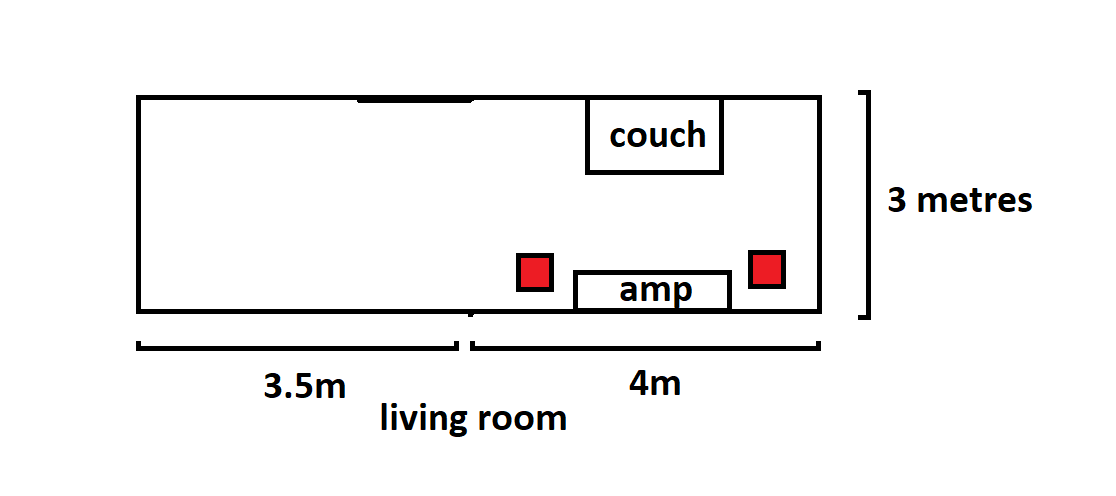

Hello people! I am planning on changing my speakers for a full range speaker setup.
I listen:
80% of time jazz (hard bop, bee bop, soul jazz, some vocal).
20% 70's, 80's rock, country rock.
My amplifier is a Single Ended KT88 tube amp. Approx. 3W RMS per channel.
I don't listen music very loud.
My current speakers are Monitor Audio Bronze BX2 (2011 series)
Specs says 90 db SPL efficient but can't really assure that.
I also have a Monitor Audio Silver W12 subwoofer.
My living room is like attached drawing.
I like my speakers but I really would like to get better detail and if I can, more volume using more efficient speakers,
so I can turn the amp volume down a little.
I thought about MarkAudio Alpair12p or perhaps a Fostex.
Would you suggest any?

10.3 or CHN110 would be much better than 12P i think. All are at about 88-89dB sensitive. Fostex claims more, but is overrated on sensivity. I run a CHN110 from a 7.5w amp in an MLTL and hardly go half open (with a logaritmic volume) so probally give 1 or 2 watt to the speaker at it's loudest. But small detailed fullrange drivers will never be very efficient i think. But it's more important to have a flat impendance (without peaks but on the sub frequencies) than a high sensivity. That makes it easier to driver for your amp.
On Fostex drivers i can't suggest, i first don't like those i heared, and i'm not very experienced with them. But know that sensivity is very often overrated on those. Tang Band can be good if you like the house sound of those drivers (not everybodies cup of tea).
If you really want high sensivity, a Fane 12-250TC can be good (and is 98dB sensitive in real life). But it does not have te detail or the finesse of those smaller drivers of Mark Audio.

Looking to stay with monitors on stands, or would a tower be ok?
As monitors, I made 40-ish liters vented boxes for the W8-1772, but they need at least two passive notches or EQ.
4" speakers in MLTL would be my other choice. The Faitals in a design like the TABAQ would give you more oomphs and clarity. Probably too much on top, so a strong BSC is usually applied.

Thank you for your suggestions. Will take a look at 10.3 datasheet.
I plan to stay with monitor, yes. For my current room I think its the best. I dont need to use MLTL. I would try to avoid BSC.

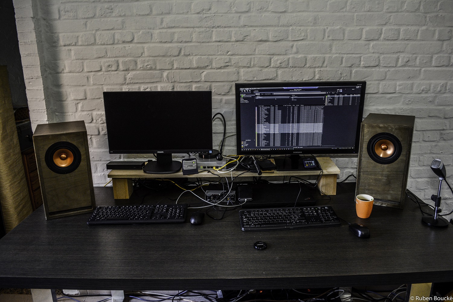

I can give you plans for a bookshelf with the 10.3 that i use in my office. It has a decent response to about 45hz in a fairly small package.
Dropbox - Mark-Audio-Alpair-10M-Slot-Ported-Official-CAD-drawings.pdf - Simplify your life
Simpler build (no need for rebates) are found on the site of frugalpile: http://p10hifi.net/FAL/downloads/CGR-MarKen103p-plan-040414.pdf
And on the site of Mark Audio you find more designs that are made by reputable people like Scotmoose (Woden Design) like this one: http://wodendesign.com/downloads/simpleReflex-103-10p-plan-100214.pdf

Thank you! Since this would be my first build I believe the later would be the easier..
I don’t know any driver that would not benefit from some kind of notch or bsc.
There are, but they are rare. The CHN110 is one like that, certainly in my MLTL. But mostly i agree on notch filters, not always on BSC as you can fix that in the crossover for multiway and most Mark Audio drivers have it build in the response for the typical builds they are used for. But sometimes it's needed.
I can standby waxx’s suggestion but it is worth noting that the metal cone MAs have a different voicing than the paper cones. I would suggest A10p as a better alternate to A12p but with simialr voicing.
The Fostex are typically not quite as sensitive as specified and it is the FFxx5wk drivers are best suited to your needs,
But the first thing i ntoiced was the small distance between couch and speakers. This often indicates a smaller driver.
A standmount might be better able to be placed, but any floorstanders take up no greater footprint, can typically stretch the bottom more and you don’t need stands.
I would consider A7ms of P7HD.
But i will say taht the CHN110 probably represents most bang for the buck. Needs a larger enclosure thou than the A10s or A11.

Do you think I would need one if I choose the MarkAudio 10.3?
Given you are going to be dealing with a fairly clsoe diatance to the back wll, an appropriate design would give a good marriage between room & speaker.
Someyhing like Poplar (A10.3/A10p) and Aspen (P11) so far, hug the wall floorstanders that are meant to integrate with the wall/room.
The series ill epand to other drivers as requests come in. I can esily see 11ms/CHN110/CHR90/120 versions.

Seeing that you have a subwoofer already, I think what would work well is a high sensitivity 3" or 4" in a few liter sealed cabinet to match your 3W amp. The sealed cabinet cut down excursion at low frequencies. One suggestion could be Faitalpro 3Fe22. Will work well in a 1 or 2 liter box. Adding a capacitor in series would cut down the low end bass even more. They will cross at about 100Hz.
Alternatively I would also consider a 2 way minidsp as your DAC and you can have lots of fun tweaking the frequency response to your need.
