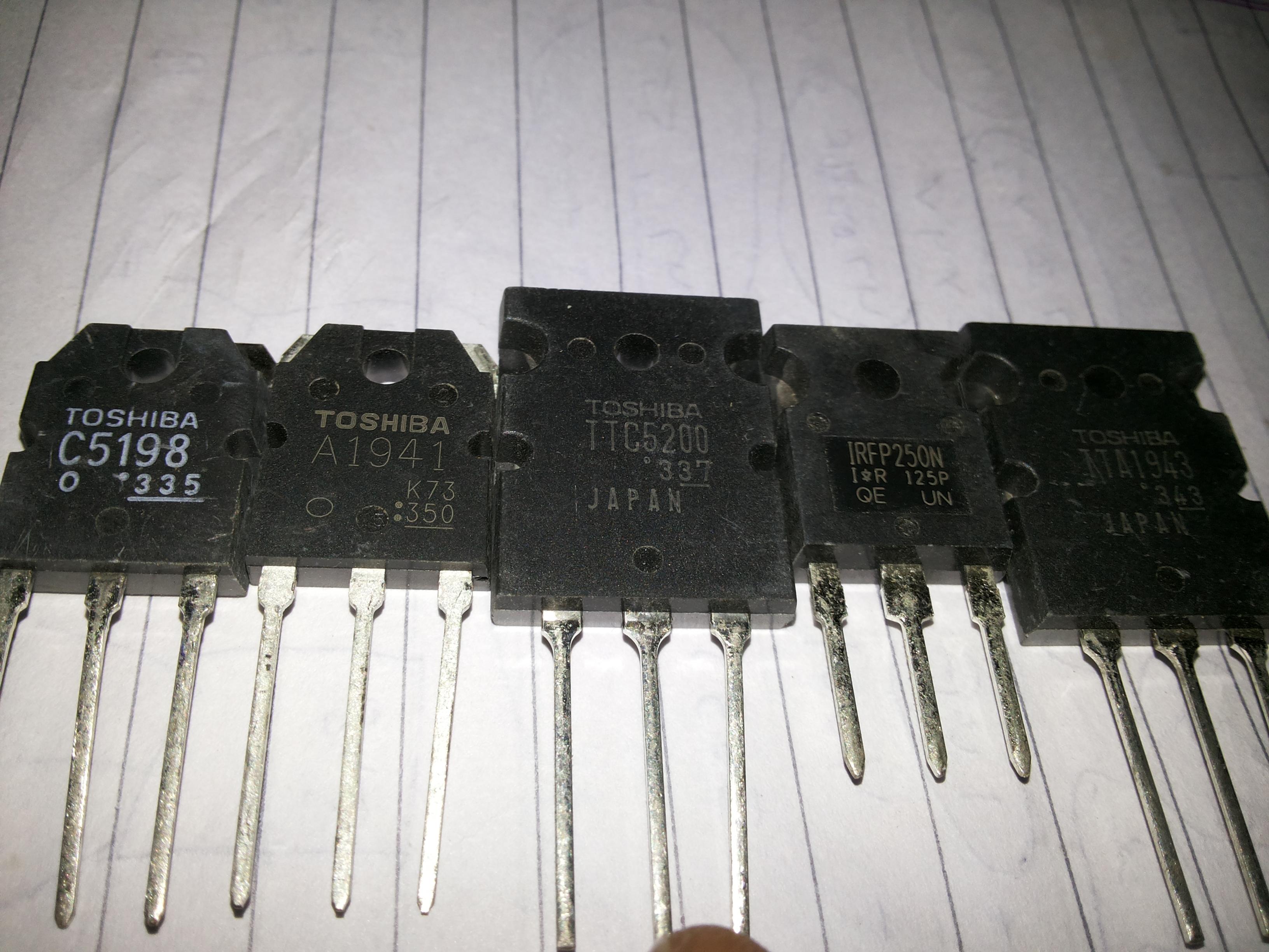

whats the substitute for 2n3773 and 2sc4793 and 2sa1837 as I don't have them. I have couple of TTC5200, TTA1943, irfp250n, A1941, C5198 and Z44 mosfet, bd139, bd140, bc548, bc558, 5401, s9015, s9014, 5551, a1013, a1015 etc

Ofcourse i will help you.but first make a dicision what you really want.thats good if you have 5200/1943 and 2sc4793 and 2sa1837.you can get really good amp from them.but you need more serious transformer.You can use 5200/1943 instead 2n3055 and they are much better .
12-0-12 is ok but not enough.When you are ready tell me compnents then i will send new cicuit.
2n5401/2n5551 and TTC5200/TTA1493 and 2sc4793/2sa1837 are best and cheapest transistors for amp.How many you have them?

I presume you are a newbie in amp making. forget the first 3055 circuit. that is nothing but trash. with a single 12V supply, the max output you can get is around 5-7W. find some good split supply stuff. TTC5200/TTA1493 is a good output pair. remember, for more output power you always require more voltage and more pairs of output transistors. again, a good layout is a must for hum free distortion free working of amps. do some reserch in the net and have fun making amps.

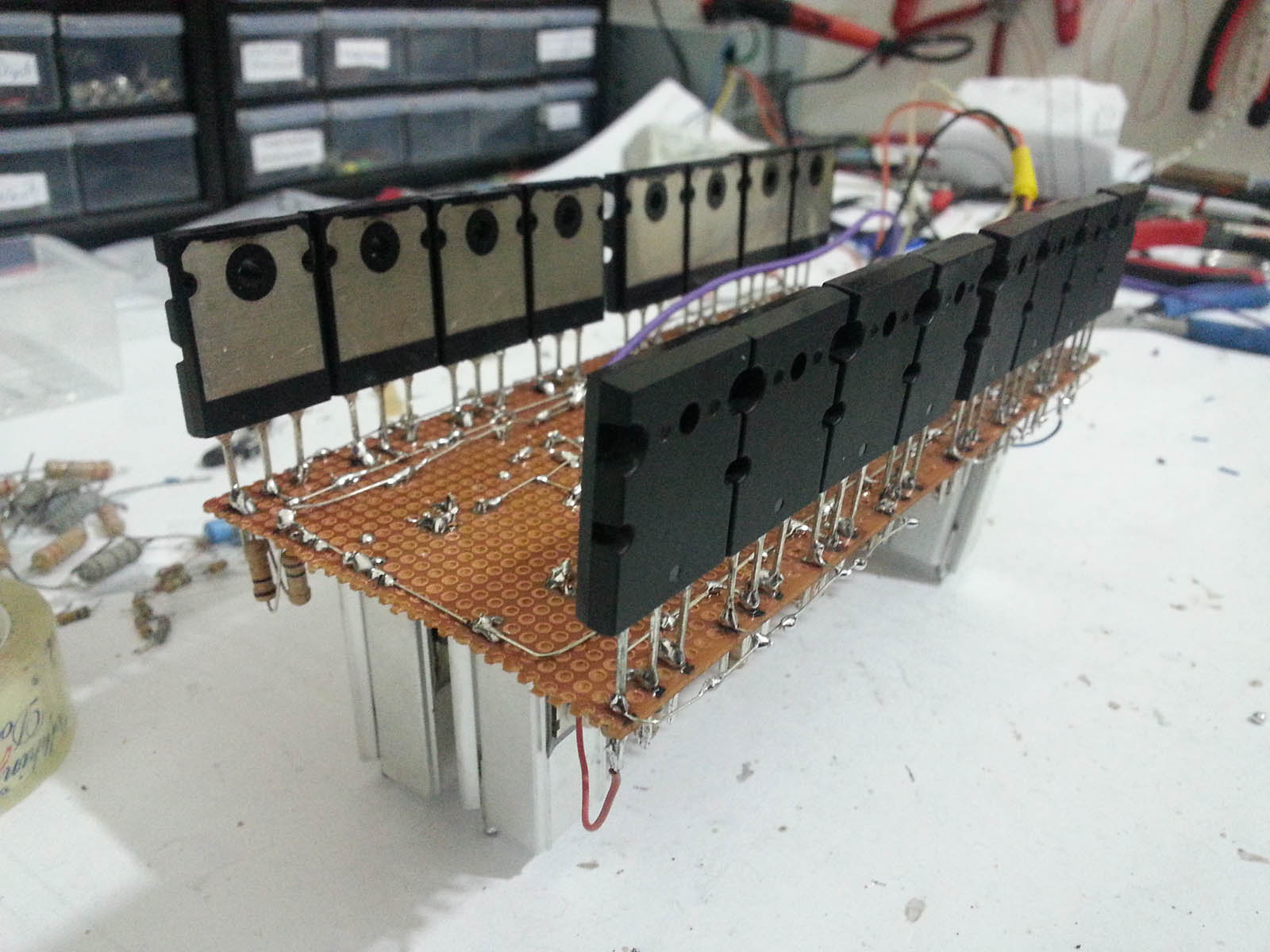

hello friends after attending 4 wedding parties I am here again.. will soon update which project I am going to start.. hopefully ax6...
