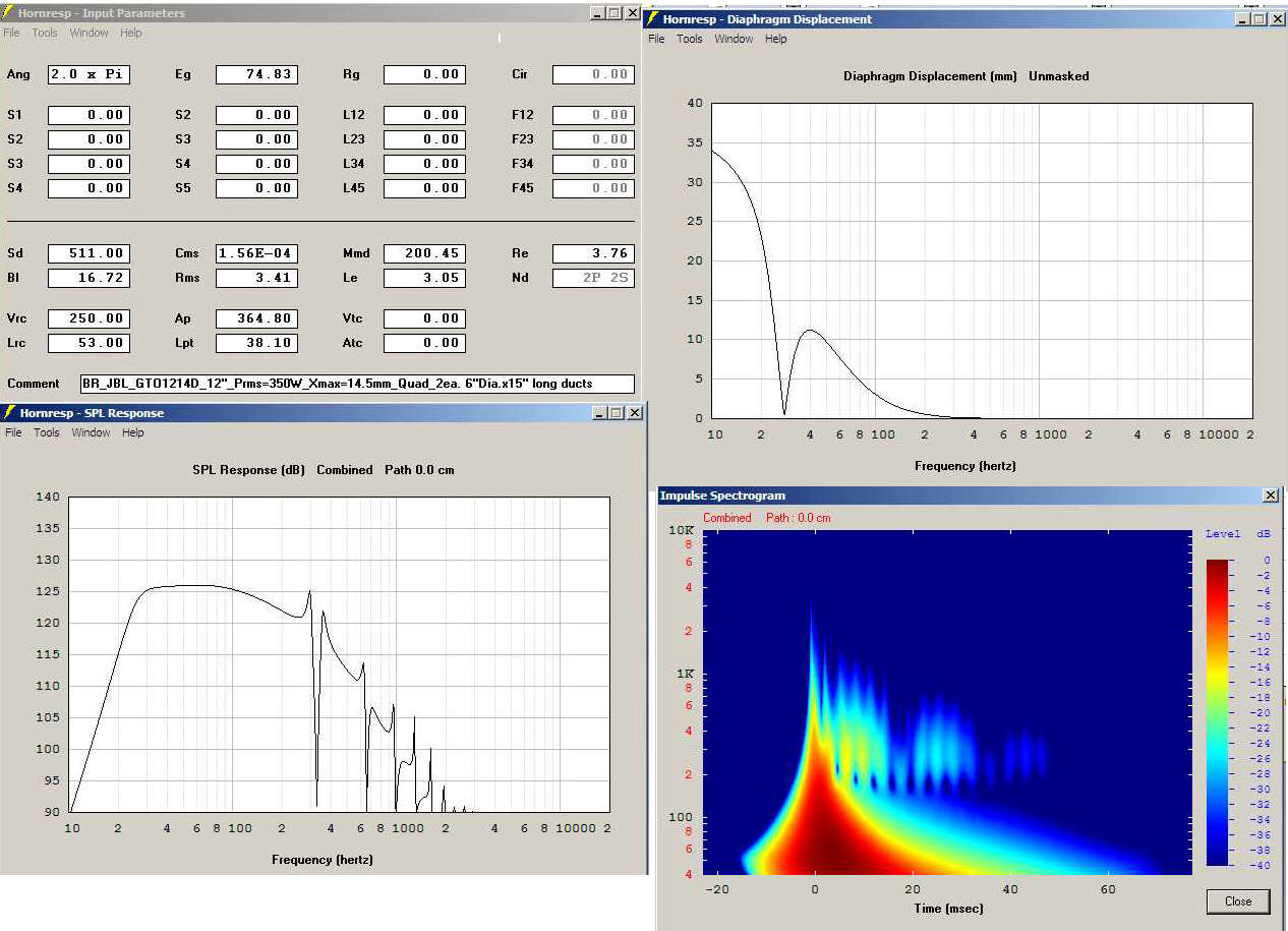

For a loud - and nice sounding - party box put 4ea. JBL GTO1214D into a bass reflex box: V_net=250 L - 2 ducts 6"Dia. x 15" long. The drivers are about $100.-- ea. on ebay (free shipping), MDF would be fine for box material, throw in a few 1x1s for bracing and corners, some miscellaneous stuff and you should have about $150.-- left over for beer and hot dogs. 🙂
The SPL and excursion are @ 1400W, and you are still below Xmax in the passband. You might want to check the numbers.

If I may; don't stare blind on 'looks'. Too deceiving.
I like the look of large drivers too, but in the end, it's to reproduce sound and let you feel the bass.
For your goal, I really-really like the quad design from Oliver! The shape can be altered as Brian suggested. ... VERY nice by simplicity!

Oh don't get me wrong. I love brians design. I do! He should seriously make a standalone thread on it. The problem is it's so damn large at 9cubes. I wanted something more compact to be able to lug it to the porch and to the neighbors as needed.
The 18" setup would go for $480 vs Brian's at $630. (assuming I can power Brian's with an EP2000) The 18" would be in a 5cube box with another stacked on top someday.
I don't know I'll have to think about it.... it would be pretty sick. I wonder what the difference in output would end up at ha.

You'll have to do a litte work and simulate the GTO1514 v. GTO1214, but it looks to me as if the 4 12" take about the same size box as 2 15", and have a higher overall performance. The 12" have been used quite successfully in this thread: http://www.diyaudio.com/forums/subwoofers/160879-build-your-own-2x12-th-kraken-212-th.html A bigger enclosure than what you're looking for, but interesting anyhow.
