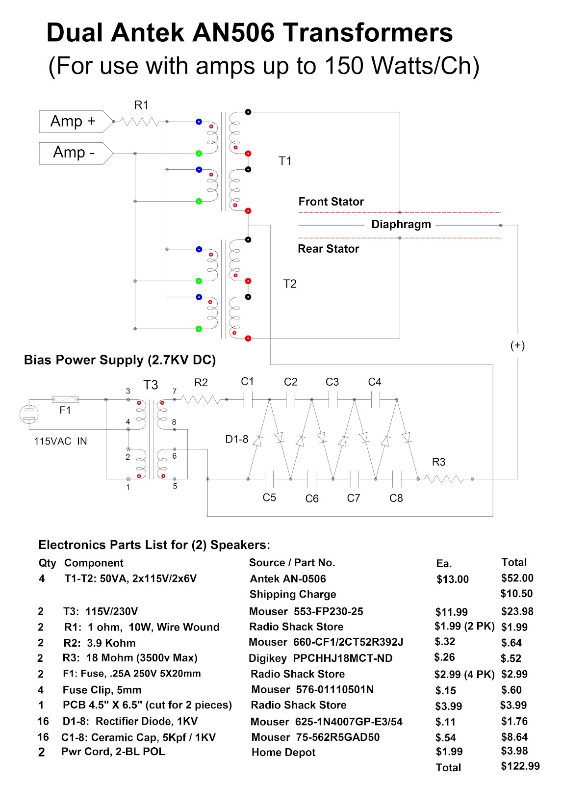

If there CLS there should be a big black box on the back at the bottem...if there sqeakel there sould be a black box right behind the panels at the top of the base box....if there newer like the SL3s there inside the base box....goodluck

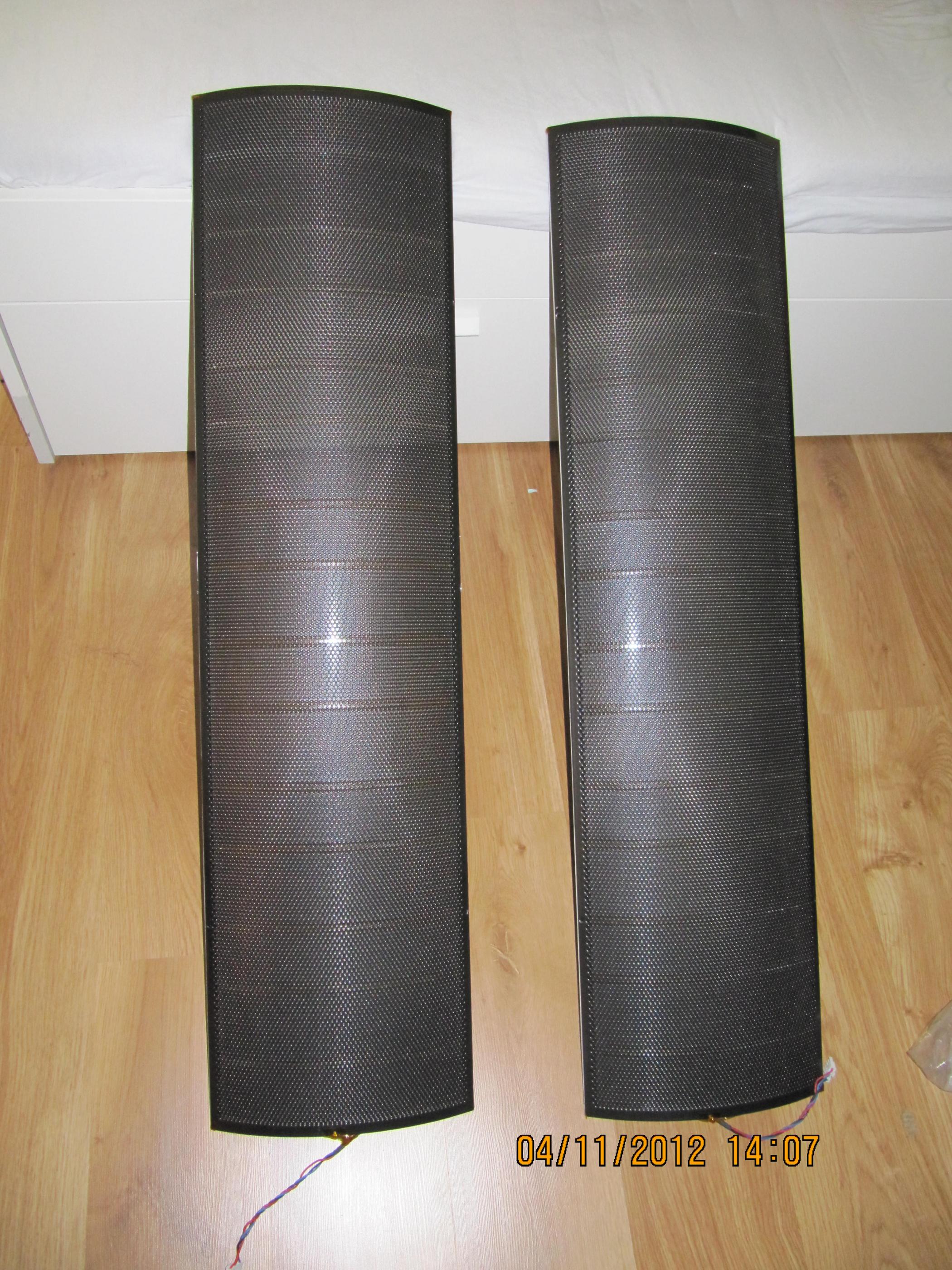

There is 1 of the power supply boards for these cells on sale on Canuck audio mart, but you also need a second one, and the audio step up transformers, and the woofers, and the crossovers, and the cabinets ---- looks like a lot of work to me.........
Maybe you'd be better off selling them to some one who has them already and needs new cells..
