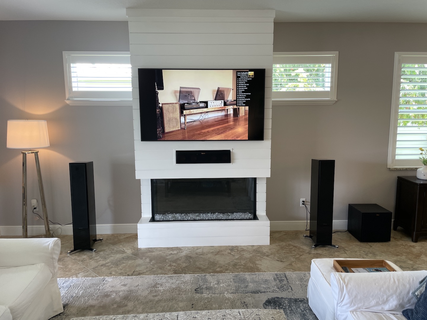

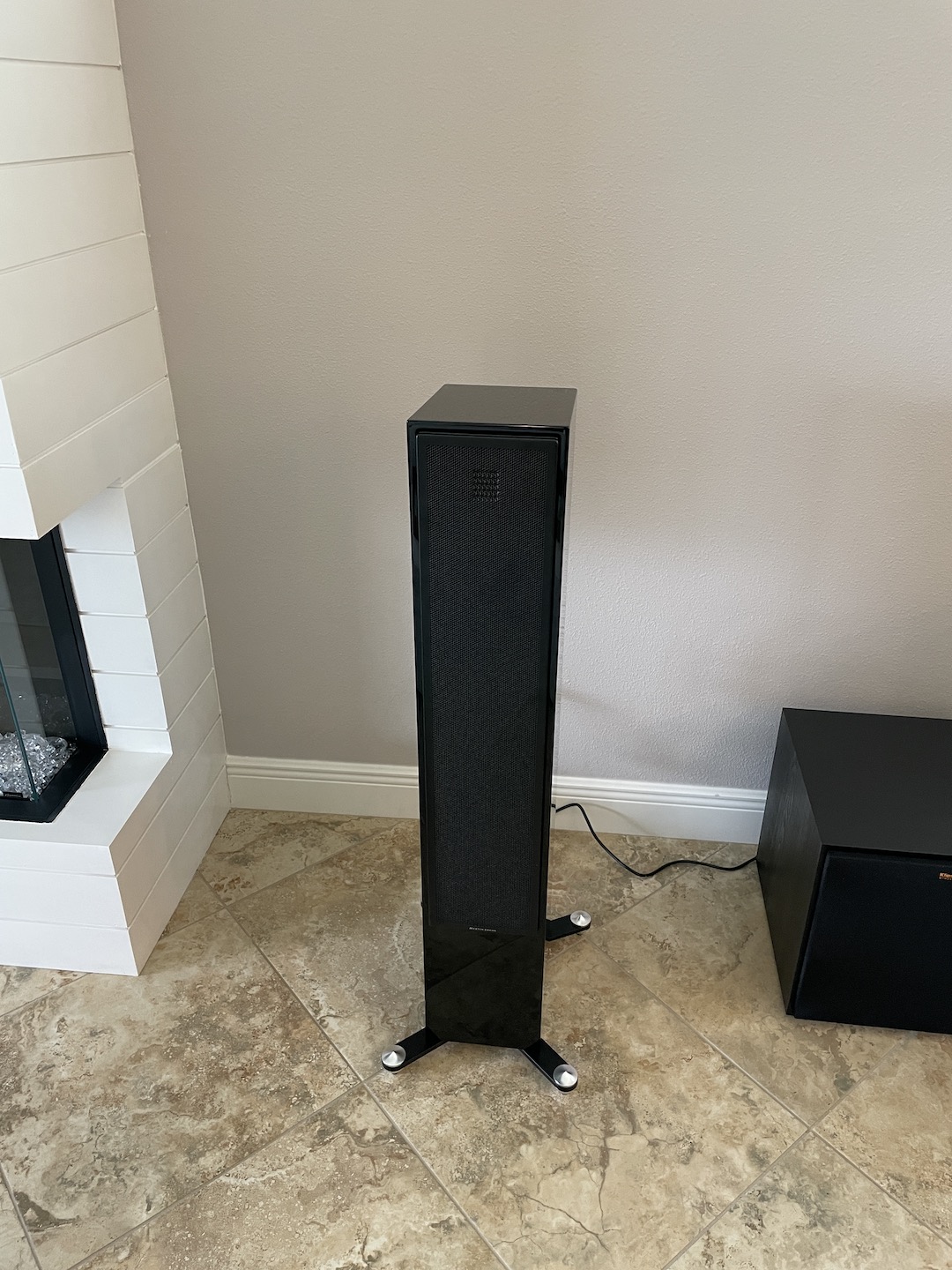

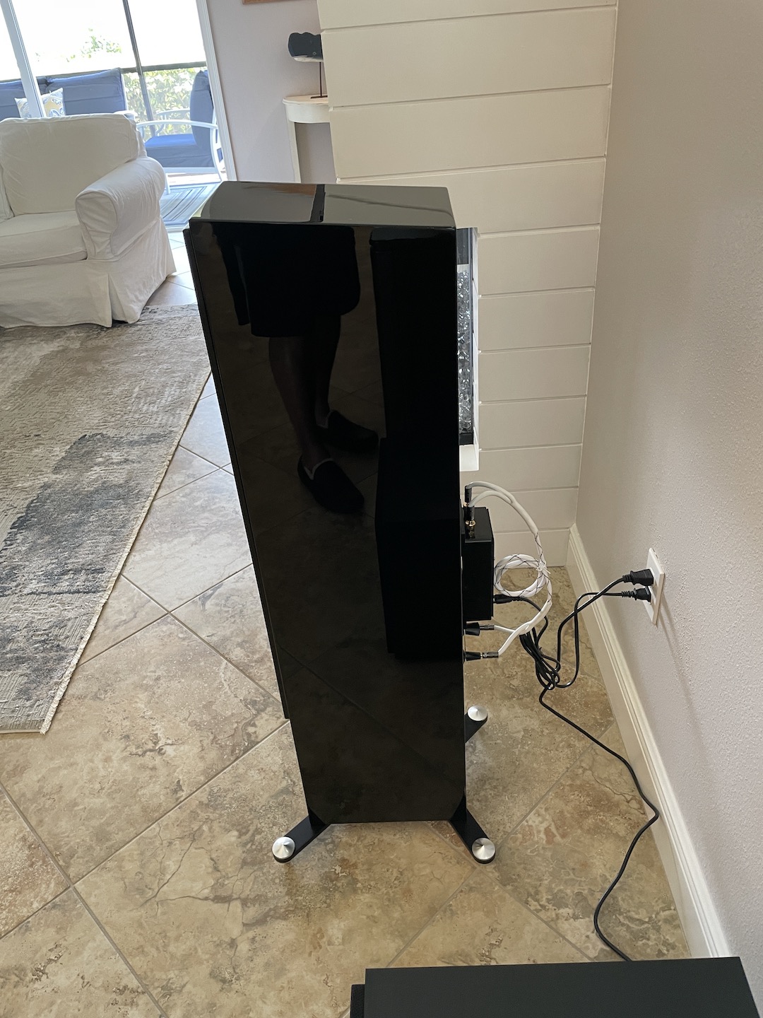

I see the market for such a product for people that live in apartments or where they just don't want the hassle and expense of permanently wiring their home or their spouse doesn't like having a bunch of wires all over the place. I am attaching a few photos of my prototype setup. I welcome thoughts and feedback. After I have finalized my prototypes I plan to do a kickstarter type launch and see if the market will support production versions.
