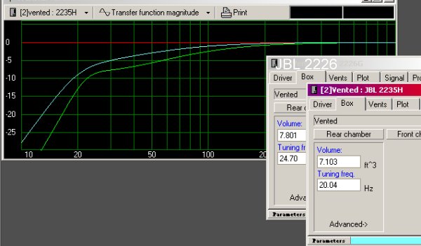

Your JBL models well against the 2226G used in the almighty subwoofer project here.
http://member.newsguy.com/~stigerik/almighty/index.html
Maybe you could try lowering the tuning freqency and building a slightly larger box.
As Bill said, 2 would be even better.
Rob

Hi Rob
Do you think making the box bigger and lowering the tuning frequency will give me better performance? JBL reccomends a 5 cubic ft, box with 30hz, tuning, maybe this is good for full range use and not sub use?
fs on the driver is 20 hertz, should I be tuning towards fs instead?

Yes I do. JBL recommened enclosure is probably for PA use - doesn't factor in room gain. Lowering the tuning, and increasing the box size a bit will give you an EBS type roll off - should give you good extention, hopefully only 5 or 6dB down at 20Hz. Do a search for mike.e 's 2226 EBS on this forum to give you an idea.
A search on EBS and room gain should give you lots of info so you can make your own mind up.
Rob
