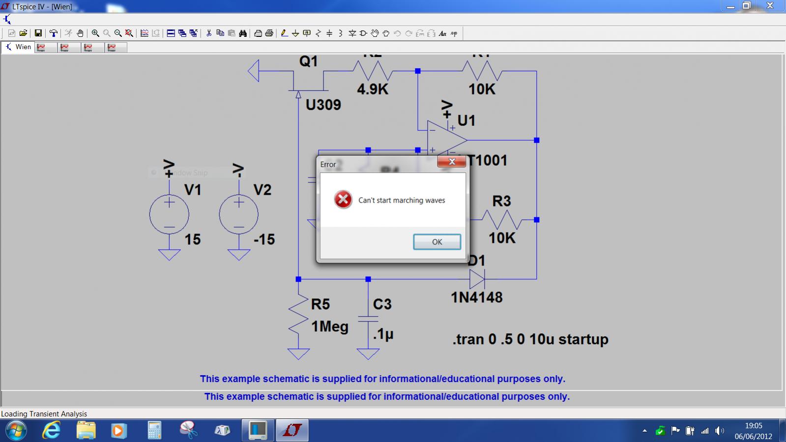

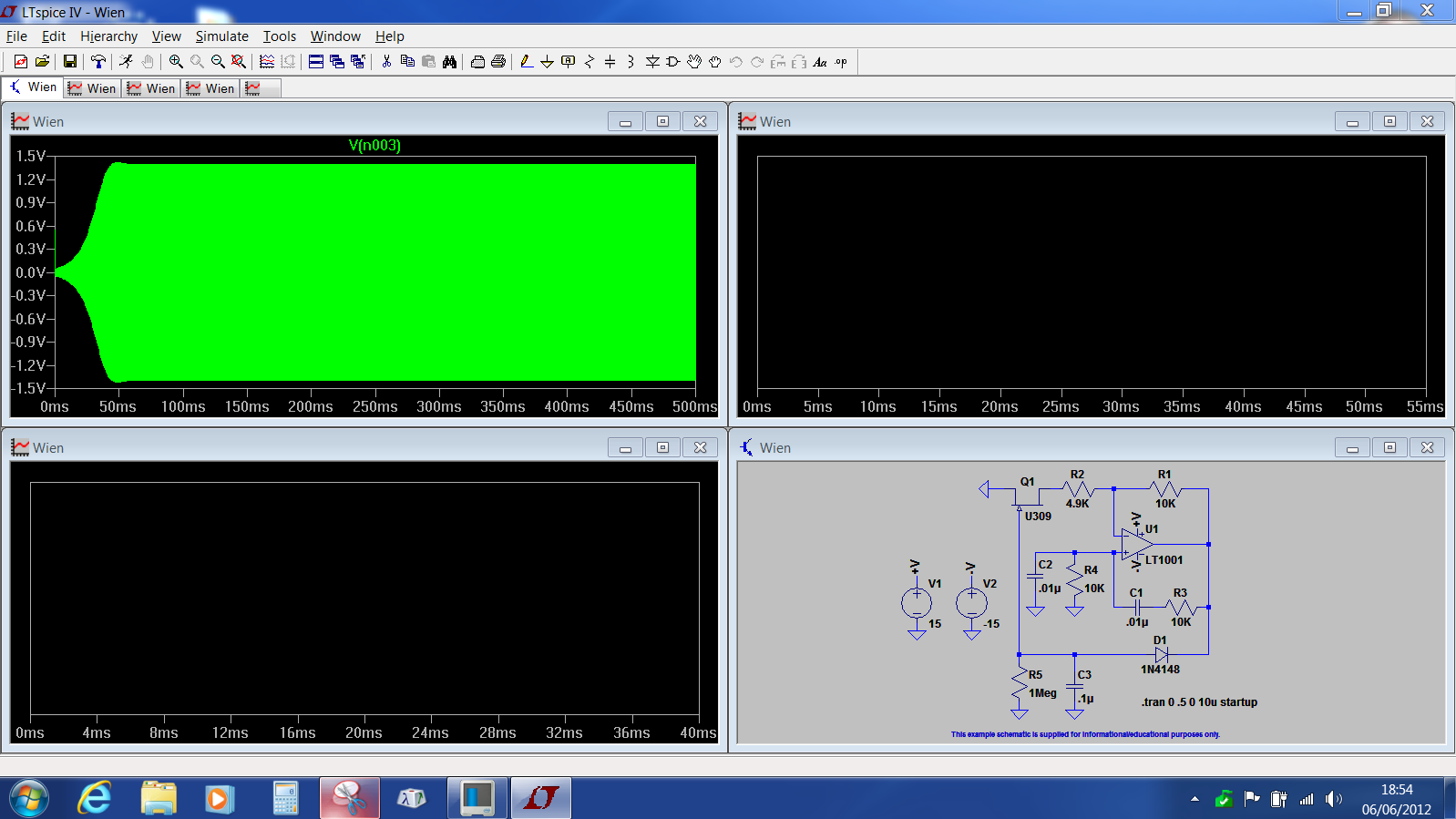

It just does not run correctly on the Dell and I don't really know where to start looking. Turning off "marching waves" does enable it to run OK but I shouldn't have to do that and certainly not on each run.
The identical OS on the Acer (from the same W7 disc) and LT spice is fine. I don't understand where the differences will be as no "hardware" or drivers are involved.

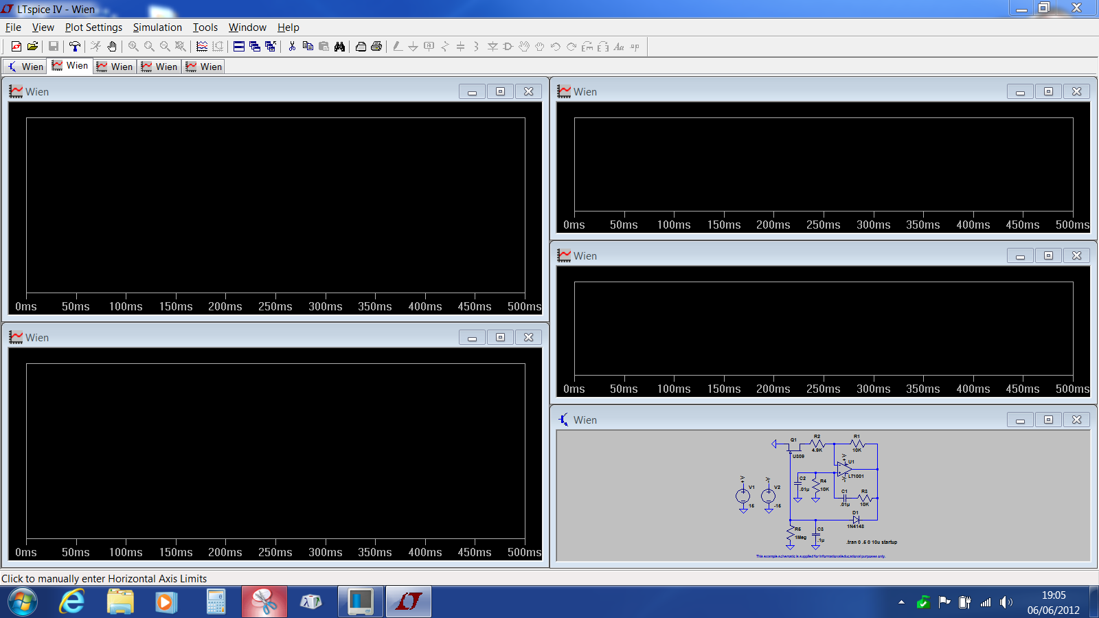

Have a new PC running W7 Professional x64 and I can't get LTspice to run properly.
The screen shots show what is happening. I have tried installing a couple of times (both on clean W7 images) with the same result.
I am only opening the LTspice examples in the default installation and it all seems to go wrong.
The PC is a new Dell Vostro laptop. What is odd is that I can take the W7 recovery disc (which is a Microsoft W7 SP1 disc) and install it on an old laptop and LTspice runs great under W7 on there.
I have turned user account control off before installing and to run it, all with no difference.

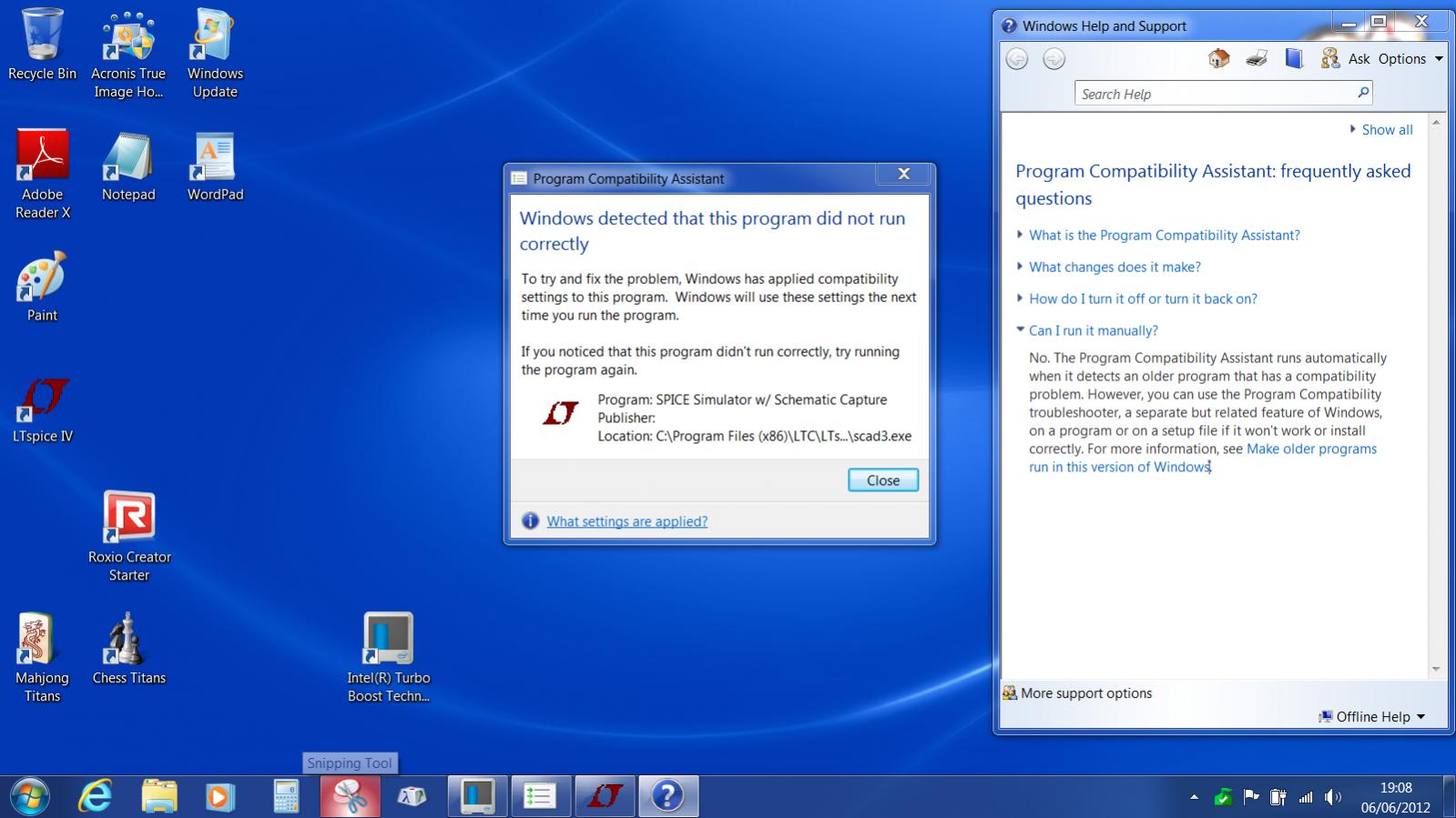

The windows message that appeared happened LTspice "stopped responding" but the new settings whatever they are made no difference.
I did google the error messages and although there is info about them nothing seems to apply here.
I have no idea where to even begin on this so if anyone has any ideas 🙂

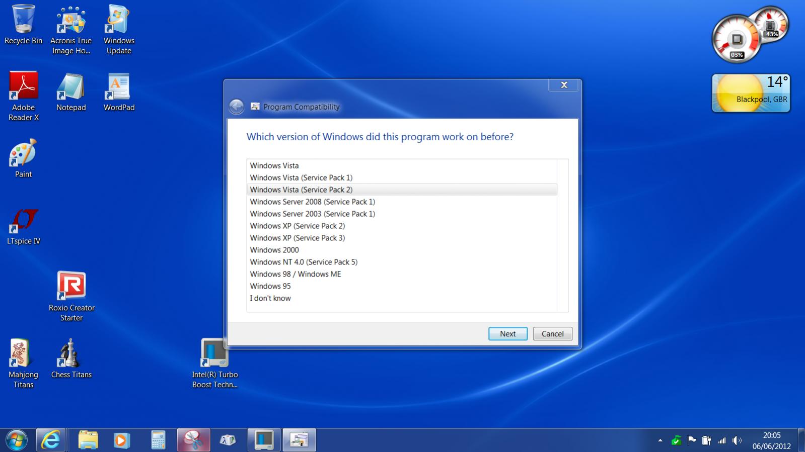

have you try to change the compability of scad3.exe? not the shortcut icon on your desktop.
go to "C:\Program Files (x86)\LTC\LTs...\scad3.exe"
and try to uninstall your current ltspice and install again in other drive (non-system drive), like D:\ or E:\ or F:\

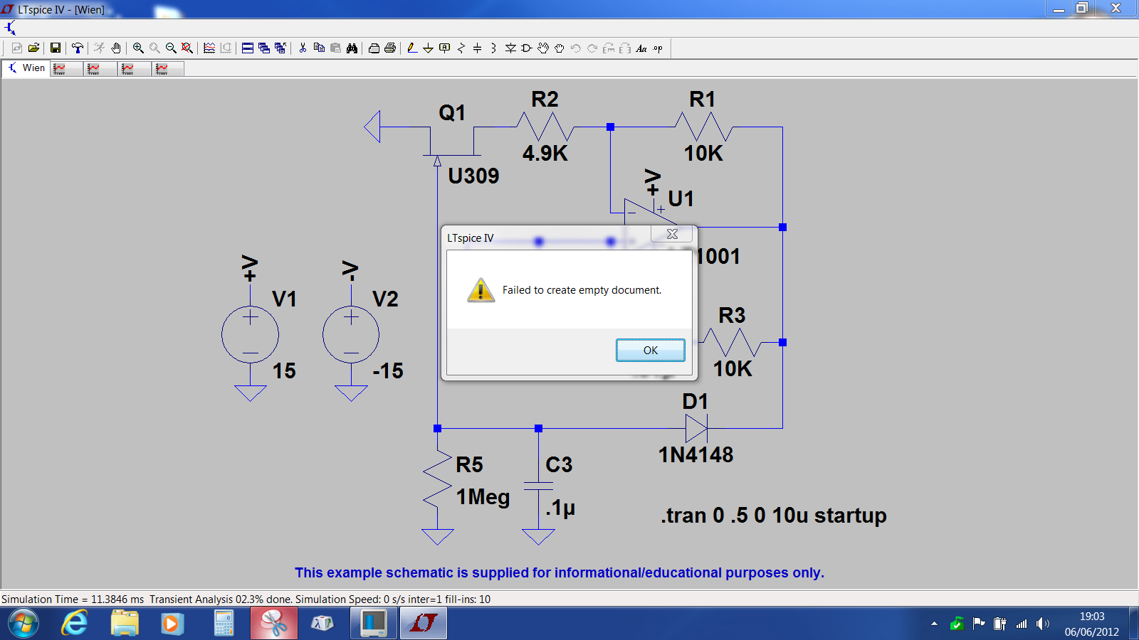

The error message (in the first post) says it all, the application is trying to write to the 'Program Files'-folder. This is not allowed by the operating system (to many bad people writing malicious programs in the world). My fix gives you (and you alone) the power to write to this one specific folder (and this folder alone).
If there are more people using this computer (and they use different logon's) then you need to repeat the procedure for the other users.
It is time LT fixed this (it is not very difficult, the operating system creates the roaming folders, just use them).
