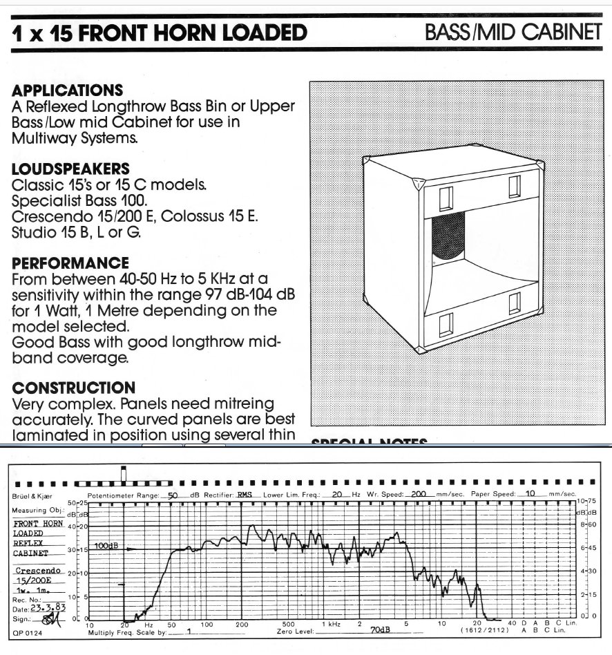

I need a scaled down T18. A, T12 or T15 tuned for bass guitar, that is 50 or 60 hz. I'm not technical but I know what sounds good. Bass cabs have a wider freq. response than a sub but the T18 is much to large for gigging bass players. The Cubo boxes look a lot like a scaled down T18 but don't have same the same throat as a T18 so they are not going to project mid range like a T18. Help.
A 50hz horn will be very large. Maybe look at the old school horns that have a vented back chamber to get a smaller horn with a bit of bass. I don't think many 50hz horns will get up to 3.5k without assistance.
Rob.
Edit: something like these out of the Fane loudspeaker book.

at first thought you meant a Fitzmaurice "T18" dunno if Karlson have what you want but do have virtue. Acoustic Control's 115BK scaled 1.2X for an 18" would be 32"T x23"W x 16" external with tuning in the low 40s.
18" which extend high might be hard to find - EV's old 18B went high on axis
little box fudge sim - vent should probably be shortened at least 15%
What would the throat area be like in a cabinet tuned for 50hz on up to say 3500hz?

Academic since it requires a driver with an effective Qts' = 2*50/3500 = 0.0286. 🙁
Based on St = Sd to closest frame size: [50*3500]^0.5 = ~418.33 Hz = ~13543/pi/~418.33 Hz = ~10.31" eff. dia./~83.4"^2 = 12" frame.
From above, the lower Qts' is the more horn loaded BW, so find the driver to 'find'/design the horn or at least an acceptable trade-off such as Rob's vintage suggestion with a 12" mounting adapter and DSP to 'taste'. 😉
