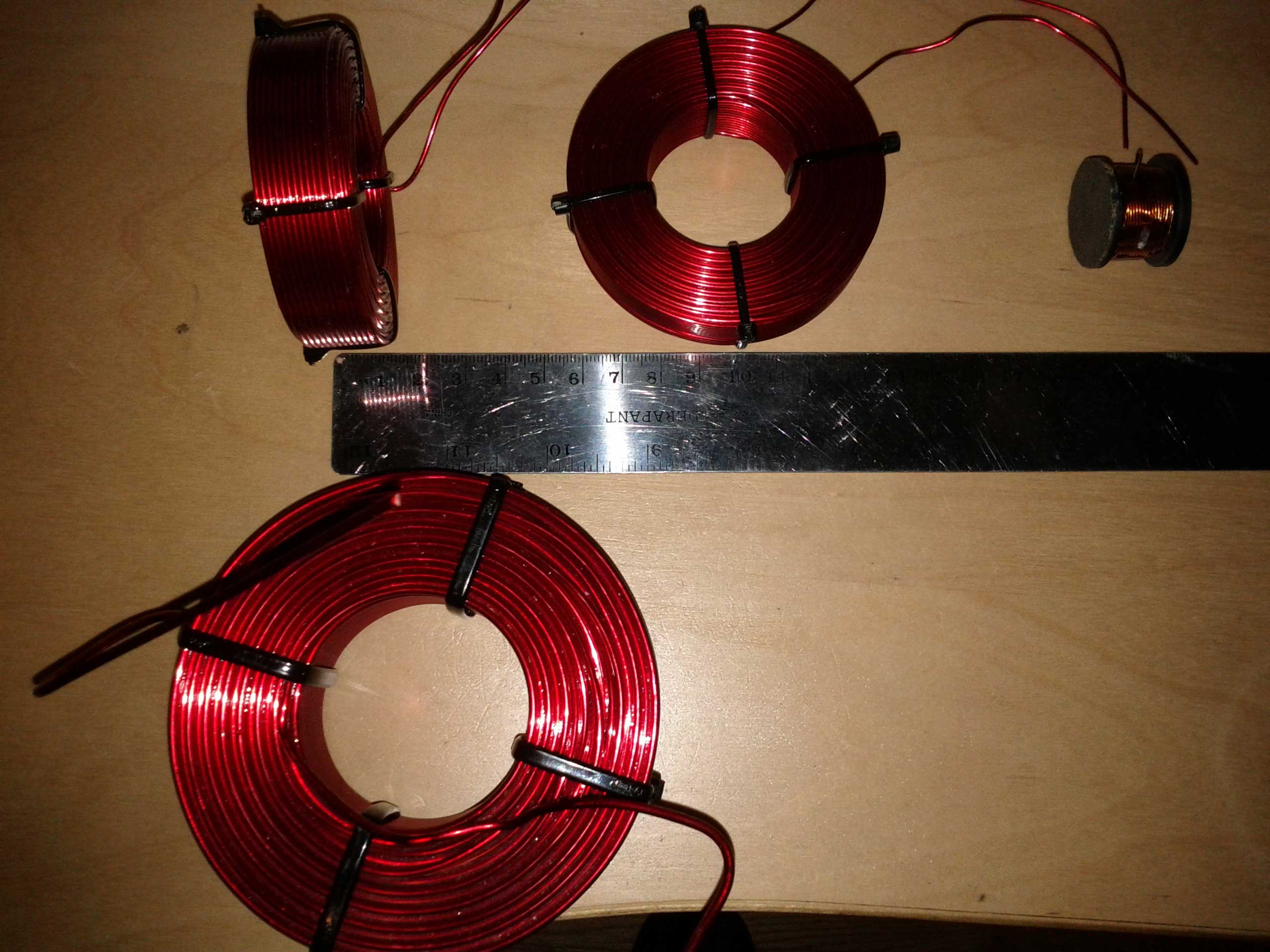

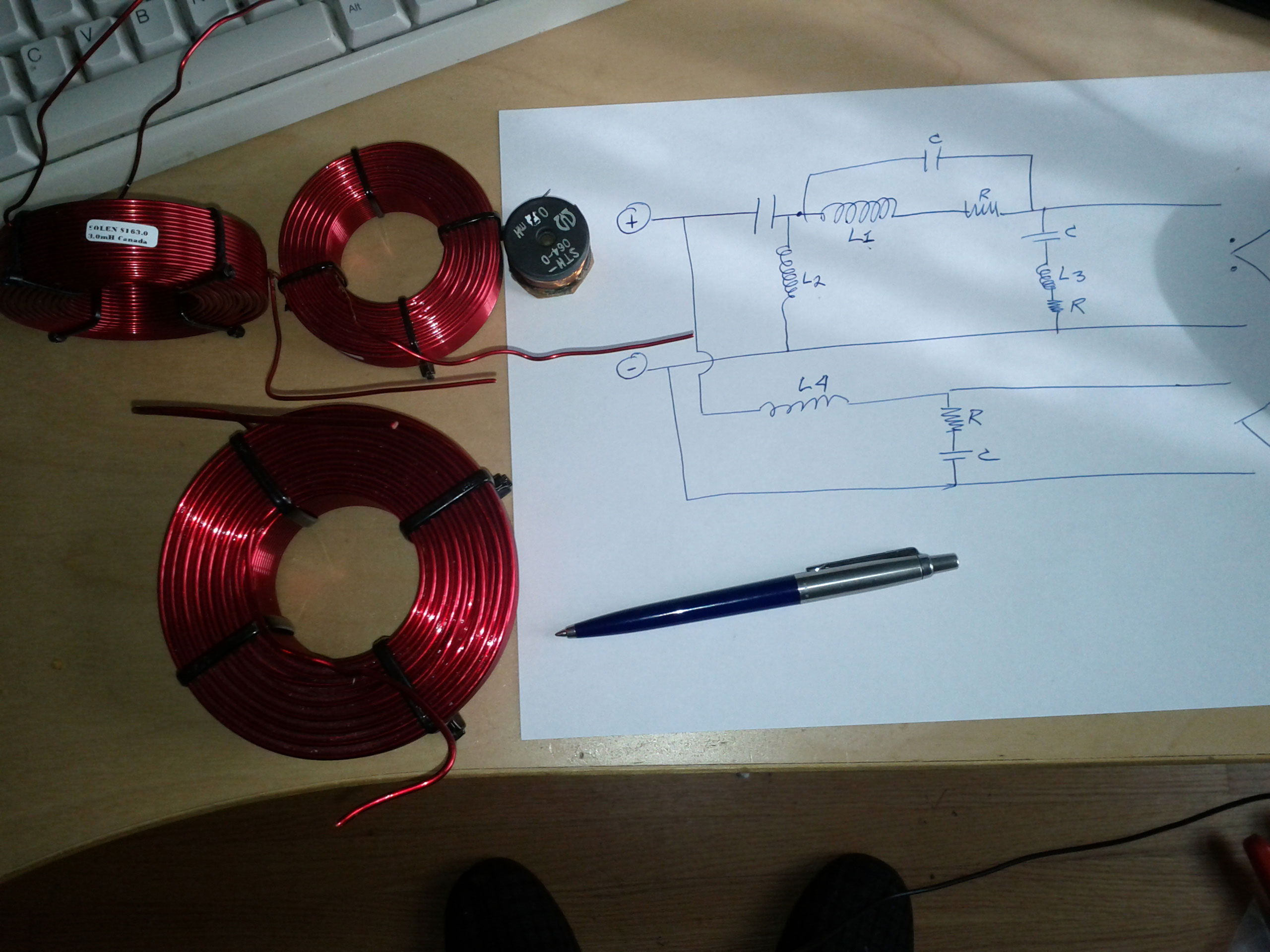

I am building a new set of crossovers. I have all the parts but I am unsure of two things and anyone's help would be appreciated.
Question 1. How do I lay out the inductors to minimize interference. I have attached the circuit diagram and what the inductors look like. Can some be stacked?
Question 2 . How does one pyhsically attach the circular inductors to a circuit board? Can you glue them on with a glue gun? May not be strong enough for any mounted on edge..
Thanks for any and all help. Regards

Coils have a magnetic field. Neighbouring coils will be affected by this magnetic field. To minimize that they should be mounted at 90 deg. to each other. Obviously, if it is a 5 Watt speaker, the coils could be a lot closer to each other than in a 100W unit.
To hold the coils in place I would use ty-raps until I am happy with the performance and after that, use contact cement liberally to prevent rattling (the Xover beeing in the box). You are screwed though, should you want to make some changes later on... E

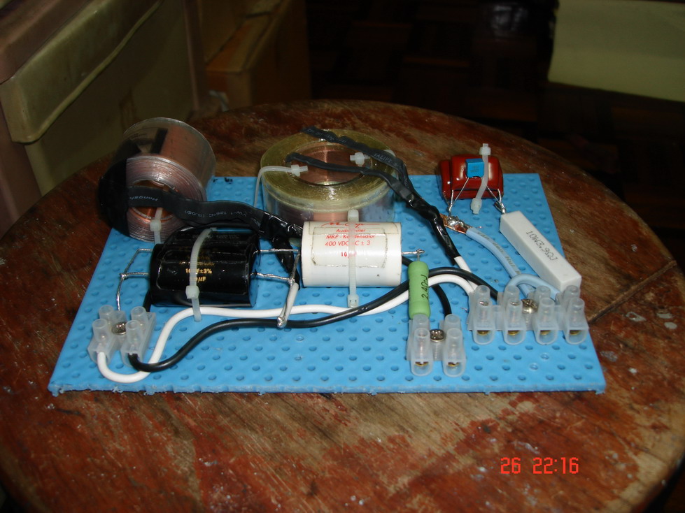

Agree with mickeymoose about the 90 deg. to each other mounting - and the further away from each other the better. If you use perf board or drill a couple of holes of suitable size you can use plastic tie wraps to secure them to the board along with some silicon to provide a bit of mechanical dampening.

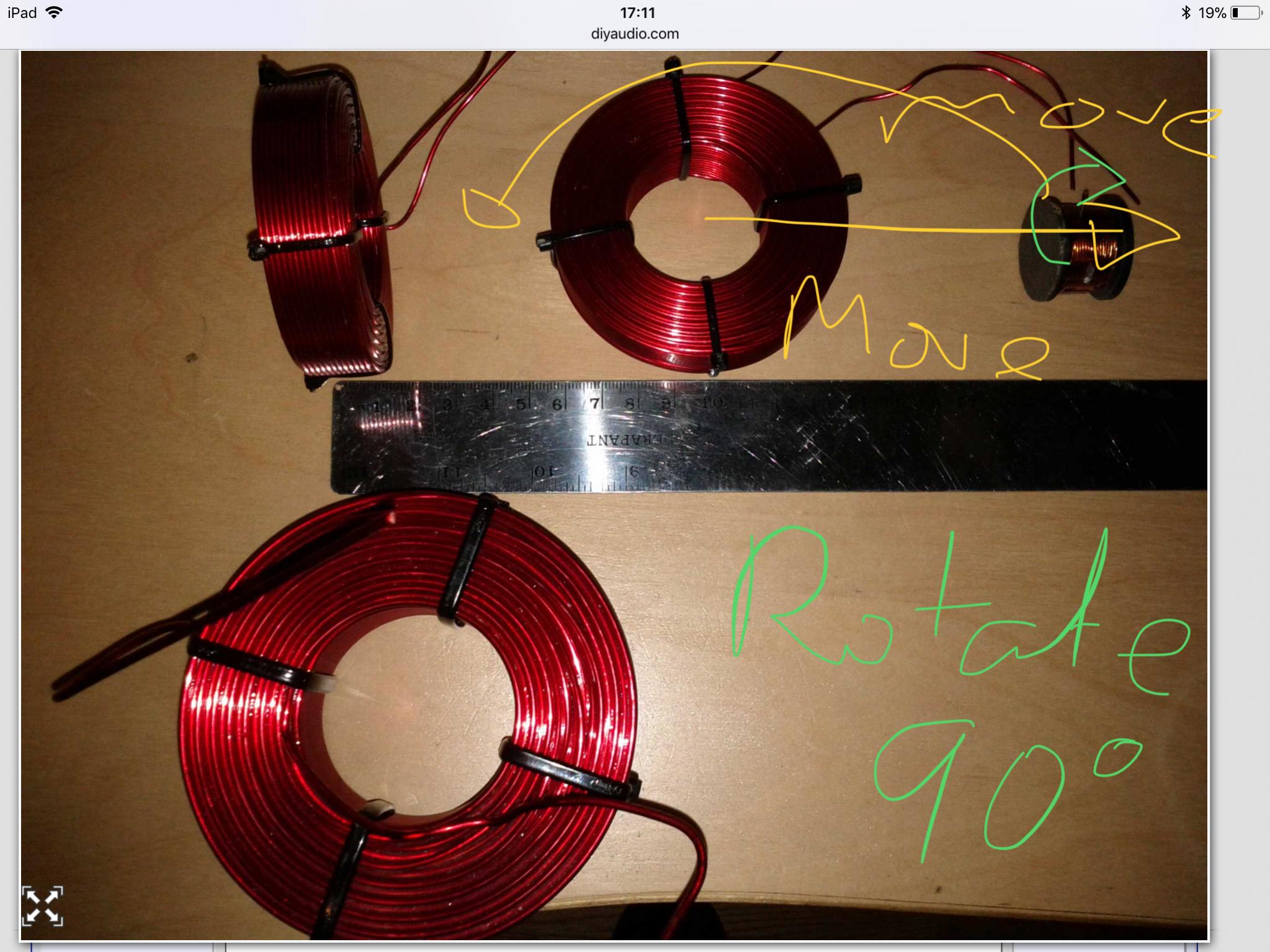

I think this would perform slightly better it makes the small coil at 90 deg to the vertical air core and move the air core that is in the same orientation as the large coil further away.
