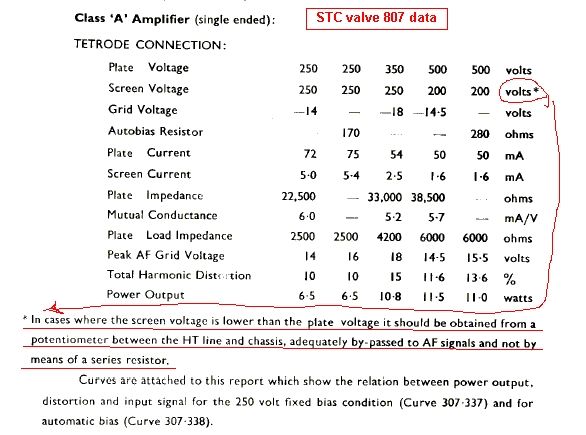

> 807 STC data and not understand
Rich notes a common problem in pentode use (more so in tetrodes; pentodes mostly eliminate it), but that's not what STC is trying to say here.
A conventional pentode has a large and pretty constant screen grid (G2) current. For a conventional pentode with 50mA plate current, we'd expect 5mA or 10mA screen current.
The 807/6L6 has aligned grids, putting G2 in the shadows of the G1 wires. This gives much lower G2 current. Ideally nearly zero! BUT with the main G2 current hidden, the "small" effects of grid alignment and secondary emission pull in opposite ways. So when plate current is 50mA, screen current is about 1.6mA, very low for a 50mA plate current. But small variations in tube and signal can give more or less current. I know in 6L6, the G2 current can even flow backward when secondary emission is high.
If you take the 1.6mA value literally, without knowing that it is very variable, you might try to get your 200V screen supply from the 500V plate supply. (500V-200V)/1.6mA= 187K G2 resistor. BUT if G2 current wanted to go to 2mA, then G2 voltage would sag bad, to 125V, and peak plate current would be too low for full power. Or if G2 current fell to 0.5mA (as it can), then G2 voltage soars to 400V, which may be more than 807 G2 rating and will urge too much plate current.
So on 807/6L6, when G2 voltage is less than plate voltage, and you want to get G2 voltage from plate voltage, you can't just use a dropping resistor. Use a 2-resistor voltage divider. Ideally this will flow at least 10 times the nominal G2 current. 16mA for this case of 1.6mA G2 current. That's another 8 watts of heat. If you have other stages that can eat 200V, you can use them as part of the voltage divider. These days you can use a big MOSFET, though you need a bleeder resistor to handle at least a couple mA of reverse G2 current. Or use a 140V AC winding to make some solid 200VDC. (A neat trick is to find a condition where G2 voltage is half of plate voltage, and use a voltage-doubler to generate both supplies on one winding.)

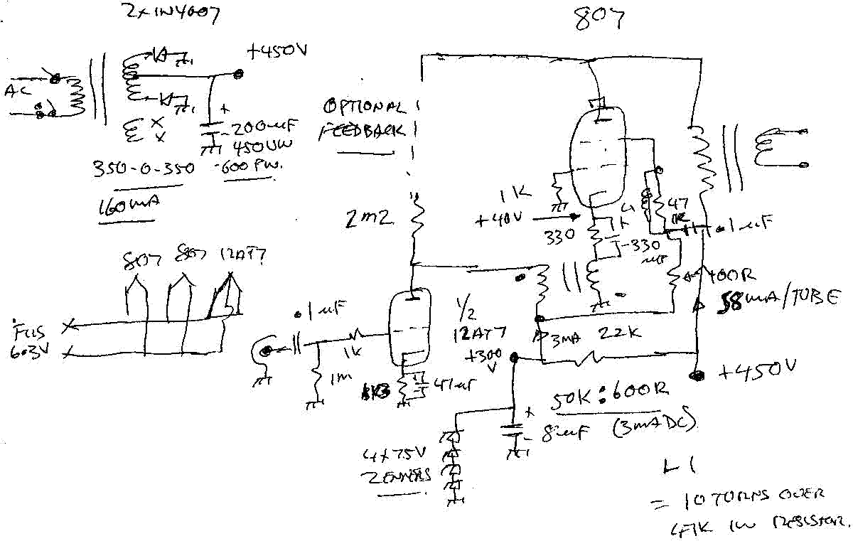

That is the worst hand cad I have ever seen.
I agree......presentation.......a stately tube amp deserves better treatment.
rich

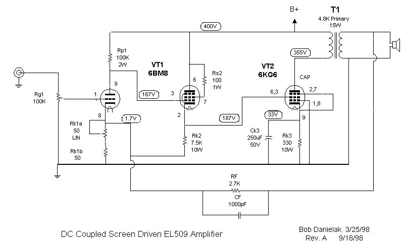

Bad presentation
I know that it is very bad sketch but my intention was to ilustrate Alex's comments on different ways of driving 807:as grounded grid like this and in enhanced mode ,screen drive.The first is more complicated because you need very low Z for driving the cathode (thus trafo is oblligatorilly or a CF) and the screen drive is more appopriate.Some people claim that once you hear GG 807 you'll forget all the other ways of driving it.
Druze Kiticu where are you?What would you say about this circuit!
It is using the same lamps,pedestrian if you want, as your's RH amp and employing partial feedbeck as an option.I must admit to you that you gained my symphaties just from the beggining with your fresh ideas and enthousiasm and because you named all your fruits RH!!!!You got me temptated with RH 34 so I am going to abandone for a while my 2a3 project and get my hands on RH 34 project.But all this after the old new year,or if you put in an another way,how do you call it a serbian New Year ,wasn't that?

I will check the screen driven schematics since it does interest me directly. When it comes to your interesting schematics -- I must say it is very hard "to read" since it is poor quality graphics... don't you have some schematics drawing software at hand?
Aleksandre,
I am sorry for the bad drawing of the sch. but I simply took it off my part of the HD and put it in may mail.I think I know where it comes from.ASAP will check it out if there is another better sketch of it.
I use public PC so unfortunatelly don't have software for drawing schematics.And of course I am a customs inspector not an expert in this area!
