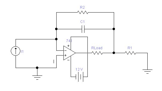

Dear Fellows, I was wondering if anyone out there could help me with this problem. I'm currently a student but am not a electrial major so do bear with me for a while. he problem go as such.
We're to design a discrete component feedback with the following characteristics.
Single low input impedance ( <1 ohm) , Single high output impedance (> 1Mohm).
Output to supply a max instantaneous currect between +2A & -2A in any load resistance btw 0 to 10 ohms using +24, 0, -24 volt supply. Load is to be connected between out of amp and a 0.47 ohm resistor whose other end is connected to ground
Transfer function is -500/(1+s/10^5)
So far this is what has been found out, To get low input impedance and high output impedance current-sample current-sum is used. Also it is a low pass filter. So can anyone share some light on it or does anyone knows how from a transfer function you get the discrete componete???

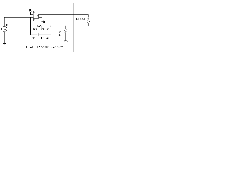

Hi Edo
What you basically have to do is taking an inverting amplifier with high gain and implement current-feedback.
I attached a P-SPICE schematic. As ampifier I took (because I was a little lazy) a voltage controlled voltage source.
The final circuit's upper f3 is at 1/(2*Pi / 10^5) = 159.155 kHz.
In order to run stable into resistive loads, the amplifier's open loop f3 must be significantly higher than this.
Also inductive loads will be detrimental to stability (while capacitive loads might increase it).
If the gain of the amplifier is high enough it will try to keep the voltage at the input node at zero (as long as you don't run into saturation).
The value of the feedback resistor is then determined by
R2 = R1 * (Currentgain -1)
The capacitor C1 is determined by
C1 = 1/(2 * Pi * f3 * R2)

HI phase_accurate,
Your diagram is the same as mine but however the transfer function which i need to get it AF(s) = -500/(1+s/10^5). In that case can i still use the same formula you gave??? I do not know what the s is in that eqn, thus i do not know how to get rid of it.
Therefore could you explain to me if you can, how from the transfer function could we get the R and the C??
Sorry about that phase_accurate,i'm abit slow with these stuff.
I think i figure out you were tryign to tell me. Af(s)=-500/(1+s/10^5) therefore the current gain is 500 right. This should be closed loop gain right. Then using the formula you gave i Got R2 and my C. but i do not know how did you manage to get the frequency and do you have any idea what the 10^5 is and the s???
Hi Edo
s = j * 2 * Pi * frequency
The function you want to built is called PT1 in control terminology (at least in the German speaking area). It is basically an amplifier with first order lowpass characteristic.
For DC it's gain is 500 (in this case gain = Iout/Iin). It's upper corner (i.e. -3dB) frequency is determined by
f3=1/(2*Pi*R*C)=1/(2*P1/10^5)
Another way to write down the transfer function is:
H=A0 * 1/(1+s*T) = -500 * 1/(1+s*1/10^5) with T=R*C

Hi Edo
Basically you can take an inverting VOLTAGE amplifier with high gain using this current-feedback topology to generate a current controlled current source. The higher the gain, the higher the output resistance (and also the faster it runs into saturation without apropriate load connected to it).
A low input impedance (theoretically 0.00 Ohms) is intrinsic to the above circuit topology. An inverting amlifier (unless overdriven) will always try to maintain O Volts at it's input and therefore have zero input impedance (whithout input series resistor of course).

The input Z is set by the feedback. As you say the input Z of a reasonable op-amp is very high.
I reckon, for R1>>R2, the input Z at the inverting input is:
Zin = R2 / [ 1 + R1.A/(R1+Rload) ]
Note that A is very frequency-dependent. Do a quick calc to convince yourself that the input Z is <1 ohm across the specified frequency range.
