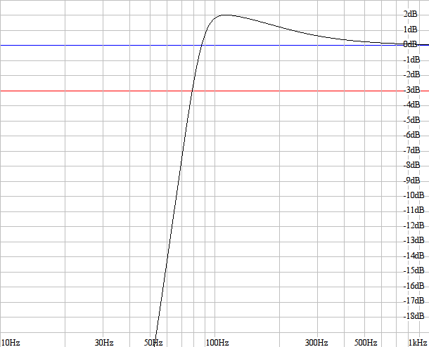

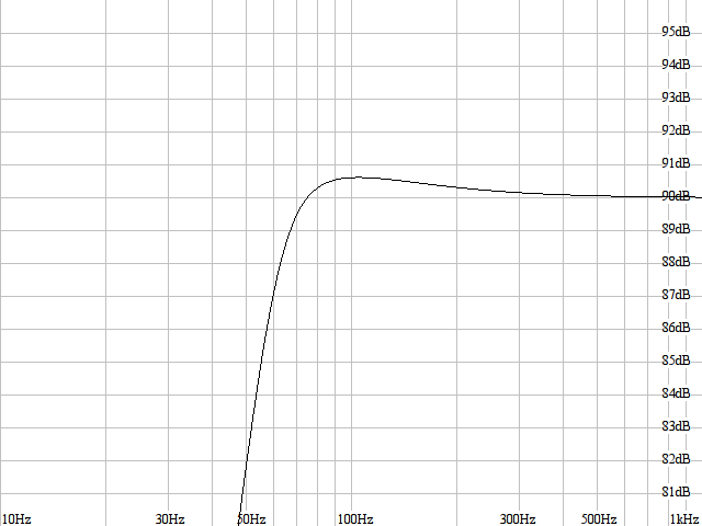

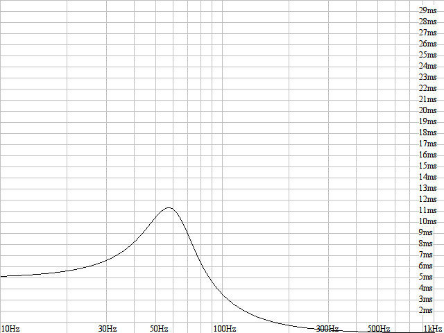

I'm in the process, procrastination stage having bought all the parts, of building a pair of desktop BRs with the MA CHN-70.
You'll want an enclosure with an internal volume of 7.6l, tuned to 65Hz. This gives an F3 of 60Hz.
See attached 🙂 .

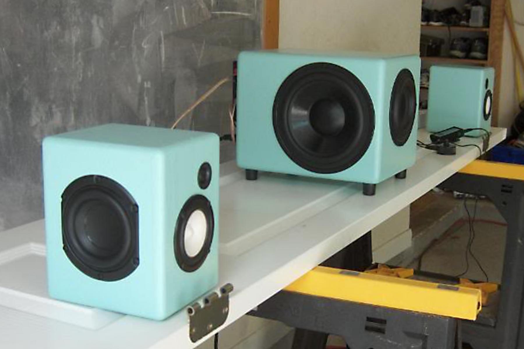

I saw 2 designs by Wolf. One is a variation of the Rubyk and the other is a variation on the PC.
Other's Projects I've Built - Techtalk Speaker Building, Audio, Video Discussion Forum
Wolf's PC, Sprite, and Voxel Subwoofer 2.1's in Walnut - Techtalk Speaker Building, Audio, Video Discussion Forum
I love the PC in walnut but can’t find the dimensions. The original was a 4 inch cube if I understand correctly. I’m still thinking about something like this for my office at work (and my very first build).
