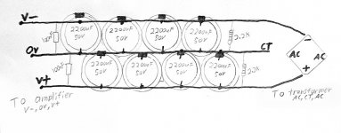

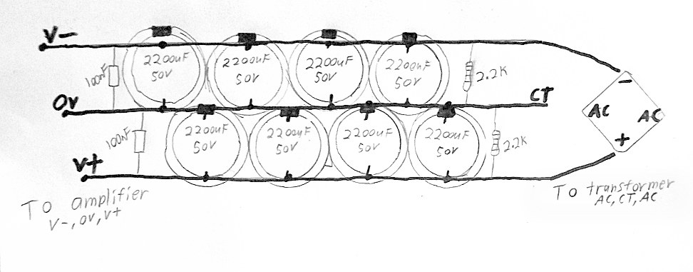

For reference, here is the power supply that has been running my TDA7294 for years.
Not mentioned in the drawing is that those 100nF at the output of the power supply board are cheap lossy polyester dip caps (mylar bubble cap) that are internally an RC (automatic snubber) because of their high ESR.
However, the 100nF's on the amplifier board's power circuit are high efficiency ceramic or polypropylene (low ESR).
My apologies for the simplistic appearance, but I would have replaced it if something outperformed it. 😀
For reference, the 8800uF per each rail figure is about bare minimum size to support bass, so you may prefer to expand it to 5x 2200uF caps (11,000uF) per rail and get a bit better bass. This power supply is similar to a considerable number of discrete amps in the solid state forum. The capacitors are tightly nested together for noise reduction purpose.

Possibly, the 1000uF in the datasheet are signal grade caps. Possibly, the main customer of TDA7294 uses 330uF caps and so ST cannot release that information on the datasheet. Probably, its both reasons.
You can really easily test it for yourself. 🙂
P.S.
220uF//2200uF at the amplifier board isn't horrifying. However, my own just worked better (clearer) when all of the big caps were at the power supply board, not the amplifier board.
P.P.S.
The power circuit that I tried to describe is like the majority of discrete amplifiers in the solid state forum. Have a look. 🙂
hey this is drawingh has all the information one needs, and its not shabby at all so relax, i m going to do the same for my amp, i had initially kept 3 per rail 4700uf/50 volts,
but now i will drop it to 2200 and keep 5 per rail, got lots of samwah SD series 2200 /50 v at my work place, also will go to market to see if i get nicichon or some other at 105degs low esr,

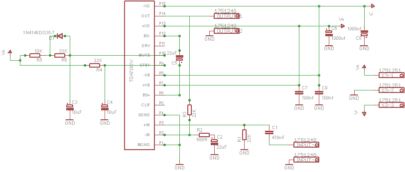

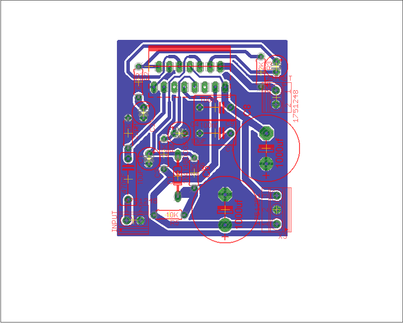

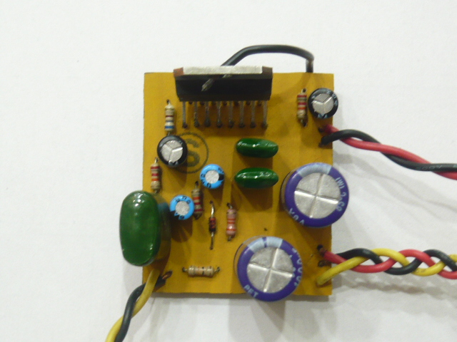

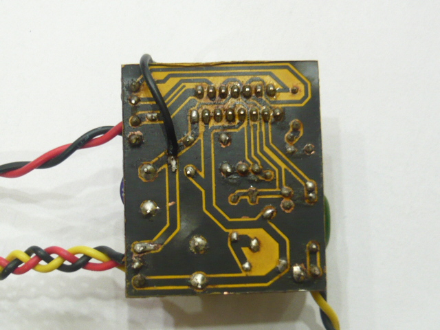

hello
i have also made a amplifier using TDA7293
here is my pcb layout and the circuit
